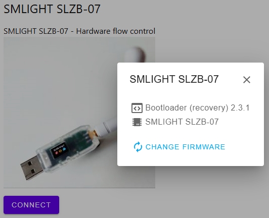

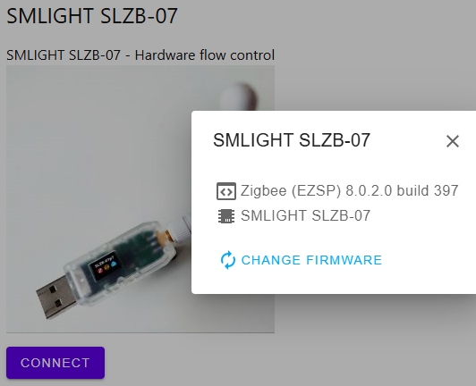

J’ai un dongle SMLIGHT SLZB-07 mis à jour (voir log ci-dessous)

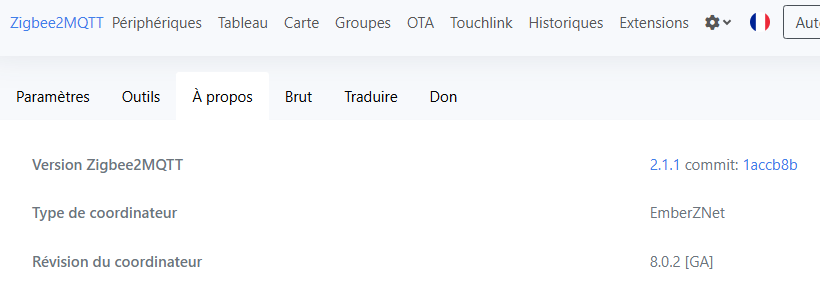

Le Plugin JeeZigbee est en version 2025-01-15 01:01:47

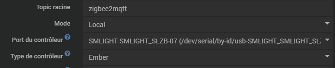

La version actuelle de Zigbee2MQTT est 2.1.1 mais j’ai le même pb en 1.42.0
Type de contrôleur est Ember mais c’est pareil en EZSP

Mise à jour du firmware
[2025-02-22 22:16:24][ALERT] : sudo chmod +x /var/www/html/plugins/z2m/core/class/../../resources/misc/update-firmware-elelabs.sh;sudo /var/www/html/plugins/z2m/core/class/../../resources/misc/update-firmware-elelabs.sh /dev/serial/by-id/usb-SMLIGHT_SMLIGHT_SLZB-07_6634d2c2aa77ed118a3beefafdf7b791-if00-port0 zigbee
kill: (9): No such process
Begin update of /dev/serial/by-id/usb-SMLIGHT_SMLIGHT_SLZB-07_6634d2c2aa77ed118a3beefafdf7b791-if00-port0 with firmware zigbee
--2025-02-22 22:16:24--  https://github.com/Elelabs/elelabs-zigbee-ezsp-utility/archive/master.zip
Resolving github.com (github.com)... 140.82.121.3
Connecting to github.com (github.com)|140.82.121.3|:443... connected.
HTTP request sent, awaiting response... 302 Found
Location: https://codeload.github.com/Elelabs/elelabs-zigbee-ezsp-utility/zip/refs/heads/master [following]
--2025-02-22 22:16:25--  https://codeload.github.com/Elelabs/elelabs-zigbee-ezsp-utility/zip/refs/heads/master
Resolving codeload.github.com (codeload.github.com)... 140.82.121.9
Connecting to codeload.github.com (codeload.github.com)|140.82.121.9|:443... connected.
HTTP request sent, awaiting response... 200 OK
Length: unspecified [application/zip]
Saving to: '/tmp/elelabs.zip'
2025-02-22 22:16:25 (6.40 MB/s) - '/tmp/elelabs.zip' saved [1247988]
Archive:  elelabs.zip
7fc415497f7e2b3410e3350b359ac5c71043399e
   creating: elelabs-zigbee-ezsp-utility-master/
 extracting: elelabs-zigbee-ezsp-utility-master/.gitignore
  inflating: elelabs-zigbee-ezsp-utility-master/CHANGELOG.md
  inflating: elelabs-zigbee-ezsp-utility-master/Elelabs_EzspFwUtility.py
  inflating: elelabs-zigbee-ezsp-utility-master/LICENSE
  inflating: elelabs-zigbee-ezsp-utility-master/README.md
   creating: elelabs-zigbee-ezsp-utility-master/data/
   creating: elelabs-zigbee-ezsp-utility-master/data/EFR32MG13/
  inflating: elelabs-zigbee-ezsp-utility-master/data/EFR32MG13/ELE_MG13_ot_rcp_115200_120_211116.gbl
  inflating: elelabs-zigbee-ezsp-utility-master/data/EFR32MG13/ELE_MG13_ot_rcp_123_220206.gbl
  inflating: elelabs-zigbee-ezsp-utility-master/data/EFR32MG13/ELE_MG13_zb_ncp_115200_610_211112.gbl
  inflating: elelabs-zigbee-ezsp-utility-master/data/EFR32MG13/ELX0X3_MG13_6.0.3_ezsp_v6.gbl
  inflating: elelabs-zigbee-ezsp-utility-master/data/EFR32MG13/ELX0X3_MG13_6.7.0_ezsp_v8.gbl
   creating: elelabs-zigbee-ezsp-utility-master/data/EFR32MG21/
  inflating: elelabs-zigbee-ezsp-utility-master/data/EFR32MG21/ELU0141_MG21_ot_rcp_123_211204.gbl
  inflating: elelabs-zigbee-ezsp-utility-master/data/EFR32MG21/ELU0141_MG21_zb_ncp_6103_211204.gbl
  inflating: elelabs-zigbee-ezsp-utility-master/data/EFR32MG21/ELU0143_MG21_ot_rcp_123_211211.gbl
  inflating: elelabs-zigbee-ezsp-utility-master/data/EFR32MG21/ELU0143_MG21_zb_ncp_6103_211211.gbl
   creating: elelabs-zigbee-ezsp-utility-master/img/
  inflating: elelabs-zigbee-ezsp-utility-master/img/ele_update_thread.png
  inflating: elelabs-zigbee-ezsp-utility-master/img/ele_update_zigbee.png
  inflating: elelabs-zigbee-ezsp-utility-master/img/logo.jpg
  inflating: elelabs-zigbee-ezsp-utility-master/img/probe_btl.png
  inflating: elelabs-zigbee-ezsp-utility-master/img/probe_thread.png
  inflating: elelabs-zigbee-ezsp-utility-master/img/probe_zigbee.png
  inflating: elelabs-zigbee-ezsp-utility-master/img/restart_btl.png
  inflating: elelabs-zigbee-ezsp-utility-master/img/restart_nrml.png
 extracting: elelabs-zigbee-ezsp-utility-master/requirements.txt
Requirement already satisfied: setuptools in /usr/local/lib/python3.9/dist-packages (75.8.0)
WARNING: Running pip as the 'root' user can result in broken permissions and conflicting behaviour with the system package manager, possibly rendering your system unusable. It is recommended to use a virtual environment instead: https://pip.pypa.io/warnings/venv. Use the --root-user-action option if you know what you are doing and want to suppress this warning.
Requirement already satisfied: wheel in /usr/local/lib/python3.9/dist-packages (0.45.1)
Requirement already satisfied: pyserial==3.4 in /usr/local/lib/python3.9/dist-packages (from -r requirements.txt (line 1)) (3.4)
Requirement already satisfied: xmodem==0.4.6 in /usr/local/lib/python3.9/dist-packages (from -r requirements.txt (line 2)) (0.4.6)
2025/02/22 22:16:38 Elelabs_EzspFwUtility:   EZSP adapter in bootloader mode detected:
2025/02/22 22:16:38 Elelabs_EzspFwUtility:   Gecko Bootloader v2.03.01
2025/02/22 22:16:45 Elelabs_EzspFwUtility:   EZSP adapter in bootloader mode detected:
2025/02/22 22:16:45 Elelabs_EzspFwUtility:   Gecko Bootloader v2.03.01
2025/02/22 22:16:45 Elelabs_EzspFwUtility:   The product not in the normal EZSP mode.
'restart' into normal mode or use 'flash' utility instead
2025/02/22 22:16:51 Elelabs_EzspFwUtility:   EZSP adapter in bootloader mode detected:
2025/02/22 22:16:51 Elelabs_EzspFwUtility:   Gecko Bootloader v2.03.01
2025/02/22 22:16:51 Elelabs_EzspFwUtility:   Launch in normal application mode
2025/02/22 22:16:59 Elelabs_EzspFwUtility:   EZSP adapter in bootloader mode detected:
2025/02/22 22:16:59 Elelabs_EzspFwUtility:   Gecko Bootloader v2.03.01
2025/02/22 22:17:06 Elelabs_EzspFwUtility:   EZSP adapter in bootloader mode detected:
2025/02/22 22:17:06 Elelabs_EzspFwUtility:   Gecko Bootloader v2.03.01
End of update successfull
[2025-02-22 22:17:08][ALERT] : Fin de la mise à jour du firmware de la clef

Pour la mise à jour du firmware du SLZB-07 c’est peut-être plutôt ici qu’il conviendrait d’aller : Silabs Firmware Flasher | Web based flasher for ZB-GW04 and ZBDongle-E. MultiPAN RCP firmware enables these devices to be used with Silabs Multiprotocol Addon in Home Assistant. Allow Zigbee and Thread to co-exist on the same dongle. Get ahead of the tech an experiment with Matter!
akenad :slight_smile:
Merci @akenad pour cette réponse rapide et très tard :slight_smile:
Je suis passé de
Screen Shot 02-23-25 at 05.41 AM
à
Screen Shot 02-23-25 at 05.44 AM
et CA MARCHE (Version 8.0.2.0) :
MERCI !!!
HhgfGIF
darkxst n’étant pas inspirant…
J’avais utilisé le flasher de smlight, mais je n’avais jamais dépassé la version 7.4.1.0
Et la dernière installation (désespérée) sur le SLZB-07 était via Jeedom
(la V2.3.1 correspond au log Jeedom)
