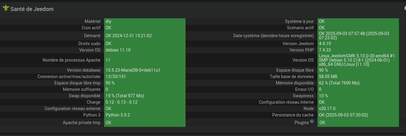

Voici les éléments demandés :
0000|[2025-09-03 08:00:40] INFO : 'Car DJo' L'équipement a été mis à jour
0001|[2025-09-03 08:00:40]WARNING : teslapi:withCh(GET https://fleet-api.prd.eu.vn.cloud.tesla.com/api/1/vehicles/XP7YGCEK8PB180428/vehicle_data?endpoints=charge_state%3Bclimate_state%3Bclosures_state%3Bdrive_state%3Bgui_settings%3Blocation_data%3Bvehicle_config%3Bvehicle_state%3Bvehicle_data_combo(Array ( [endpoints] => charge_state;climate_state;closures_state;drive_state;gui_settings;location_data;vehicle_config;vehicle_state;vehicle_data_combo ) )) --> 403, 0,
0002|[2025-09-03 08:00:40]WARNING : teslapi:withCh(GET https://fleet-api.prd.eu.vn.cloud.tesla.com/api/1/vehicles/XP7YGCEK8PB180428/vehicle_data?endpoints=charge_state%3Bclimate_state%3Bclosures_state%3Bdrive_state%3Bgui_settings%3Blocation_data%3Bvehicle_config%3Bvehicle_state%3Bvehicle_data_combo(Array ( [endpoints] => charge_state;climate_state;closures_state;drive_state;gui_settings;location_data;vehicle_config;vehicle_state;vehicle_data_combo ) )) --> Array ( [response] => [error] => Unauthorized missing scopes vehicle_location for vehicle data access [error_description] => [txid] => f2a7686a39663e108a0829eb42d8d995 )
0003|[2025-09-03 08:00:40]WARNING : [Car DJo] Error 403 - Access to this resource is not authorized, developers should check required scopes: 'Unauthorized missing scopes vehicle_location for vehicle data access'
0004|[2025-09-03 08:01:17] INFO : 'Car DJo' L'équipement a été mis à jour
0005|[2025-09-03 08:01:17]WARNING : teslapi:withCh(GET https://fleet-api.prd.eu.vn.cloud.tesla.com/api/1/vehicles/XP7YGCEK8PB180428/vehicle_data?endpoints=charge_state%3Bclimate_state%3Bclosures_state%3Bdrive_state%3Bgui_settings%3Blocation_data%3Bvehicle_config%3Bvehicle_state%3Bvehicle_data_combo(Array ( [endpoints] => charge_state;climate_state;closures_state;drive_state;gui_settings;location_data;vehicle_config;vehicle_state;vehicle_data_combo ) )) --> 403, 0,
0006|[2025-09-03 08:01:17]WARNING : teslapi:withCh(GET https://fleet-api.prd.eu.vn.cloud.tesla.com/api/1/vehicles/XP7YGCEK8PB180428/vehicle_data?endpoints=charge_state%3Bclimate_state%3Bclosures_state%3Bdrive_state%3Bgui_settings%3Blocation_data%3Bvehicle_config%3Bvehicle_state%3Bvehicle_data_combo(Array ( [endpoints] => charge_state;climate_state;closures_state;drive_state;gui_settings;location_data;vehicle_config;vehicle_state;vehicle_data_combo ) )) --> Array ( [response] => [error] => Unauthorized missing scopes vehicle_location for vehicle data access [error_description] => [txid] => eb729053f4e7b8532f113d09d36591cb )
0007|[2025-09-03 08:01:17]WARNING : [Car DJo] Error 403 - Access to this resource is not authorized, developers should check required scopes: 'Unauthorized missing scopes vehicle_location for vehicle data access'

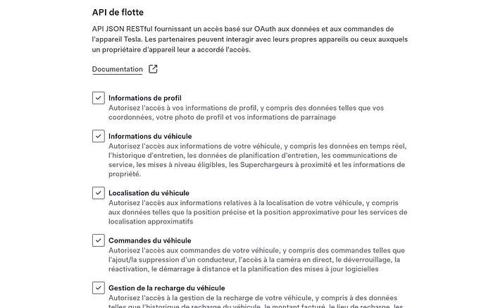

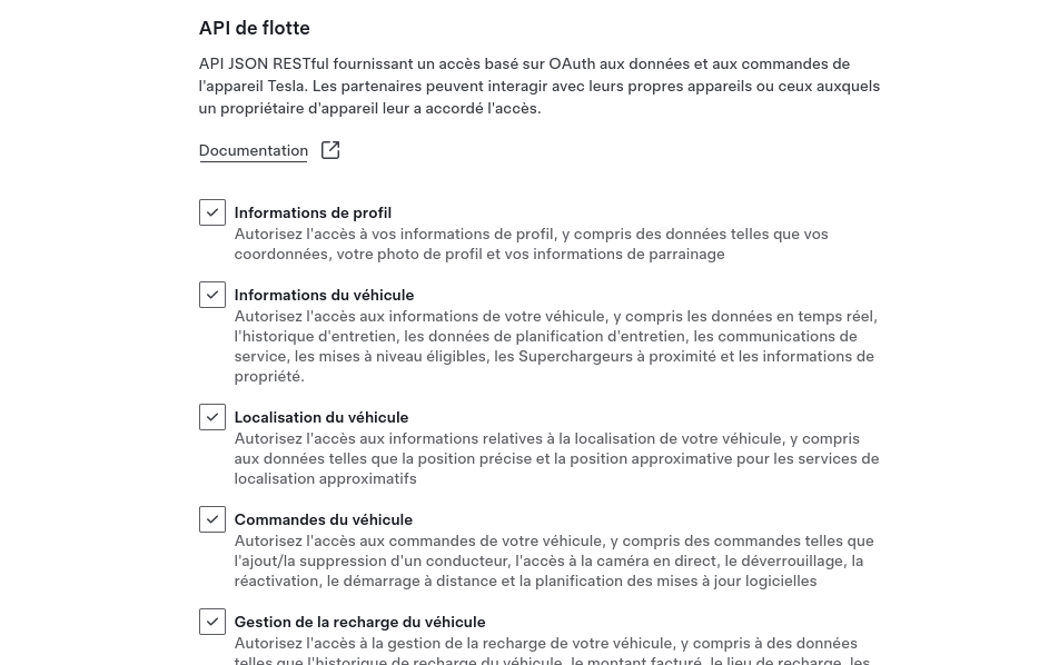

Je suis allé sur le compte « Developer de Tesla » mais où regarder exactement ?
DJo86
Septembre 3, 2025, 1:20
11
ça semble bon par rapport au lien que tu m"as donné plus haut

Après revérification de mes comptes comme écrit précédemment, la localisation n’était pas cochée sur le compte Tesla par rapport au compte déveloper. Je l’ai cochée hier soir et ce matin le serveur est bien lancé et j’avais chargé la batterie durant la nuit et c’est le bon pourcentage de batterie à l’affichage dans Jeedom ce matin…
Il y a donc bien un lien qui se faite entre les 2 comptes.

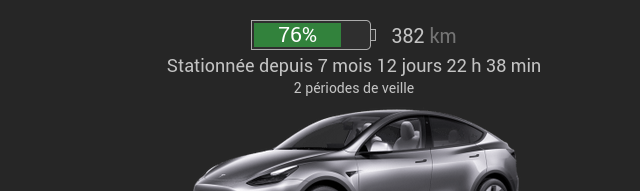

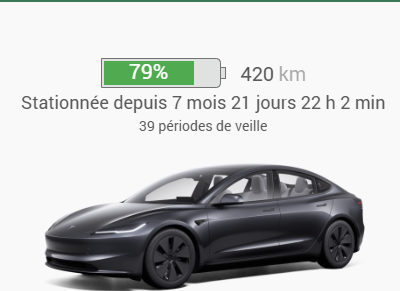

Par contre comme tu peux le voir sur la photo; j’ai roulé ce matin et la valeur du stationnement date de plus de 7 mois quand j’ai lancé un peu tomber le plugin.
Bizarre car le reste (changement d’ampérage, max charge, clim, etc…) fonctionne.

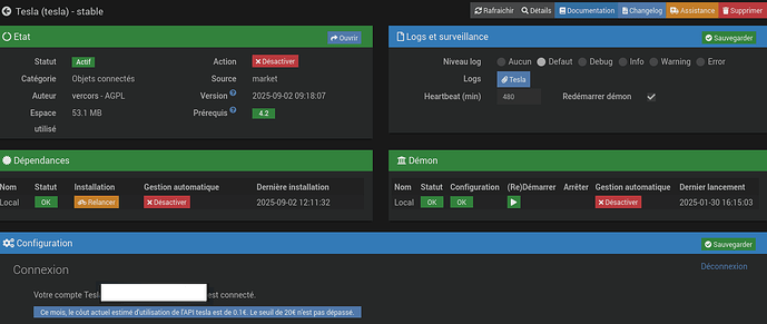

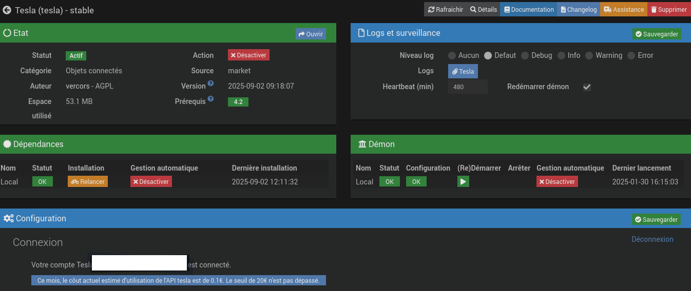

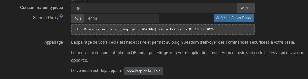

Le proxy est bien actif ?
DJo86
Septembre 5, 2025, 10:48
18
Bonjour Tonio,
Oui comme tu peux le voir :
[Stationnement]
J’ai également ce problème par contre tout le reste fonctionne …
