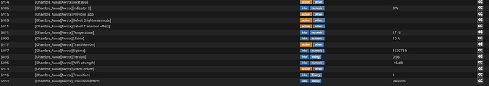

  2. Par contre c’est un peu le bazar dans mes on/off/etat :
Ce sont des topics différents (_mat / _ind1 / _ind2 / _ind3). Ils correspondent apparemment aux 3 indicateurs configurables (small dots sur les coins de l’affichage)
  1. Configuration de découverte plus complète j’ai l’impression :
{"sensor":{"6cc048_app":{"name":"Current app","uniq_id":"6cc048_app","ic":"mdi:apps","dev":{"ids":"10521c6cc048","name":"awtrix_anna","sw":"0.98","mf":"Blueforcer","mdl":"AWTRIX 3","cu":"http://192.168.1.101"},"avty_t":"awtrix_6cc048/10521c6cc048/avty_t","stat_t":"awtrix_6cc048/10521c6cc048/6cc048_app/stat_t"},"6cc048_id":{"name":"Device topic","uniq_id":"6cc048_id","ic":"mdi:id-card","dev":{"ids":"10521c6cc048","name":"awtrix_anna","sw":"0.98","mf":"Blueforcer","mdl":"AWTRIX 3","cu":"http://192.168.1.101"},"avty_t":"awtrix_6cc048/10521c6cc048/avty_t","stat_t":"awtrix_6cc048/10521c6cc048/6cc048_id/stat_t"},"6cc048_temp":{"name":"Temperature","uniq_id":"6cc048_temp","dev_cla":"temperature","ic":"mdi:thermometer","unit_of_meas":"°C","dev":{"ids":"10521c6cc048","name":"awtrix_anna","sw":"0.98","mf":"Blueforcer","mdl":"AWTRIX 3","cu":"http://192.168.1.101"},"avty_t":"awtrix_6cc048/10521c6cc048/avty_t","stat_t":"awtrix_6cc048/10521c6cc048/6cc048_temp/stat_t"},"6cc048_hum":{"name":"Humidity","uniq_id":"6cc048_hum","dev_cla":"humidity","ic":"mdi:water-percent","unit_of_meas":"%","dev":{"ids":"10521c6cc048","name":"awtrix_anna","sw":"0.98","mf":"Blueforcer","mdl":"AWTRIX 3","cu":"http://192.168.1.101"},"avty_t":"awtrix_6cc048/10521c6cc048/avty_t","stat_t":"awtrix_6cc048/10521c6cc048/6cc048_hum/stat_t"},"6cc048_bat":{"name":"Battery","uniq_id":"6cc048_bat","dev_cla":"battery","ic":"mdi:battery-90","unit_of_meas":"%","dev":{"ids":"10521c6cc048","name":"awtrix_anna","sw":"0.98","mf":"Blueforcer","mdl":"AWTRIX 3","cu":"http://192.168.1.101"},"avty_t":"awtrix_6cc048/10521c6cc048/avty_t","stat_t":"awtrix_6cc048/10521c6cc048/6cc048_bat/stat_t"},"6cc048_lux":{"name":"Illuminance","uniq_id":"6cc048_lux","dev_cla":"illuminance","ic":"mdi:sun-wireless","unit_of_meas":"lx","dev":{"ids":"10521c6cc048","name":"awtrix_anna","sw":"0.98","mf":"Blueforcer","mdl":"AWTRIX 3","cu":"http://192.168.1.101"},"avty_t":"awtrix_6cc048/10521c6cc048/avty_t","stat_t":"awtrix_6cc048/10521c6cc048/6cc048_lux/stat_t"},"6cc048_ver":{"name":"Version","uniq_id":"6cc048_ver","dev":{"ids":"10521c6cc048","name":"awtrix_anna","sw":"0.98","mf":"Blueforcer","mdl":"AWTRIX 3","cu":"http://192.168.1.101"},"avty_t":"awtrix_6cc048/10521c6cc048/avty_t","stat_t":"awtrix_6cc048/10521c6cc048/6cc048_ver/stat_t"},"6cc048_sig":{"name":"WiFi strength","uniq_id":"6cc048_sig","dev_cla":"signal_strength","unit_of_meas":"dB","dev":{"ids":"10521c6cc048","name":"awtrix_anna","sw":"0.98","mf":"Blueforcer","mdl":"AWTRIX 3","cu":"http://192.168.1.101"},"avty_t":"awtrix_6cc048/10521c6cc048/avty_t","stat_t":"awtrix_6cc048/10521c6cc048/6cc048_sig/stat_t"},"6cc048_up":{"name":"Uptime","uniq_id":"6cc048_up","dev_cla":"duration","unit_of_meas":"s","dev":{"ids":"10521c6cc048","name":"awtrix_anna","sw":"0.98","mf":"Blueforcer","mdl":"AWTRIX 3","cu":"http://192.168.1.101"},"avty_t":"awtrix_6cc048/10521c6cc048/avty_t","stat_t":"awtrix_6cc048/10521c6cc048/6cc048_up/stat_t"},"6cc048_ram":{"name":"Free ram","uniq_id":"6cc048_ram","dev_cla":"data_size","ic":"mdi:memory","unit_of_meas":"B","dev":{"ids":"10521c6cc048","name":"awtrix_anna","sw":"0.98","mf":"Blueforcer","mdl":"AWTRIX 3","cu":"http://192.168.1.101"},"avty_t":"awtrix_6cc048/10521c6cc048/avty_t","stat_t":"awtrix_6cc048/10521c6cc048/6cc048_ram/stat_t"},"6cc048_ip_address":{"name":"IP Address","uniq_id":"6cc048_ip_address","ic":"mdi:wifi","dev":{"ids":"10521c6cc048","name":"awtrix_anna","sw":"0.98","mf":"Blueforcer","mdl":"AWTRIX 3","cu":"http://192.168.1.101"},"avty_t":"awtrix_6cc048/10521c6cc048/avty_t","stat_t":"awtrix_6cc048/10521c6cc048/6cc048_ip_address/stat_t"}},"light":{"6cc048_mat":{"name":"Matrix","uniq_id":"6cc048_mat","ic":"mdi:clock-digital","bri_stat_t":"awtrix_6cc048/10521c6cc048/6cc048_mat/bri_stat_t","bri_cmd_t":"awtrix_6cc048/10521c6cc048/6cc048_mat/bri_cmd_t","rgb_cmd_t":"awtrix_6cc048/10521c6cc048/6cc048_mat/rgb_cmd_t","rgb_stat_t":"awtrix_6cc048/10521c6cc048/6cc048_mat/rgb_stat_t","dev":{"ids":"10521c6cc048","name":"awtrix_anna","sw":"0.98","mf":"Blueforcer","mdl":"AWTRIX 3","cu":"http://192.168.1.101"},"avty_t":"awtrix_6cc048/10521c6cc048/avty_t","stat_t":"awtrix_6cc048/10521c6cc048/6cc048_mat/stat_t","cmd_t":"awtrix_6cc048/10521c6cc048/6cc048_mat/cmd_t"},"6cc048_ind1":{"name":"Indicator 1","uniq_id":"6cc048_ind1","ic":"mdi:arrow-top-right-thick","rgb_cmd_t":"awtrix_6cc048/10521c6cc048/6cc048_ind1/rgb_cmd_t","rgb_stat_t":"awtrix_6cc048/10521c6cc048/6cc048_ind1/rgb_stat_t","dev":{"ids":"10521c6cc048","name":"awtrix_anna","sw":"0.98","mf":"Blueforcer","mdl":"AWTRIX 3","cu":"http://192.168.1.101"},"avty_t":"awtrix_6cc048/10521c6cc048/avty_t","stat_t":"awtrix_6cc048/10521c6cc048/6cc048_ind1/stat_t","cmd_t":"awtrix_6cc048/10521c6cc048/6cc048_ind1/cmd_t"},"6cc048_ind2":{"name":"Indicator 2","uniq_id":"6cc048_ind2","ic":"mdi:arrow-right-thick","rgb_cmd_t":"awtrix_6cc048/10521c6cc048/6cc048_ind2/rgb_cmd_t","rgb_stat_t":"awtrix_6cc048/10521c6cc048/6cc048_ind2/rgb_stat_t","dev":{"ids":"10521c6cc048","name":"awtrix_anna","sw":"0.98","mf":"Blueforcer","mdl":"AWTRIX 3","cu":"http://192.168.1.101"},"avty_t":"awtrix_6cc048/10521c6cc048/avty_t","stat_t":"awtrix_6cc048/10521c6cc048/6cc048_ind2/stat_t","cmd_t":"awtrix_6cc048/10521c6cc048/6cc048_ind2/cmd_t"},"6cc048_ind3":{"name":"Indicator 3","uniq_id":"6cc048_ind3","ic":"mdi:arrow-bottom-right-thick","rgb_cmd_t":"awtrix_6cc048/10521c6cc048/6cc048_ind3/rgb_cmd_t","rgb_stat_t":"awtrix_6cc048/10521c6cc048/6cc048_ind3/rgb_stat_t","dev":{"ids":"10521c6cc048","name":"awtrix_anna","sw":"0.98","mf":"Blueforcer","mdl":"AWTRIX 3","cu":"http://192.168.1.101"},"avty_t":"awtrix_6cc048/10521c6cc048/avty_t","stat_t":"awtrix_6cc048/10521c6cc048/6cc048_ind3/stat_t","cmd_t":"awtrix_6cc048/10521c6cc048/6cc048_ind3/cmd_t"}},"select":{"6cc048_bri":{"name":"Brightness mode","uniq_id":"6cc048_bri","ic":"mdi:brightness-auto","options":["Manual","Auto"],"dev":{"ids":"10521c6cc048","name":"awtrix_anna","sw":"0.98","mf":"Blueforcer","mdl":"AWTRIX 3","cu":"http://192.168.1.101"},"avty_t":"awtrix_6cc048/10521c6cc048/avty_t","stat_t":"awtrix_6cc048/10521c6cc048/6cc048_bri/stat_t","cmd_t":"awtrix_6cc048/10521c6cc048/6cc048_bri/cmd_t"},"6cc048_eff":{"name":"Transition effect","uniq_id":"6cc048_eff","ic":"mdi:auto-fix","options":["Random","Slide","Dim","Zoom","Rotate","Pixelate","Curtain","Ripple","Blink","Reload","Fade"],"dev":{"ids":"10521c6cc048","name":"awtrix_anna","sw":"0.98","mf":"Blueforcer","mdl":"AWTRIX 3","cu":"http://192.168.1.101"},"avty_t":"awtrix_6cc048/10521c6cc048/avty_t","stat_t":"awtrix_6cc048/10521c6cc048/6cc048_eff/stat_t","cmd_t":"awtrix_6cc048/10521c6cc048/6cc048_eff/cmd_t"}},"button":{"6cc048_btna":{"name":"Dismiss notification","uniq_id":"6cc048_btna","ic":"mdi:bell-off","dev":{"ids":"10521c6cc048","name":"awtrix_anna","sw":"0.98","mf":"Blueforcer","mdl":"AWTRIX 3","cu":"http://192.168.1.101"},"avty_t":"awtrix_6cc048/10521c6cc048/avty_t","cmd_t":"awtrix_6cc048/10521c6cc048/6cc048_btna/cmd_t"},"6cc048_doupd":{"name":"Start Update","uniq_id":"6cc048_doupd","ic":"mdi:update","dev":{"ids":"10521c6cc048","name":"awtrix_anna","sw":"0.98","mf":"Blueforcer","mdl":"AWTRIX 3","cu":"http://192.168.1.101"},"avty_t":"awtrix_6cc048/10521c6cc048/avty_t","cmd_t":"awtrix_6cc048/10521c6cc048/6cc048_doupd/cmd_t"},"6cc048_btnb":{"name":"Next app","uniq_id":"6cc048_btnb","ic":"mdi:arrow-right-bold","dev":{"ids":"10521c6cc048","name":"awtrix_anna","sw":"0.98","mf":"Blueforcer","mdl":"AWTRIX 3","cu":"http://192.168.1.101"},"avty_t":"awtrix_6cc048/10521c6cc048/avty_t","cmd_t":"awtrix_6cc048/10521c6cc048/6cc048_btnb/cmd_t"},"6cc048_btnc":{"name":"Previous app","uniq_id":"6cc048_btnc","ic":"mdi:arrow-left-bold","dev":{"ids":"10521c6cc048","name":"awtrix_anna","sw":"0.98","mf":"Blueforcer","mdl":"AWTRIX 3","cu":"http://192.168.1.101"},"avty_t":"awtrix_6cc048/10521c6cc048/avty_t","cmd_t":"awtrix_6cc048/10521c6cc048/6cc048_btnc/cmd_t"}},"switch":{"6cc048_tra":{"name":"Transition","uniq_id":"6cc048_tra","ic":"mdi:swap-horizontal","dev":{"ids":"10521c6cc048","name":"awtrix_anna","sw":"0.98","mf":"Blueforcer","mdl":"AWTRIX 3","cu":"http://192.168.1.101"},"avty_t":"awtrix_6cc048/10521c6cc048/avty_t","stat_t":"awtrix_6cc048/10521c6cc048/6cc048_tra/stat_t","cmd_t":"awtrix_6cc048/10521c6cc048/6cc048_tra/cmd_t"}},"binary_sensor":{"6cc048_btnL":{"name":"Button left","uniq_id":"6cc048_btnL","dev":{"ids":"10521c6cc048","name":"awtrix_anna","sw":"0.98","mf":"Blueforcer","mdl":"AWTRIX 3","cu":"http://192.168.1.101"},"avty_t":"awtrix_6cc048/10521c6cc048/avty_t","stat_t":"awtrix_6cc048/10521c6cc048/6cc048_btnL/stat_t"},"6cc048_btnM":{"name":"Button select","uniq_id":"6cc048_btnM","dev":{"ids":"10521c6cc048","name":"awtrix_anna","sw":"0.98","mf":"Blueforcer","mdl":"AWTRIX 3","cu":"http://192.168.1.101"},"avty_t":"awtrix_6cc048/10521c6cc048/avty_t","stat_t":"awtrix_6cc048/10521c6cc048/6cc048_btnM/stat_t"},"6cc048_btnR":{"name":"Button right","uniq_id":"6cc048_btnR","dev":{"ids":"10521c6cc048","name":"awtrix_anna","sw":"0.98","mf":"Blueforcer","mdl":"AWTRIX 3","cu":"http://192.168.1.101"},"avty_t":"awtrix_6cc048/10521c6cc048/avty_t","stat_t":"awtrix_6cc048/10521c6cc048/6cc048_btnR/stat_t"}}}```
ah oui curieux, y en a 2 inversé (2 et 3)
mais je pense que c’est pcq les états existaient déjà et que ca plantait au moment de la création des actions; du coup ils ne correspondent pas mais tu peux corriger à la main normalement et ca sera bon
