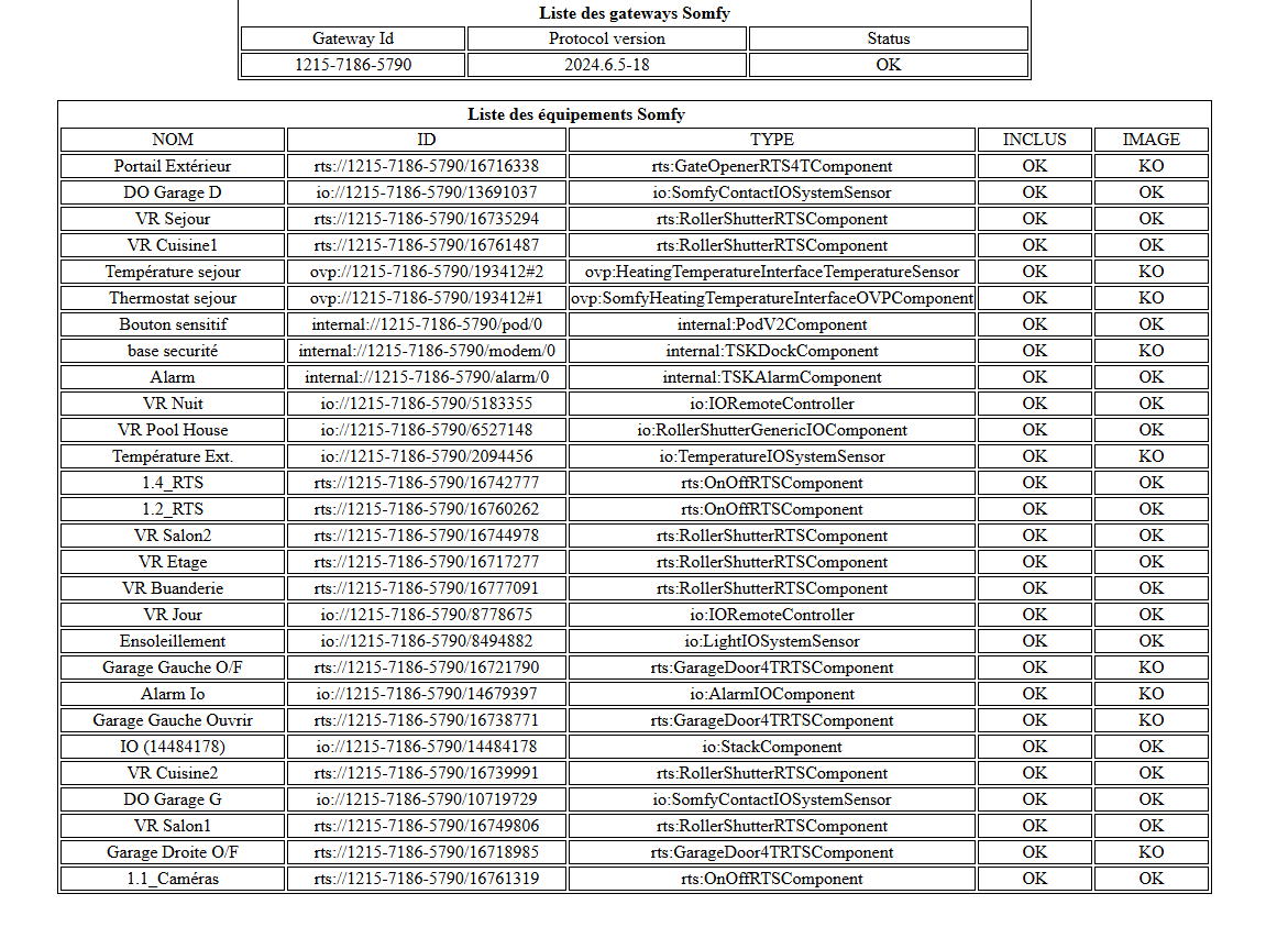

<table style="margin: 0 auto; border: 1px solid"><thead><tr style="border: 1px solid;"><th colspan="4" style="text-align: center">Liste des gateways Somfy</th></tr></thead><tbody><tr><td style="text-align: center; width: 200px;border: 1px solid">Gateway Id</td><td style="text-align: center; width: 250px;border: 1px solid">Protocol version</td><td style="text-align: center; width: 250px;border: 1px solid">Status </td><tr style="border: 1px solid;"><td style="text-align: center; width: 200px;border: 1px solid">1215-7186-5790</td><td style="text-align: center; width: 200px;border: 1px solid">2024.6.5-18</td><td style="text-align: center; width: 200px;border: 1px solid">OK</td></tr></tbody></table></br><table style="margin: 0 auto; border: 1px solid"><thead><tr style="border: 1px solid;"><th colspan="4" style="text-align: center">Liste des équipements Somfy</th></tr></thead><tbody><tr><td style="text-align: center; width: 200px;border: 1px solid">NOM</td><td style="text-align: center; width: 250px;border: 1px solid">ID</td><td style="text-align: center; width: 250px;border: 1px solid">TYPE</td><td style="text-align: center;width: 100px;border: 1px solid">INCLUS</td><td style="text-align: center; width: 100px;border: 1px solid">IMAGE</td></tr><tr style="border: 1px solid;"><td style="text-align: center; width: 200px;border: 1px solid">Portail Extérieur</td><td style="text-align: center; width: 200px;border: 1px solid">rts://1215-7186-5790/16716338</td><td style="text-align: center; width: 200px;border: 1px solid">rts:GateOpenerRTS4TComponent</td><td style="text-align: center;border: 1px solid"">OK</td><td style="text-align: center;border: 1px solid"">KO</i></td></tr><tr style="border: 1px solid;"><td style="text-align: center; width: 200px;border: 1px solid">DO Garage D</td><td style="text-align: center; width: 200px;border: 1px solid">io://1215-7186-5790/13691037</td><td style="text-align: center; width: 200px;border: 1px solid">io:SomfyContactIOSystemSensor</td><td style="text-align: center;border: 1px solid"">OK</td><td style="text-align: center;border: 1px solid"">OK</i></td></tr><tr style="border: 1px solid;"><td style="text-align: center; width: 200px;border: 1px solid">VR Sejour</td><td style="text-align: center; width: 200px;border: 1px solid">rts://1215-7186-5790/16735294</td><td style="text-align: center; width: 200px;border: 1px solid">rts:RollerShutterRTSComponent</td><td style="text-align: center;border: 1px solid"">OK</td><td style="text-align: center;border: 1px solid"">OK</i></td></tr><tr style="border: 1px solid;"><td style="text-align: center; width: 200px;border: 1px solid">VR Cuisine1</td><td style="text-align: center; width: 200px;border: 1px solid">rts://1215-7186-5790/16761487</td><td style="text-align: center; width: 200px;border: 1px solid">rts:RollerShutterRTSComponent</td><td style="text-align: center;border: 1px solid"">OK</td><td style="text-align: center;border: 1px solid"">OK</i></td></tr><tr style="border: 1px solid;"><td style="text-align: center; width: 200px;border: 1px solid">Température sejour</td><td style="text-align: center; width: 200px;border: 1px solid">ovp://1215-7186-5790/193412#2</td><td style="text-align: center; width: 200px;border: 1px solid">ovp:HeatingTemperatureInterfaceTemperatureSensor</td><td style="text-align: center;border: 1px solid"">OK</td><td style="text-align: center;border: 1px solid"">KO</i></td></tr><tr style="border: 1px solid;"><td style="text-align: center; width: 200px;border: 1px solid">Thermostat sejour</td><td style="text-align: center; width: 200px;border: 1px solid">ovp://1215-7186-5790/193412#1</td><td style="text-align: center; width: 200px;border: 1px solid">ovp:SomfyHeatingTemperatureInterfaceOVPComponent</td><td style="text-align: center;border: 1px solid"">OK</td><td style="text-align: center;border: 1px solid"">KO</i></td></tr><tr style="border: 1px solid;"><td style="text-align: center; width: 200px;border: 1px solid">Bouton sensitif</td><td style="text-align: center; width: 200px;border: 1px solid">internal://1215-7186-5790/pod/0</td><td style="text-align: center; width: 200px;border: 1px solid">internal:PodV2Component</td><td style="text-align: center;border: 1px solid"">OK</td><td style="text-align: center;border: 1px solid"">OK</i></td></tr><tr style="border: 1px solid;"><td style="text-align: center; width: 200px;border: 1px solid">base securité</td><td style="text-align: center; width: 200px;border: 1px solid">internal://1215-7186-5790/modem/0</td><td style="text-align: center; width: 200px;border: 1px solid">internal:TSKDockComponent</td><td style="text-align: center;border: 1px solid"">OK</td><td style="text-align: center;border: 1px solid"">KO</i></td></tr><tr style="border: 1px solid;"><td style="text-align: center; width: 200px;border: 1px solid">Alarm</td><td style="text-align: center; width: 200px;border: 1px solid">internal://1215-7186-5790/alarm/0</td><td style="text-align: center; width: 200px;border: 1px solid">internal:TSKAlarmComponent</td><td style="text-align: center;border: 1px solid"">OK</td><td style="text-align: center;border: 1px solid"">OK</i></td></tr><tr style="border: 1px solid;"><td style="text-align: center; width: 200px;border: 1px solid">VR Nuit</td><td style="text-align: center; width: 200px;border: 1px solid">io://1215-7186-5790/5183355</td><td style="text-align: center; width: 200px;border: 1px solid">io:IORemoteController</td><td style="text-align: center;border: 1px solid"">OK</td><td style="text-align: center;border: 1px solid"">OK</i></td></tr><tr style="border: 1px solid;"><td style="text-align: center; width: 200px;border: 1px solid">VR Pool House</td><td style="text-align: center; width: 200px;border: 1px solid">io://1215-7186-5790/6527148</td><td style="text-align: center; width: 200px;border: 1px solid">io:RollerShutterGenericIOComponent</td><td style="text-align: center;border: 1px solid"">OK</td><td style="text-align: center;border: 1px solid"">OK</i></td></tr><tr style="border: 1px solid;"><td style="text-align: center; width: 200px;border: 1px solid">Température Ext.</td><td style="text-align: center; width: 200px;border: 1px solid">io://1215-7186-5790/2094456</td><td style="text-align: center; width: 200px;border: 1px solid">io:TemperatureIOSystemSensor</td><td style="text-align: center;border: 1px solid"">OK</td><td style="text-align: center;border: 1px solid"">KO</i></td></tr><tr style="border: 1px solid;"><td style="text-align: center; width: 200px;border: 1px solid">1.4_RTS</td><td style="text-align: center; width: 200px;border: 1px solid">rts://1215-7186-5790/16742777</td><td style="text-align: center; width: 200px;border: 1px solid">rts:OnOffRTSComponent</td><td style="text-align: center;border: 1px solid"">OK</td><td style="text-align: center;border: 1px solid"">OK</i></td></tr><tr style="border: 1px solid;"><td style="text-align: center; width: 200px;border: 1px solid">1.2_RTS</td><td style="text-align: center; width: 200px;border: 1px solid">rts://1215-7186-5790/16760262</td><td style="text-align: center; width: 200px;border: 1px solid">rts:OnOffRTSComponent</td><td style="text-align: center;border: 1px solid"">OK</td><td style="text-align: center;border: 1px solid"">OK</i></td></tr><tr style="border: 1px solid;"><td style="text-align: center; width: 200px;border: 1px solid">VR Salon2</td><td style="text-align: center; width: 200px;border: 1px solid">rts://1215-7186-5790/16744978</td><td style="text-align: center; width: 200px;border: 1px solid">rts:RollerShutterRTSComponent</td><td style="text-align: center;border: 1px solid"">OK</td><td style="text-align: center;border: 1px solid"">OK</i></td></tr><tr style="border: 1px solid;"><td style="text-align: center; width: 200px;border: 1px solid">VR Etage</td><td style="text-align: center; width: 200px;border: 1px solid">rts://1215-7186-5790/16717277</td><td style="text-align: center; width: 200px;border: 1px solid">rts:RollerShutterRTSComponent</td><td style="text-align: center;border: 1px solid"">OK</td><td style="text-align: center;border: 1px solid"">OK</i></td></tr><tr style="border: 1px solid;"><td style="text-align: center; width: 200px;border: 1px solid">VR Buanderie</td><td style="text-align: center; width: 200px;border: 1px solid">rts://1215-7186-5790/16777091</td><td style="text-align: center; width: 200px;border: 1px solid">rts:RollerShutterRTSComponent</td><td style="text-align: center;border: 1px solid"">OK</td><td style="text-align: center;border: 1px solid"">OK</i></td></tr><tr style="border: 1px solid;"><td style="text-align: center; width: 200px;border: 1px solid">VR Jour</td><td style="text-align: center; width: 200px;border: 1px solid">io://1215-7186-5790/8778675</td><td style="text-align: center; width: 200px;border: 1px solid">io:IORemoteController</td><td style="text-align: center;border: 1px solid"">OK</td><td style="text-align: center;border: 1px solid"">OK</i></td></tr><tr style="border: 1px solid;"><td style="text-align: center; width: 200px;border: 1px solid">Ensoleillement</td><td style="text-align: center; width: 200px;border: 1px solid">io://1215-7186-5790/8494882</td><td style="text-align: center; width: 200px;border: 1px solid">io:LightIOSystemSensor</td><td style="text-align: center;border: 1px solid"">OK</td><td style="text-align: center;border: 1px solid"">OK</i></td></tr><tr style="border: 1px solid;"><td style="text-align: center; width: 200px;border: 1px solid">Garage Gauche O/F</td><td style="text-align: center; width: 200px;border: 1px solid">rts://1215-7186-5790/16721790</td><td style="text-align: center; width: 200px;border: 1px solid">rts:GarageDoor4TRTSComponent</td><td style="text-align: center;border: 1px solid"">OK</td><td style="text-align: center;border: 1px solid"">KO</i></td></tr><tr style="border: 1px solid;"><td style="text-align: center; width: 200px;border: 1px solid">Alarm Io</td><td style="text-align: center; width: 200px;border: 1px solid">io://1215-7186-5790/14679397</td><td style="text-align: center; width: 200px;border: 1px solid">io:AlarmIOComponent</td><td style="text-align: center;border: 1px solid"">OK</td><td style="text-align: center;border: 1px solid"">KO</i></td></tr><tr style="border: 1px solid;"><td style="text-align: center; width: 200px;border: 1px solid">Garage Gauche Ouvrir</td><td style="text-align: center; width: 200px;border: 1px solid">rts://1215-7186-5790/16738771</td><td style="text-align: center; width: 200px;border: 1px solid">rts:GarageDoor4TRTSComponent</td><td style="text-align: center;border: 1px solid"">OK</td><td style="text-align: center;border: 1px solid"">KO</i></td></tr><tr style="border: 1px solid;"><td style="text-align: center; width: 200px;border: 1px solid">IO (14484178)</td><td style="text-align: center; width: 200px;border: 1px solid">io://1215-7186-5790/14484178</td><td style="text-align: center; width: 200px;border: 1px solid">io:StackComponent</td><td style="text-align: center;border: 1px solid"">OK</td><td style="text-align: center;border: 1px solid"">OK</i></td></tr><tr style="border: 1px solid;"><td style="text-align: center; width: 200px;border: 1px solid">VR Cuisine2</td><td style="text-align: center; width: 200px;border: 1px solid">rts://1215-7186-5790/16739991</td><td style="text-align: center; width: 200px;border: 1px solid">rts:RollerShutterRTSComponent</td><td style="text-align: center;border: 1px solid"">OK</td><td style="text-align: center;border: 1px solid"">OK</i></td></tr><tr style="border: 1px solid;"><td style="text-align: center; width: 200px;border: 1px solid">DO Garage G</td><td style="text-align: center; width: 200px;border: 1px solid">io://1215-7186-5790/10719729</td><td style="text-align: center; width: 200px;border: 1px solid">io:SomfyContactIOSystemSensor</td><td style="text-align: center;border: 1px solid"">OK</td><td style="text-align: center;border: 1px solid"">OK</i></td></tr><tr style="border: 1px solid;"><td style="text-align: center; width: 200px;border: 1px solid">VR Salon1</td><td style="text-align: center; width: 200px;border: 1px solid">rts://1215-7186-5790/16749806</td><td style="text-align: center; width: 200px;border: 1px solid">rts:RollerShutterRTSComponent</td><td style="text-align: center;border: 1px solid"">OK</td><td style="text-align: center;border: 1px solid"">OK</i></td></tr><tr style="border: 1px solid;"><td style="text-align: center; width: 200px;border: 1px solid">Garage Droite O/F</td><td style="text-align: center; width: 200px;border: 1px solid">rts://1215-7186-5790/16718985</td><td style="text-align: center; width: 200px;border: 1px solid">rts:GarageDoor4TRTSComponent</td><td style="text-align: center;border: 1px solid"">OK</td><td style="text-align: center;border: 1px solid"">KO</i></td></tr><tr style="border: 1px solid;"><td style="text-align: center; width: 200px;border: 1px solid">1.1_Caméras</td><td style="text-align: center; width: 200px;border: 1px solid">rts://1215-7186-5790/16761319</td><td style="text-align: center; width: 200px;border: 1px solid">rts:OnOffRTSComponent</td><td style="text-align: center;border: 1px solid"">OK</td><td style="text-align: center;border: 1px solid"">OK</i></td></tr></tbody></table>

comment se nomme l’equipement manquant ?
j’ai peur que l’api locale ne retourne pas cet équipement car dans le tableau recapitulatif tous semblent intégrés …
