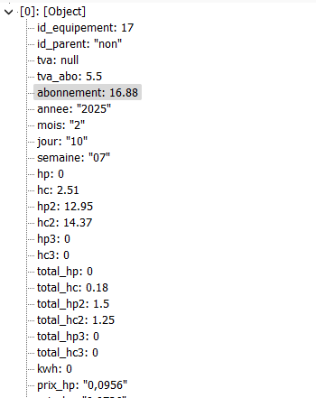

Résultat fct GetCalculPrice
[{"id_equipement":17,"id_parent":"non","tva":null,"tva_abo":5.5,"abonnement":16.88,"annee":"2025","mois":"2","jour":"10","semaine":"07","hp":0,"hc":2.51,"hp2":12.95,"hc2":14.37,"hp3":0,"hc3":0,"total_hp":0,"total_hc":0.18,"total_hp2":1.5,"total_hc2":1.25,"total_hp3":0,"total_hc3":0,"kwh":0,"prix_hp":"0,0956","prix_hc":"0,0736","prix_hp2":"0,1156","prix_hc2":"0,0869","prix_hp3":"0,5151","prix_hc3":"0,0928","temp_min":null,"temp_max":"0.00","temp_moy":null,"dju":null,"dju_clim":"0","categorie":"2025-02-10","rec_date":"2025-02-10"}]

Le premier problème vient du montant retourner par la fonction GetCalculPrice de l’abonnement
Ici 16.88 alors qu’il devrait être 16.54*1.055 = 14.45 → il faut investiguer la requete sql qui fait cette extraction mais elle est énorme … :slight_smile:
