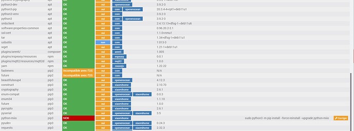

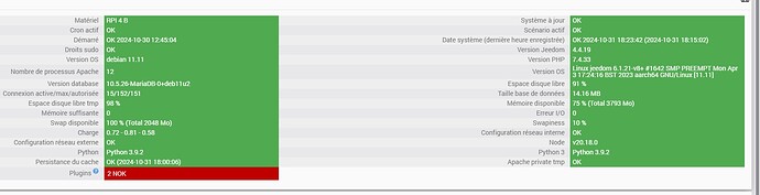

J’ai voulu passé mon jeedom d’une vm Freebox Delta sur un rpi4
J’ai un soucis avec Xiaomi Home
celui ci a toujours les dependances NOK
d’Habitude sur la vm freebox en appliquant cette installation c’etait bon la rien a faire
sudo pip3 install --force-reinstall --upgrade python-miio

[2024-10-31 18:20:26.783][DEBUG] : Send to jeedom : {'devices': {'aquara_34ce008bfe0f': {'model': 'gateway', 'sid': '34ce008bfe0f', 'cmd': 'heartbeat', 'short_id': '0', 'source': '192.168.0.23', 'token': '2IxAjaF8RLIxfDd3', 'data': {'ip': '192.168.0.23'}}}}
[2024-10-31 18:20:26.786][DEBUG] : Starting new HTTP connection (1): 192.168.0.45:80
[2024-10-31 18:20:26.815][DEBUG] : http://192.168.0.45:80 "POST /plugins/xiaomihome/core/php/jeeXiaomiHome.php?apikey=ONVWPKPxmy4jgdARGUwJSKMRrygfPyBb HTTP/11" 200 0
[2024-10-31 18:20:29.560][DEBUG] : {'cmd': 'heartbeat', 'model': 'gateway', 'sid': '7811dcdac84a', 'short_id': '0', 'token': '7jIGcgYZle2uuN9h', 'data': '{"ip":"192.168.0.82"}'}
[2024-10-31 18:20:29.599][DEBUG] : Send to jeedom : {'devices': {'aquara_7811dcdac84a': {'model': 'gateway', 'sid': '7811dcdac84a', 'cmd': 'heartbeat', 'short_id': '0', 'source': '192.168.0.82', 'token': '7jIGcgYZle2uuN9h', 'data': {'ip': '192.168.0.82'}}}}
[2024-10-31 18:20:29.602][DEBUG] : Starting new HTTP connection (1): 192.168.0.45:80
[2024-10-31 18:20:29.619][DEBUG] : http://192.168.0.45:80 "POST /plugins/xiaomihome/core/php/jeeXiaomiHome.php?apikey=ONVWPKPxmy4jgdARGUwJSKMRrygfPyBb HTTP/11" 200 0
[2024-10-31 18:20:33.812][DEBUG] : {'cmd': 'heartbeat', 'model': 'gateway', 'sid': '7c49eb890cad', 'short_id': '0', 'token': 'OlG28q2AK8sJLLoj', 'data': '{"ip":"192.168.0.87"}'}
[2024-10-31 18:20:33.826][DEBUG] : Send to jeedom : {'devices': {'aquara_7c49eb890cad': {'model': 'gateway', 'sid': '7c49eb890cad', 'cmd': 'heartbeat', 'short_id': '0', 'source': '192.168.0.87', 'token': 'OlG28q2AK8sJLLoj', 'data': {'ip': '192.168.0.87'}}}}
[2024-10-31 18:20:33.832][DEBUG] : Starting new HTTP connection (1): 192.168.0.45:80
[2024-10-31 18:20:33.858][DEBUG] : http://192.168.0.45:80 "POST /plugins/xiaomihome/core/php/jeeXiaomiHome.php?apikey=ONVWPKPxmy4jgdARGUwJSKMRrygfPyBb HTTP/11" 200 0
[2024-10-31 18:20:36.720][DEBUG] : {'cmd': 'heartbeat', 'model': 'gateway', 'sid': '34ce008bfe0f', 'short_id': '0', 'token': 'bsd7gxn6MFRSlnEg', 'data': '{"ip":"192.168.0.23"}'}
[2024-10-31 18:20:36.750][DEBUG] : Send to jeedom : {'devices': {'aquara_34ce008bfe0f': {'model': 'gateway', 'sid': '34ce008bfe0f', 'cmd': 'heartbeat', 'short_id': '0', 'source': '192.168.0.23', 'token': 'bsd7gxn6MFRSlnEg', 'data': {'ip': '192.168.0.23'}}}}
[2024-10-31 18:20:36.753][DEBUG] : Starting new HTTP connection (1): 192.168.0.45:80
[2024-10-31 18:20:36.770][DEBUG] : http://192.168.0.45:80 "POST /plugins/xiaomihome/core/php/jeeXiaomiHome.php?apikey=ONVWPKPxmy4jgdARGUwJSKMRrygfPyBb HTTP/11" 200 0
[2024-10-31 18:20:39.536][DEBUG] : {'cmd': 'heartbeat', 'model': 'gateway', 'sid': '7811dcdac84a', 'short_id': '0', 'token': 'pZMZ3Ns1fAKVTVCB', 'data': '{"ip":"192.168.0.82"}'}
[2024-10-31 18:20:39.545][DEBUG] : Send to jeedom : {'devices': {'aquara_7811dcdac84a': {'model': 'gateway', 'sid': '7811dcdac84a', 'cmd': 'heartbeat', 'short_id': '0', 'source': '192.168.0.82', 'token': 'pZMZ3Ns1fAKVTVCB', 'data': {'ip': '192.168.0.82'}}}}
[2024-10-31 18:20:39.548][DEBUG] : Starting new HTTP connection (1): 192.168.0.45:80
[2024-10-31 18:20:39.562][DEBUG] : http://192.168.0.45:80 "POST /plugins/xiaomihome/core/php/jeeXiaomiHome.php?apikey=ONVWPKPxmy4jgdARGUwJSKMRrygfPyBb HTTP/11" 200 0
[2024-10-31 18:20:43.806][DEBUG] : {'cmd': 'heartbeat', 'model': 'gateway', 'sid': '7c49eb890cad', 'short_id': '0', 'token': 'PRo5dtobZoNsJuvQ', 'data': '{"ip":"192.168.0.87"}'}
[2024-10-31 18:20:43.809][DEBUG] : Send to jeedom : {'devices': {'aquara_7c49eb890cad': {'model': 'gateway', 'sid': '7c49eb890cad', 'cmd': 'heartbeat', 'short_id': '0', 'source': '192.168.0.87', 'token': 'PRo5dtobZoNsJuvQ', 'data': {'ip': '192.168.0.87'}}}}
[2024-10-31 18:20:43.812][DEBUG] : Starting new HTTP connection (1): 192.168.0.45:80
[2024-10-31 18:20:43.827][DEBUG] : http://192.168.0.45:80 "POST /plugins/xiaomihome/core/php/jeeXiaomiHome.php?apikey=ONVWPKPxmy4jgdARGUwJSKMRrygfPyBb HTTP/11" 200 0
[2024-10-31 18:20:46.755][DEBUG] : {'cmd': 'heartbeat', 'model': 'gateway', 'sid': '34ce008bfe0f', 'short_id': '0', 'token': 'P7kBgsxDfir0BC5W', 'data': '{"ip":"192.168.0.23"}'}
[2024-10-31 18:20:46.805][DEBUG] : Send to jeedom : {'devices': {'aquara_34ce008bfe0f': {'model': 'gateway', 'sid': '34ce008bfe0f', 'cmd': 'heartbeat', 'short_id': '0', 'source': '192.168.0.23', 'token': 'P7kBgsxDfir0BC5W', 'data': {'ip': '192.168.0.23'}}}}
[2024-10-31 18:20:46.810][DEBUG] : Starting new HTTP connection (1): 192.168.0.45:80
[2024-10-31 18:20:46.837][DEBUG] : http://192.168.0.45:80 "POST /plugins/xiaomihome/core/php/jeeXiaomiHome.php?apikey=ONVWPKPxmy4jgdARGUwJSKMRrygfPyBb HTTP/11" 200 0
[2024-10-31 18:20:53.784][DEBUG] : {'cmd': 'heartbeat', 'model': 'gateway', 'sid': '7c49eb890cad', 'short_id': '0', 'token': 'r9uTIsNJZ46LPJaR', 'data': '{"ip":"192.168.0.87"}'}
[2024-10-31 18:20:53.819][DEBUG] : Send to jeedom : {'devices': {'aquara_7c49eb890cad': {'model': 'gateway', 'sid': '7c49eb890cad', 'cmd': 'heartbeat', 'short_id': '0', 'source': '192.168.0.87', 'token': 'r9uTIsNJZ46LPJaR', 'data': {'ip': '192.168.0.87'}}}}
[2024-10-31 18:20:53.822][DEBUG] : Starting new HTTP connection (1): 192.168.0.45:80
[2024-10-31 18:20:53.836][DEBUG] : http://192.168.0.45:80 "POST /plugins/xiaomihome/core/php/jeeXiaomiHome.php?apikey=ONVWPKPxmy4jgdARGUwJSKMRrygfPyBb HTTP/11" 200 0
[2024-10-31 18:20:56.695][DEBUG] : {'cmd': 'heartbeat', 'model': 'gateway', 'sid': '34ce008bfe0f', 'short_id': '0', 'token': 'ZwhqsosXRMttlFYm', 'data': '{"ip":"192.168.0.23"}'}
[2024-10-31 18:20:56.715][DEBUG] : Send to jeedom : {'devices': {'aquara_34ce008bfe0f': {'model': 'gateway', 'sid': '34ce008bfe0f', 'cmd': 'heartbeat', 'short_id': '0', 'source': '192.168.0.23', 'token': 'ZwhqsosXRMttlFYm', 'data': {'ip': '192.168.0.23'}}}}
[2024-10-31 18:20:56.718][DEBUG] : Starting new HTTP connection (1): 192.168.0.45:80
[2024-10-31 18:20:56.731][DEBUG] : http://192.168.0.45:80 "POST /plugins/xiaomihome/core/php/jeeXiaomiHome.php?apikey=ONVWPKPxmy4jgdARGUwJSKMRrygfPyBb HTTP/11" 200 0
[2024-10-31 18:20:59.495][DEBUG] : {'cmd': 'heartbeat', 'model': 'gateway', 'sid': '7811dcdac84a', 'short_id': '0', 'token': 'Lbi0dhi08X6BAg6h', 'data': '{"ip":"192.168.0.82"}'}
[2024-10-31 18:20:59.508][DEBUG] : Send to jeedom : {'devices': {'aquara_7811dcdac84a': {'model': 'gateway', 'sid': '7811dcdac84a', 'cmd': 'heartbeat', 'short_id': '0', 'source': '192.168.0.82', 'token': 'Lbi0dhi08X6BAg6h', 'data': {'ip': '192.168.0.82'}}}}
[2024-10-31 18:20:59.511][DEBUG] : Starting new HTTP connection (1): 192.168.0.45:80
[2024-10-31 18:20:59.530][DEBUG] : http://192.168.0.45:80 "POST /plugins/xiaomihome/core/php/jeeXiaomiHome.php?apikey=ONVWPKPxmy4jgdARGUwJSKMRrygfPyBb HTTP/11" 200 0
[2024-10-31 18:21:03.762][DEBUG] : {'cmd': 'heartbeat', 'model': 'gateway', 'sid': '7c49eb890cad', 'short_id': '0', 'token': 'Jp5PzzMqDKPZiQzw', 'data': '{"ip":"192.168.0.87"}'}
[2024-10-31 18:21:03.808][DEBUG] : Send to jeedom : {'devices': {'aquara_7c49eb890cad': {'model': 'gateway', 'sid': '7c49eb890cad', 'cmd': 'heartbeat', 'short_id': '0', 'source': '192.168.0.87', 'token': 'Jp5PzzMqDKPZiQzw', 'data': {'ip': '192.168.0.87'}}}}
[2024-10-31 18:21:03.811][DEBUG] : Starting new HTTP connection (1): 192.168.0.45:80
[2024-10-31 18:21:03.825][DEBUG] : http://192.168.0.45:80 "POST /plugins/xiaomihome/core/php/jeeXiaomiHome.php?apikey=ONVWPKPxmy4jgdARGUwJSKMRrygfPyBb HTTP/11" 200 0
[2024-10-31 18:21:06.669][DEBUG] : {'cmd': 'heartbeat', 'model': 'gateway', 'sid': '34ce008bfe0f', 'short_id': '0', 'token': 'XXrEGCaM4X6Sm5iA', 'data': '{"ip":"192.168.0.23"}'}
[2024-10-31 18:21:06.703][DEBUG] : Send to jeedom : {'devices': {'aquara_34ce008bfe0f': {'model': 'gateway', 'sid': '34ce008bfe0f', 'cmd': 'heartbeat', 'short_id': '0', 'source': '192.168.0.23', 'token': 'XXrEGCaM4X6Sm5iA', 'data': {'ip': '192.168.0.23'}}}}
[2024-10-31 18:21:06.709][DEBUG] : Starting new HTTP connection (1): 192.168.0.45:80
[2024-10-31 18:21:06.719][DEBUG] : {'cmd': 'get_id_list', '34ce008bfe0f': '34ce008bfe0f'}
[2024-10-31 18:21:06.735][DEBUG] : http://192.168.0.45:80 "POST /plugins/xiaomihome/core/php/jeeXiaomiHome.php?apikey=ONVWPKPxmy4jgdARGUwJSKMRrygfPyBb HTTP/11" 200 0
[2024-10-31 18:21:06.850][DEBUG] : {'cmd': 'read', 'sid': '158d0001bba86b'}
[2024-10-31 18:21:06.901][DEBUG] : {'cmd': 'read', 'sid': '158d0001a9e262'}
[2024-10-31 18:21:06.952][DEBUG] : {'cmd': 'read', 'sid': '158d00019fff22'}
[2024-10-31 18:21:07.002][DEBUG] : {'cmd': 'read', 'sid': '158d00010817bf'}
[2024-10-31 18:21:07.053][DEBUG] : {'cmd': 'read', 'sid': '158d0003585442'}
[2024-10-31 18:21:09.473][DEBUG] : {'cmd': 'heartbeat', 'model': 'gateway', 'sid': '7811dcdac84a', 'short_id': '0', 'token': '94kbPpsmRCaPLeTy', 'data': '{"ip":"192.168.0.82"}'}
[2024-10-31 18:21:09.512][DEBUG] : Send to jeedom : {'devices': {'aquara_7811dcdac84a': {'model': 'gateway', 'sid': '7811dcdac84a', 'cmd': 'heartbeat', 'short_id': '0', 'source': '192.168.0.82', 'token': '94kbPpsmRCaPLeTy', 'data': {'ip': '192.168.0.82'}}}}
[2024-10-31 18:21:09.515][DEBUG] : Starting new HTTP connection (1): 192.168.0.45:80
[2024-10-31 18:21:09.524][DEBUG] : {'cmd': 'get_id_list', '7811dcdac84a': '7811dcdac84a'}
[2024-10-31 18:21:09.529][DEBUG] : http://192.168.0.45:80 "POST /plugins/xiaomihome/core/php/jeeXiaomiHome.php?apikey=ONVWPKPxmy4jgdARGUwJSKMRrygfPyBb HTTP/11" 200 0
[2024-10-31 18:21:13.742][DEBUG] : {'cmd': 'heartbeat', 'model': 'gateway', 'sid': '7c49eb890cad', 'short_id': '0', 'token': 'jxStehGpUO5tSigG', 'data': '{"ip":"192.168.0.87"}'}
[2024-10-31 18:21:13.769][DEBUG] : Send to jeedom : {'devices': {'aquara_7c49eb890cad': {'model': 'gateway', 'sid': '7c49eb890cad', 'cmd': 'heartbeat', 'short_id': '0', 'source': '192.168.0.87', 'token': 'jxStehGpUO5tSigG', 'data': {'ip': '192.168.0.87'}}}}
[2024-10-31 18:21:13.772][DEBUG] : Starting new HTTP connection (1): 192.168.0.45:80
[2024-10-31 18:21:13.788][DEBUG] : http://192.168.0.45:80 "POST /plugins/xiaomihome/core/php/jeeXiaomiHome.php?apikey=ONVWPKPxmy4jgdARGUwJSKMRrygfPyBb HTTP/11" 200 0
[2024-10-31 18:21:13.793][DEBUG] : {'cmd': 'get_id_list', '7c49eb890cad': '7c49eb890cad'}
[2024-10-31 18:21:13.846][DEBUG] : {'cmd': 'read', 'sid': '158d00044d8f09'}
[2024-10-31 18:21:13.896][DEBUG] : {'cmd': 'read', 'sid': '158d00044a03db'}
[2024-10-31 18:21:16.651][DEBUG] : {'cmd': 'heartbeat', 'model': 'gateway', 'sid': '34ce008bfe0f', 'short_id': '0', 'token': 'vC6aaJWev68ww29S', 'data': '{"ip":"192.168.0.23"}'}
[2024-10-31 18:21:16.669][DEBUG] : Send to jeedom : {'devices': {'aquara_34ce008bfe0f': {'model': 'gateway', 'sid': '34ce008bfe0f', 'cmd': 'heartbeat', 'short_id': '0', 'source': '192.168.0.23', 'token': 'vC6aaJWev68ww29S', 'data': {'ip': '192.168.0.23'}}}}
[2024-10-31 18:21:16.672][DEBUG] : Starting new HTTP connection (1): 192.168.0.45:80
[2024-10-31 18:21:16.688][DEBUG] : http://192.168.0.45:80 "POST /plugins/xiaomihome/core/php/jeeXiaomiHome.php?apikey=ONVWPKPxmy4jgdARGUwJSKMRrygfPyBb HTTP/11" 200 0
[2024-10-31 18:21:19.451][DEBUG] : {'cmd': 'heartbeat', 'model': 'gateway', 'sid': '7811dcdac84a', 'short_id': '0', 'token': 'DSdDjOufScZTYEI5', 'data': '{"ip":"192.168.0.82"}'}
[2024-10-31 18:21:19.477][DEBUG] : Send to jeedom : {'devices': {'aquara_7811dcdac84a': {'model': 'gateway', 'sid': '7811dcdac84a', 'cmd': 'heartbeat', 'short_id': '0', 'source': '192.168.0.82', 'token': 'DSdDjOufScZTYEI5', 'data': {'ip': '192.168.0.82'}}}}
[2024-10-31 18:21:19.483][DEBUG] : Starting new HTTP connection (1): 192.168.0.45:80
[2024-10-31 18:21:19.514][DEBUG] : http://192.168.0.45:80 "POST /plugins/xiaomihome/core/php/jeeXiaomiHome.php?apikey=ONVWPKPxmy4jgdARGUwJSKMRrygfPyBb HTTP/11" 200 0
[2024-10-31 18:21:21.612][DEBUG] : {'cmd': 'heartbeat', 'model': 'remote.b1acn01', 'sid': '158d00044d8f09', 'short_id': 50856, 'data': '{"voltage":3015}'}
[2024-10-31 18:21:21.645][DEBUG] : Send to jeedom : {'devices': {'aquara_158d00044d8f09': {'model': 'remote.b1acn01', 'sid': '158d00044d8f09', 'cmd': 'heartbeat', 'short_id': 50856, 'source': '192.168.0.23', 'token': '', 'data': {'voltage': 3015}}}}
[2024-10-31 18:21:21.648][DEBUG] : Starting new HTTP connection (1): 192.168.0.45:80
[2024-10-31 18:21:21.672][DEBUG] : http://192.168.0.45:80 "POST /plugins/xiaomihome/core/php/jeeXiaomiHome.php?apikey=ONVWPKPxmy4jgdARGUwJSKMRrygfPyBb HTTP/11" 200 0
[2024-10-31 18:21:23.724][DEBUG] : {'cmd': 'heartbeat', 'model': 'gateway', 'sid': '7c49eb890cad', 'short_id': '0', 'token': 'vCKPNhEb95dDphrs', 'data': '{"ip":"192.168.0.87"}'}
[2024-10-31 18:21:23.746][DEBUG] : Send to jeedom : {'devices': {'aquara_7c49eb890cad': {'model': 'gateway', 'sid': '7c49eb890cad', 'cmd': 'heartbeat', 'short_id': '0', 'source': '192.168.0.87', 'token': 'vCKPNhEb95dDphrs', 'data': {'ip': '192.168.0.87'}}}}
[2024-10-31 18:21:23.749][DEBUG] : Starting new HTTP connection (1): 192.168.0.45:80
[2024-10-31 18:21:23.765][DEBUG] : http://192.168.0.45:80 "POST /plugins/xiaomihome/core/php/jeeXiaomiHome.php?apikey=ONVWPKPxmy4jgdARGUwJSKMRrygfPyBb HTTP/11" 200 0
[2024-10-31 18:21:26.633][DEBUG] : {'cmd': 'heartbeat', 'model': 'gateway', 'sid': '34ce008bfe0f', 'short_id': '0', 'token': 'iREZGr4rd7zHMy9h', 'data': '{"ip":"192.168.0.23"}'}
[2024-10-31 18:21:26.640][DEBUG] : Send to jeedom : {'devices': {'aquara_34ce008bfe0f': {'model': 'gateway', 'sid': '34ce008bfe0f', 'cmd': 'heartbeat', 'short_id': '0', 'source': '192.168.0.23', 'token': 'iREZGr4rd7zHMy9h', 'data': {'ip': '192.168.0.23'}}}}
[2024-10-31 18:21:26.644][DEBUG] : Starting new HTTP connection (1): 192.168.0.45:80
[2024-10-31 18:21:26.663][DEBUG] : http://192.168.0.45:80 "POST /plugins/xiaomihome/core/php/jeeXiaomiHome.php?apikey=ONVWPKPxmy4jgdARGUwJSKMRrygfPyBb HTTP/11" 200 0
[2024-10-31 18:21:29.431][DEBUG] : {'cmd': 'heartbeat', 'model': 'gateway', 'sid': '7811dcdac84a', 'short_id': '0', 'token': 'n3EQ8iYgkhNzk8pF', 'data': '{"ip":"192.168.0.82"}'}
[2024-10-31 18:21:29.451][DEBUG] : Send to jeedom : {'devices': {'aquara_7811dcdac84a': {'model': 'gateway', 'sid': '7811dcdac84a', 'cmd': 'heartbeat', 'short_id': '0', 'source': '192.168.0.82', 'token': 'n3EQ8iYgkhNzk8pF', 'data': {'ip': '192.168.0.82'}}}}
[2024-10-31 18:21:29.457][DEBUG] : Starting new HTTP connection (1): 192.168.0.45:80
[2024-10-31 18:21:29.489][DEBUG] : http://192.168.0.45:80 "POST /plugins/xiaomihome/core/php/jeeXiaomiHome.php?apikey=ONVWPKPxmy4jgdARGUwJSKMRrygfPyBb HTTP/11" 200 0
[2024-10-31 18:21:33.706][DEBUG] : {'cmd': 'heartbeat', 'model': 'gateway', 'sid': '7c49eb890cad', 'short_id': '0', 'token': 'JsvGYxtUIWfd2lSZ', 'data': '{"ip":"192.168.0.87"}'}
[2024-10-31 18:21:33.734][DEBUG] : Send to jeedom : {'devices': {'aquara_7c49eb890cad': {'model': 'gateway', 'sid': '7c49eb890cad', 'cmd': 'heartbeat', 'short_id': '0', 'source': '192.168.0.87', 'token': 'JsvGYxtUIWfd2lSZ', 'data': {'ip': '192.168.0.87'}}}}
[2024-10-31 18:21:33.737][DEBUG] : Starting new HTTP connection (1): 192.168.0.45:80
[2024-10-31 18:21:33.751][DEBUG] : http://192.168.0.45:80 "POST /plugins/xiaomihome/core/php/jeeXiaomiHome.php?apikey=ONVWPKPxmy4jgdARGUwJSKMRrygfPyBb HTTP/11" 200 0
[2024-10-31 18:21:36.614][DEBUG] : {'cmd': 'heartbeat', 'model': 'gateway', 'sid': '34ce008bfe0f', 'short_id': '0', 'token': 'KcJVy5DobsFiZFi5', 'data': '{"ip":"192.168.0.23"}'}
[2024-10-31 18:21:36.627][DEBUG] : Send to jeedom : {'devices': {'aquara_34ce008bfe0f': {'model': 'gateway', 'sid': '34ce008bfe0f', 'cmd': 'heartbeat', 'short_id': '0', 'source': '192.168.0.23', 'token': 'KcJVy5DobsFiZFi5', 'data': {'ip': '192.168.0.23'}}}}
[2024-10-31 18:21:36.630][DEBUG] : Starting new HTTP connection (1): 192.168.0.45:80
[2024-10-31 18:21:36.647][DEBUG] : http://192.168.0.45:80 "POST /plugins/xiaomihome/core/php/jeeXiaomiHome.php?apikey=ONVWPKPxmy4jgdARGUwJSKMRrygfPyBb HTTP/11" 200 0
z du code ici
Cette erreure je sais pas si c’est mon soucis
Preparing metadata (pyproject.toml): finished with status ‹ error ›
error: subprocess-exited-with-error
Si quelqu’un a une idée?
merci
