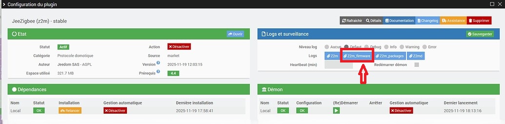

Donc il faut nous mettre des croqettes pour avancer: page configuration, logs, etc.
Ou alors fsites un ticket jeedom.
pourrais-tu fournir le log Z2m_firmware ?
akenad :slight_smile:
Bonjour akenad
Voici le log
[2025-12-18 09:03:45] ALERT  sudo chmod +x /var/www/html/plugins/z2m/core/class/../../resources/misc/luna/AmberGwZ3_arm64_debian_V8;sudo chmod +x /var/www/html/plugins/z2m/core/class/../../resources/misc/luna/AmberGwZ3_498_EZSP0x0E;sudo /var/www/html/plugins/z2m/core/class/../../resources/misc/luna/AmberGwZ3_arm64_debian_V8 -n1 -p /dev/ttyLuna-Zigbee -b115200 -F /var/www/html/plugins/z2m/core/class/../../resources/misc/luna/8.0.3.0.ota >> /var/www/html/core/class/../../log/z2m_firmware 2>&1;
ERROR: ezspForceReset 0x21
AmberGwZ3_arm64_debian_V8: amber_test.c:197: my_test: Assertion `false' failed.
Aborted
