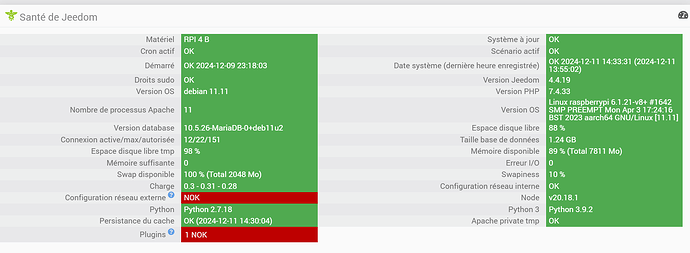

Peut-on avoir l page santé de Jeedom ?

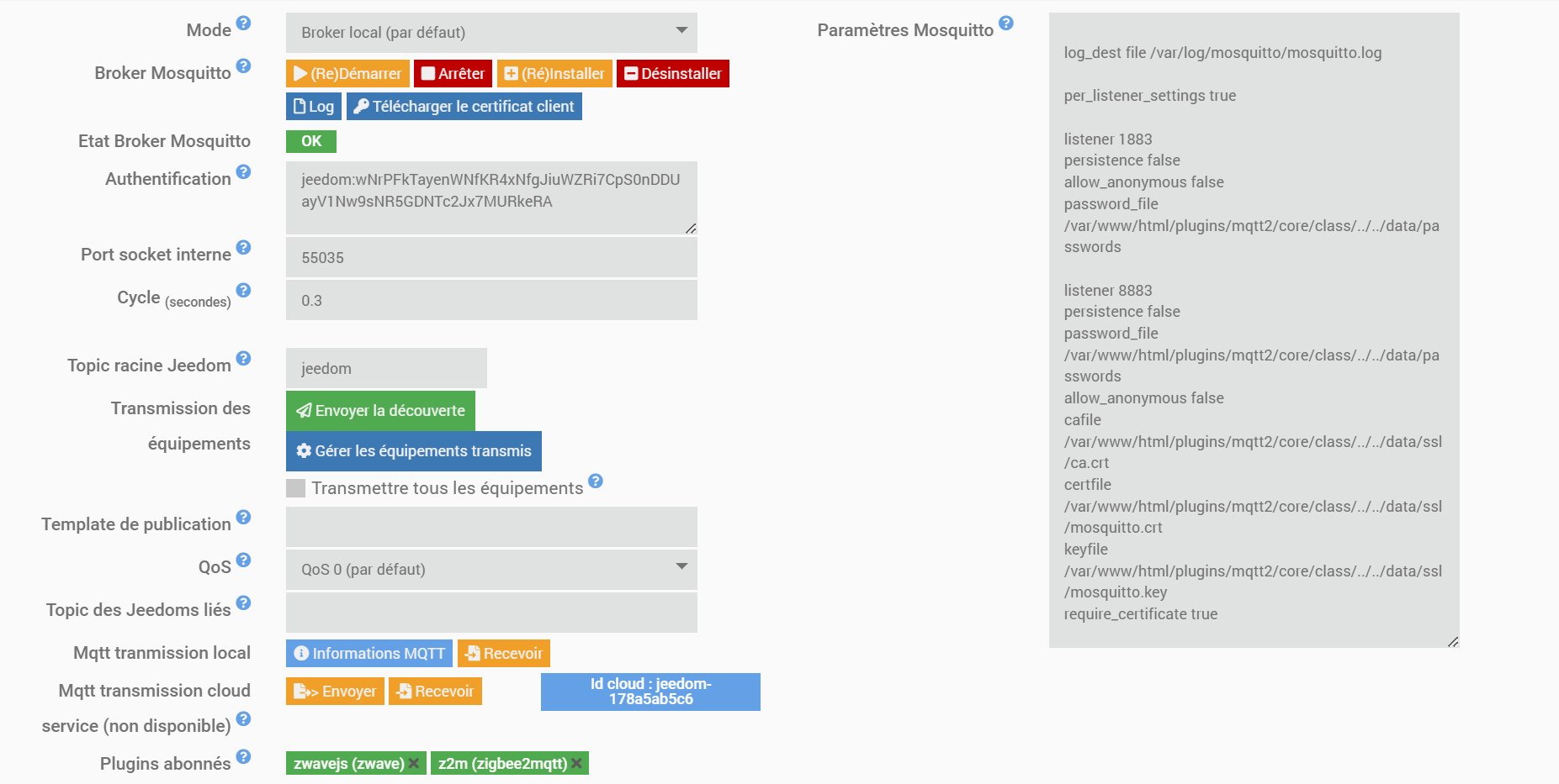

La config de mqtt manager ?
La config du plugin ?
Passer le plugin en log debug, sauvegarder et redémarrer le démon et fournir ce log debug ?
Car pour vous aider, sans information cela risque d’être un peu tricky

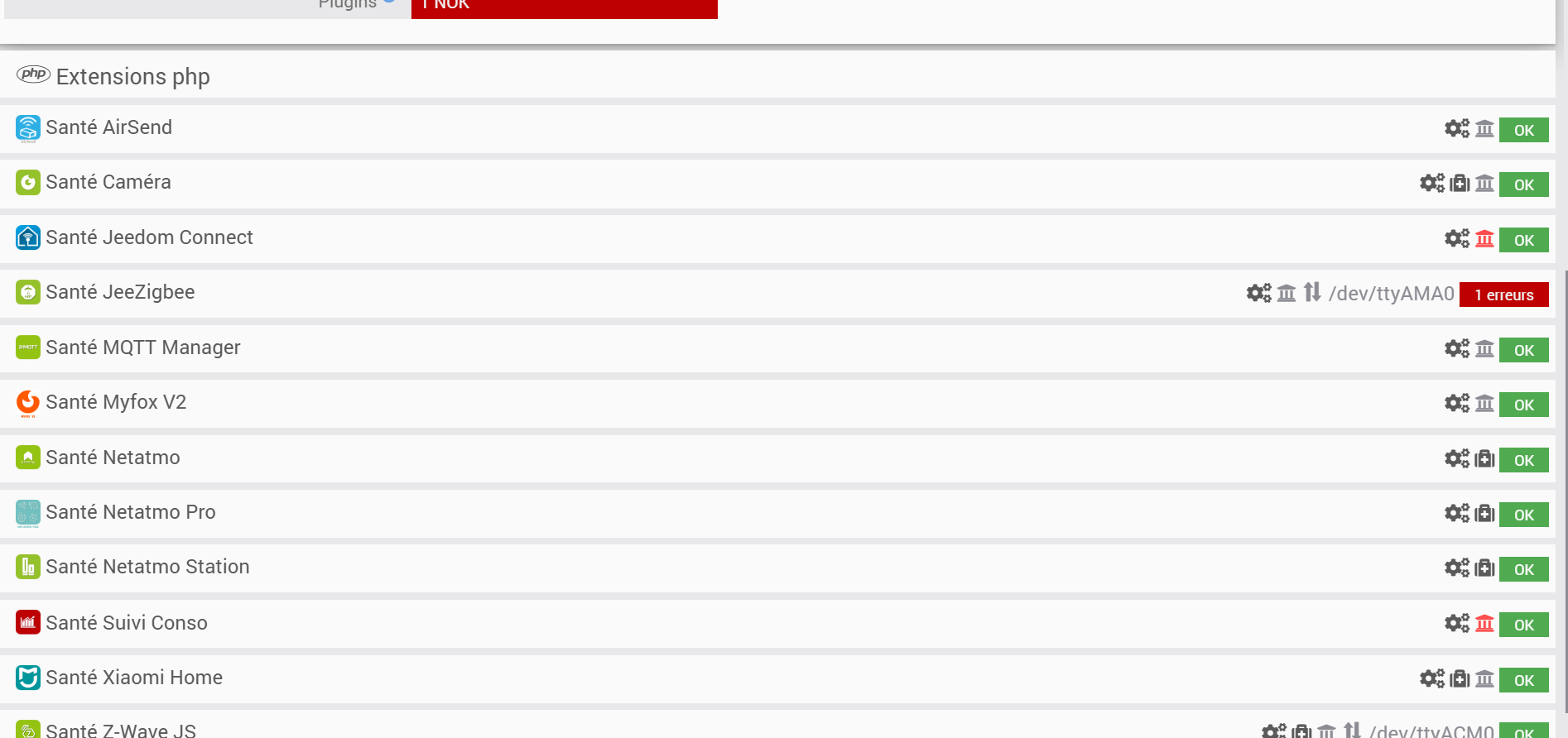

pour la santé de jeedom :

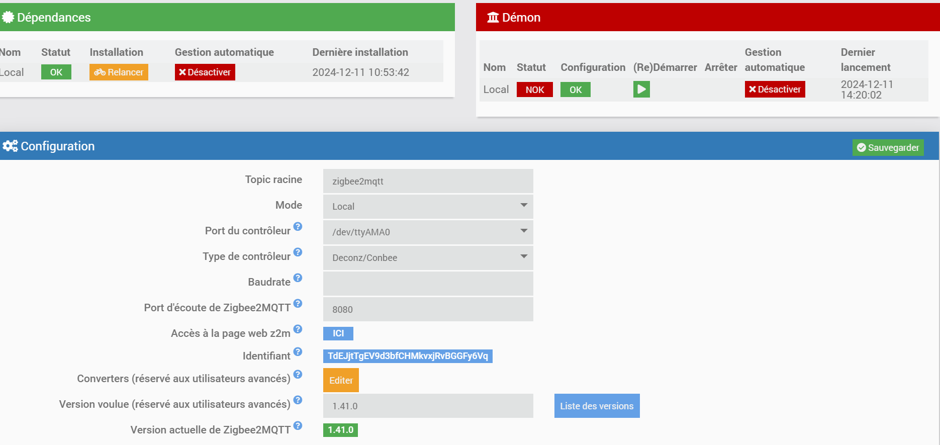

la config du plugin :
pour cette config j’ai modifié la version qui était en 1.42.0

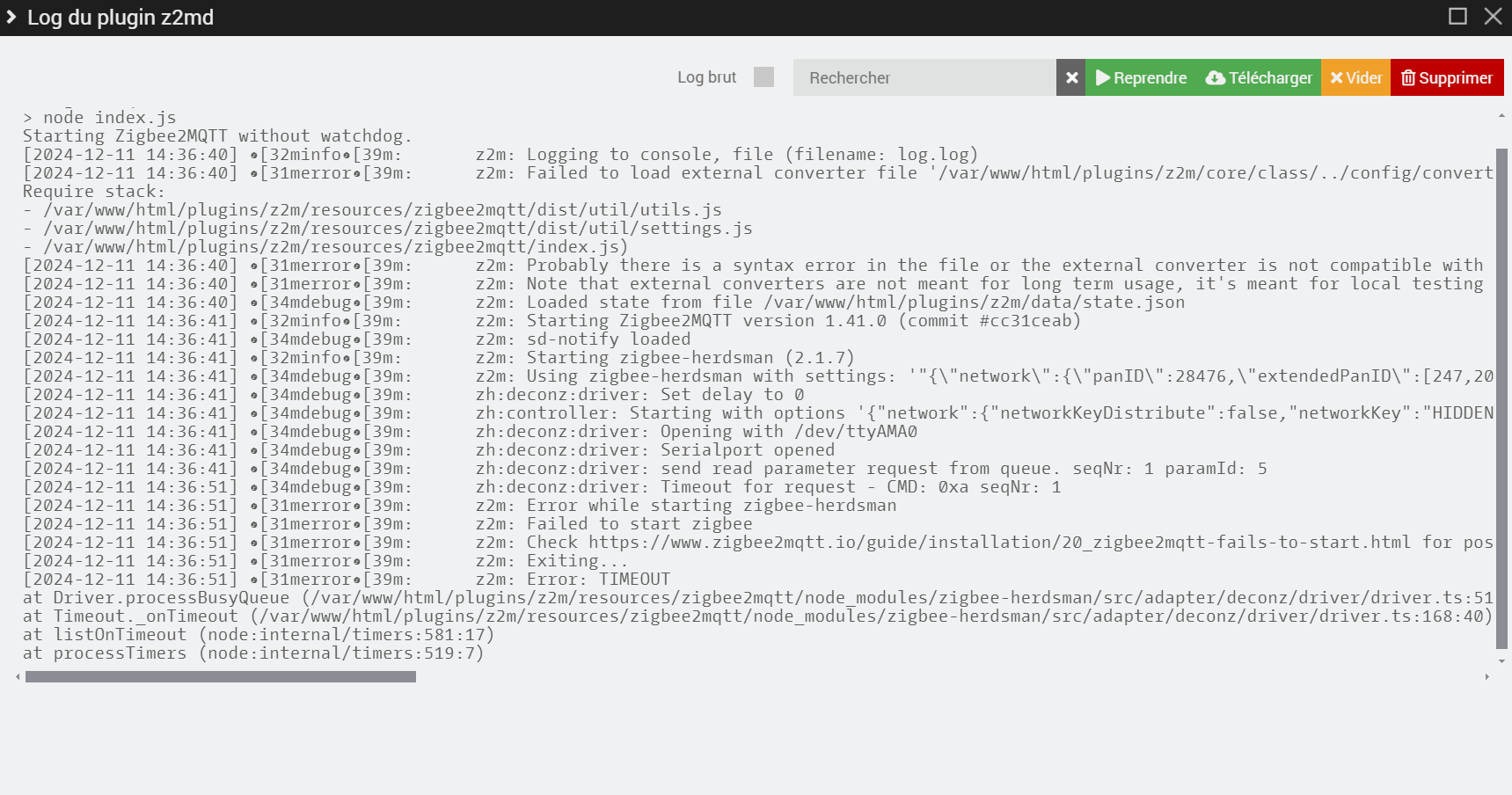

excusez mon inexpérience mais j’essaie de vous fournir le log en debug.
Manque juste la partie intéressante, le tableau du haut :rofl:
Oupss !
et le log obtenu en debug :
> zigbee2mqtt@1.41.0 start
> node index.js
[2024-12-11 14:36:40] e[32minfoe[39m: 	z2m: Logging to console, file (filename: log.log)
[2024-12-11 14:36:40] e[31merrore[39m: 	z2m: Failed to load external converter file '/var/www/html/plugins/z2m/core/class/../config/converters/Danfoss/icon.js' (Cannot find module 'zigbee-herdsman-converters/lib/extend'
Require stack:
- /var/www/html/plugins/z2m/resources/zigbee2mqtt/dist/util/utils.js
- /var/www/html/plugins/z2m/resources/zigbee2mqtt/dist/util/settings.js
- /var/www/html/plugins/z2m/resources/zigbee2mqtt/index.js)
[2024-12-11 14:36:40] e[31merrore[39m: 	z2m: Probably there is a syntax error in the file or the external converter is not compatible with the current Zigbee2MQTT version
[2024-12-11 14:36:40] e[31merrore[39m: 	z2m: Note that external converters are not meant for long term usage, it's meant for local testing after which a pull request should be created to add out-of-the-box support for the device
[2024-12-11 14:36:40] e[34mdebuge[39m: 	z2m: Loaded state from file /var/www/html/plugins/z2m/data/state.json
[2024-12-11 14:36:41] e[32minfoe[39m: 	z2m: Starting Zigbee2MQTT version 1.41.0 (commit #cc31ceab)
[2024-12-11 14:36:41] e[34mdebuge[39m: 	z2m: sd-notify loaded
[2024-12-11 14:36:41] e[32minfoe[39m: 	z2m: Starting zigbee-herdsman (2.1.7)
[2024-12-11 14:36:41] e[34mdebuge[39m: 	z2m: Using zigbee-herdsman with settings: '"{\"network\":{\"panID\":28476,\"extendedPanID\":[247,203,140,127,192,26,174,11],\"channelList\":[11],\"networkKey\":\"HIDDEN\"},\"databasePath\":\"/var/www/html/plugins/z2m/data/database.db\",\"databaseBackupPath\":\"/var/www/html/plugins/z2m/data/database.db.backup\",\"backupPath\":\"/var/www/html/plugins/z2m/data/coordinator_backup.json\",\"serialPort\":{\"path\":\"/dev/ttyAMA0\",\"adapter\":\"deconz\"},\"adapter\":{\"disableLED\":false}}"'
[2024-12-11 14:36:41] e[34mdebuge[39m: 	zh:deconz:driver: Set delay to 0
[2024-12-11 14:36:41] e[34mdebuge[39m: 	zh:controller: Starting with options '{"network":{"networkKeyDistribute":false,"networkKey":"HIDDEN","panID":28476,"extendedPanID":[247,203,140,127,192,26,174,11],"channelList":[11]},"serialPort":{"path":"/dev/ttyAMA0","adapter":"deconz"},"adapter":{"disableLED":false},"databasePath":"/var/www/html/plugins/z2m/data/database.db","databaseBackupPath":"/var/www/html/plugins/z2m/data/database.db.backup","backupPath":"/var/www/html/plugins/z2m/data/coordinator_backup.json"}'
[2024-12-11 14:36:41] e[34mdebuge[39m: 	zh:deconz:driver: Opening with /dev/ttyAMA0
[2024-12-11 14:36:41] e[34mdebuge[39m: 	zh:deconz:driver: Serialport opened
[2024-12-11 14:36:41] e[34mdebuge[39m: 	zh:deconz:driver: send read parameter request from queue. seqNr: 1 paramId: 5
[2024-12-11 14:36:51] e[34mdebuge[39m: 	zh:deconz:driver: Timeout for request - CMD: 0xa seqNr: 1
[2024-12-11 14:36:51] e[31merrore[39m: 	z2m: Error while starting zigbee-herdsman
[2024-12-11 14:36:51] e[31merrore[39m: 	z2m: Failed to start zigbee
[2024-12-11 14:36:51] e[31merrore[39m: 	z2m: Check https://www.zigbee2mqtt.io/guide/installation/20_zigbee2mqtt-fails-to-start.html for possible solutions
[2024-12-11 14:36:51] e[31merrore[39m: 	z2m: Exiting...
[2024-12-11 14:36:51] e[31merrore[39m: 	z2m: Error: TIMEOUT
at Driver.processBusyQueue (/var/www/html/plugins/z2m/resources/zigbee2mqtt/node_modules/zigbee-herdsman/src/adapter/deconz/driver/driver.ts:515:28)
at Timeout._onTimeout (/var/www/html/plugins/z2m/resources/zigbee2mqtt/node_modules/zigbee-herdsman/src/adapter/deconz/driver/driver.ts:168:40)
at listOnTimeout (node:internal/timers:581:17)
at processTimers (node:internal/timers:519:7)
Solution trouvée ce jour en cherchant un peu partout sur le net.
Dans la config du plugin :
Port du contrôleur mis en AUTO
et au niveau matériel :
ssd et clé conbee sur USB2 et non USB3.
avec ces modifications tout est redevenu fonctionnel.
Sauf qu’il est conseillé de mettre un port by id !
Or la sur la capture vous aviez mis /dev/ttyAMA0 ce qui n’est pas bon d’où le démon NOK
