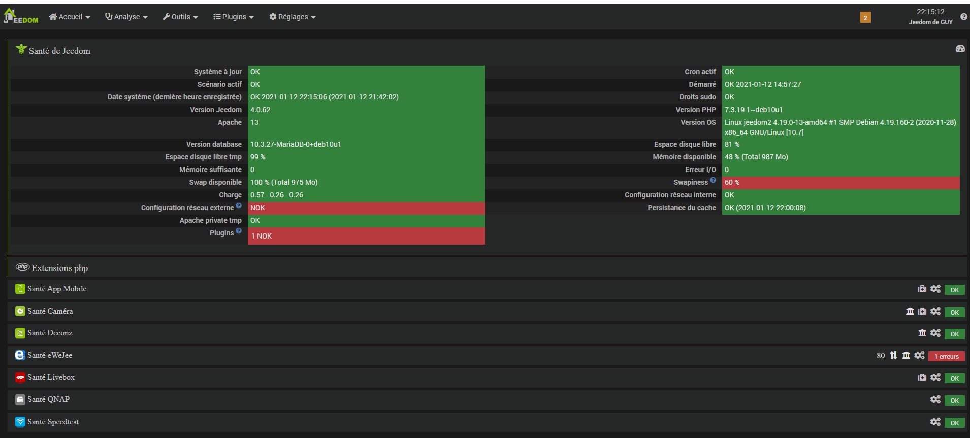

Voici le retour : ( j’ai vérifié le compte eweelink 2 fois )
node :
http://undefined:non SSL ? undefined
Serveur correctement lancé sur http://localhost:6005 Le Mon Jan 11 2021 13:40:08 GMT+0100 (GMT+01:00)
{"error":406,"sequence":"1610368806000"}
events.js:291
throw er; // Unhandled 'error' event
Error: getaddrinfo ENOTFOUND undefined
at GetAddrInfoReqWrap.onlookup [as oncomplete] (dns.js:66:26)
Emitted 'error' event on Request instance at:
at Request.onRequestError (/var/www/html/plugins/ewejee/core/js/node_modules/request/request.js:877:8)
at ClientRequest.emit (events.js:314:20)
at Socket.socketErrorListener (_http_client.js:427:9)
at Socket.emit (events.js:314:20)
at emitErrorNT (internal/streams/destroy.js:92:8)
at emitErrorAndCloseNT (internal/streams/destroy.js:60:3)
at processTicksAndRejections (internal/process/task_queues.js:84:21) {
errno: 'ENOTFOUND',
code: 'ENOTFOUND',
syscall: 'getaddrinfo',
hostname: 'undefined'
ewejee
[2021-01-11 13:50:06][INFO] : Lancement du démon.
[2021-01-11 13:51:03][DEBUG] : Demon LAN nok, server =
[2021-01-11 13:51:38][ERROR] : Impossible de lancer le démon. Avez vous choisis la configuration http/https dans la configuration du plugin ?
[2021-01-11 13:51:56][INFO] : Installation des dépendances
[2021-01-11 13:52:04][DEBUG] : Demon LAN nok, server =
LAN :
at internal/main/run_main_module.js:17:47
(node:2272) UnhandledPromiseRejectionWarning: Unhandled promise rejection. This error originated either by throwing inside of an async function without a catch block, or by rejecting a promise which was not handled with .catch(). To terminate the node process on unhandled promise rejection, use the CLI flag `--unhandled-rejections=strict` (see https://nodejs.org/api/cli.html#cli_unhandled_rejections_mode). (rejection id: 1)
(node:2272) [DEP0018] DeprecationWarning: Unhandled promise rejections are deprecated. In the future, promise rejections that are not handled will terminate the Node.js process with a non-zero exit code.
(node:2883) UnhandledPromiseRejectionWarning: Error: Invalid credentials provided
at new eWeLink (/var/www/html/plugins/ewejee/core/js/node_modules/ewelink-api/main.js:36:13)
at /var/www/html/plugins/ewejee/core/js/cache.js:18:24
at Object.<anonymous> (/var/www/html/plugins/ewejee/core/js/cache.js:31:2)
at Module._compile (internal/modules/cjs/loader.js:999:30)
at Object.Module._extensions..js (internal/modules/cjs/loader.js:1027:10)
at Module.load (internal/modules/cjs/loader.js:863:32)
at Function.Module._load (internal/modules/cjs/loader.js:708:14)
at Function.executeUserEntryPoint [as runMain] (internal/modules/run_main.js:60:12)
(node:2883) UnhandledPromiseRejectionWarning: Unhandled promise rejection. This error originated either by throwing inside of an async function without a catch block, or by rejecting a promise which was not handled with .catch(). To terminate the node process on unhandled promise rejection, use the CLI flag `--unhandled-rejections=strict` (see https://nodejs.org/api/cli.html#cli_unhandled_rejections_mode). (rejection id: 1)
(node:2883) [DEP0018] DeprecationWarning: Unhandled promise rejections are deprecated. In the future, promise rejections that are not handled will terminate the Node.js process with a non-zero exit code.

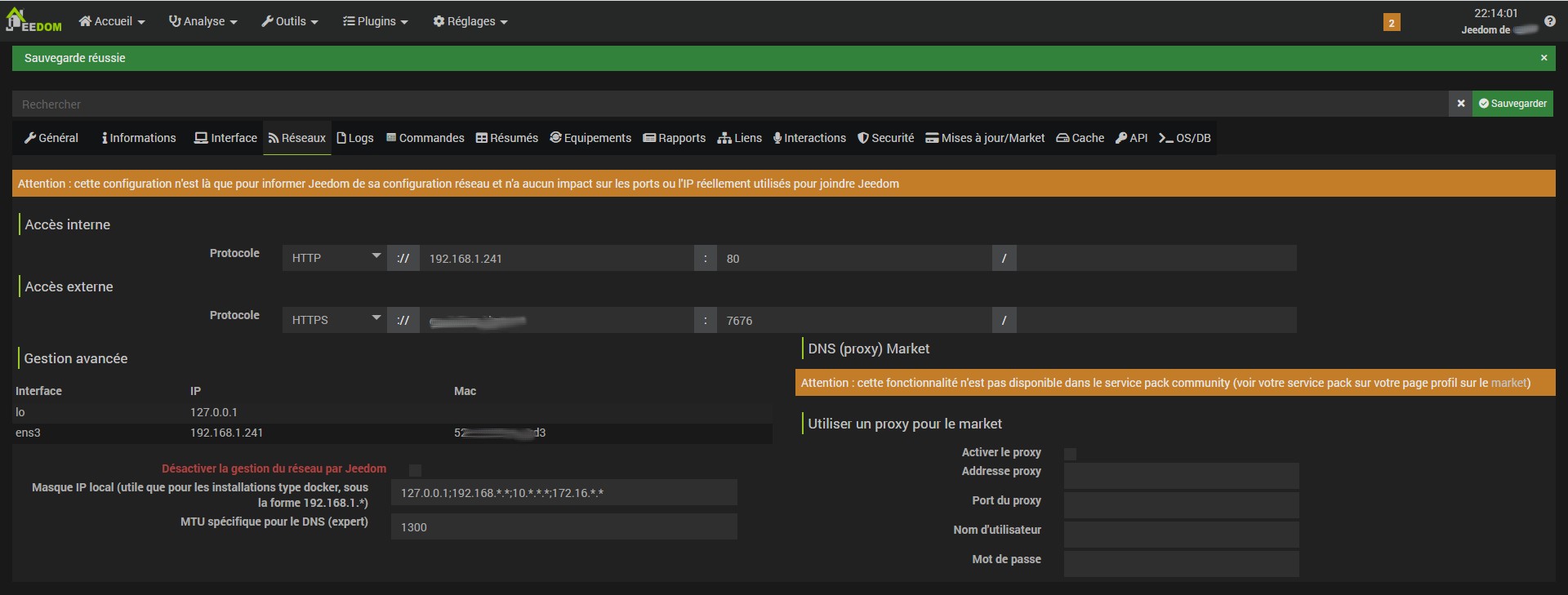

Tu la sûrement déjà fait, mais tu peux sauvegarder encore une fois, la configuration du plugin ?
Vu ta configuration réseau interne ok, je ne vois que ça
Bon, j’ai tout supprimé, réinstallé, vérifié le user/mdp ewelink … et toujours rien.
Je me demande si cela vient de ma VM … je vais voir si je passe sur un RPI … on verra.
Pour l’instant j’abandonne, je ne trouve rien dans les log même en débug.
Si qq’un a une piste …

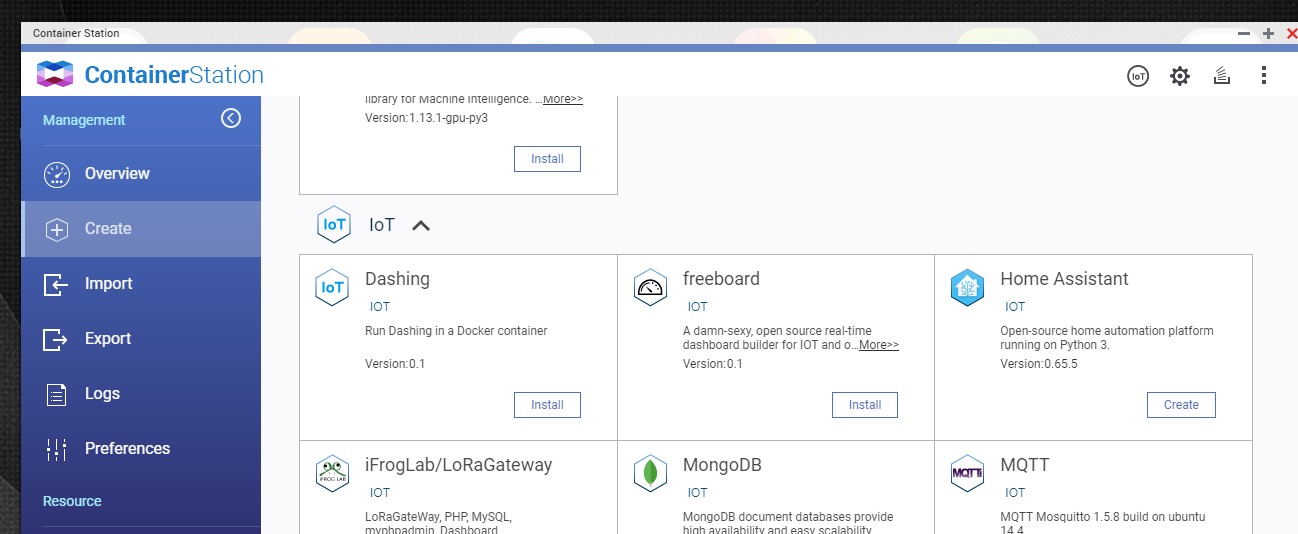

et un Rpi 4 4Go à 84 € … + ssd, c’est peut être plus stable ( si QNAP fait évoluer sa VM et que cela a des impacts … et je ne peux pas facilement isoler les systèmes les uns des autres.
