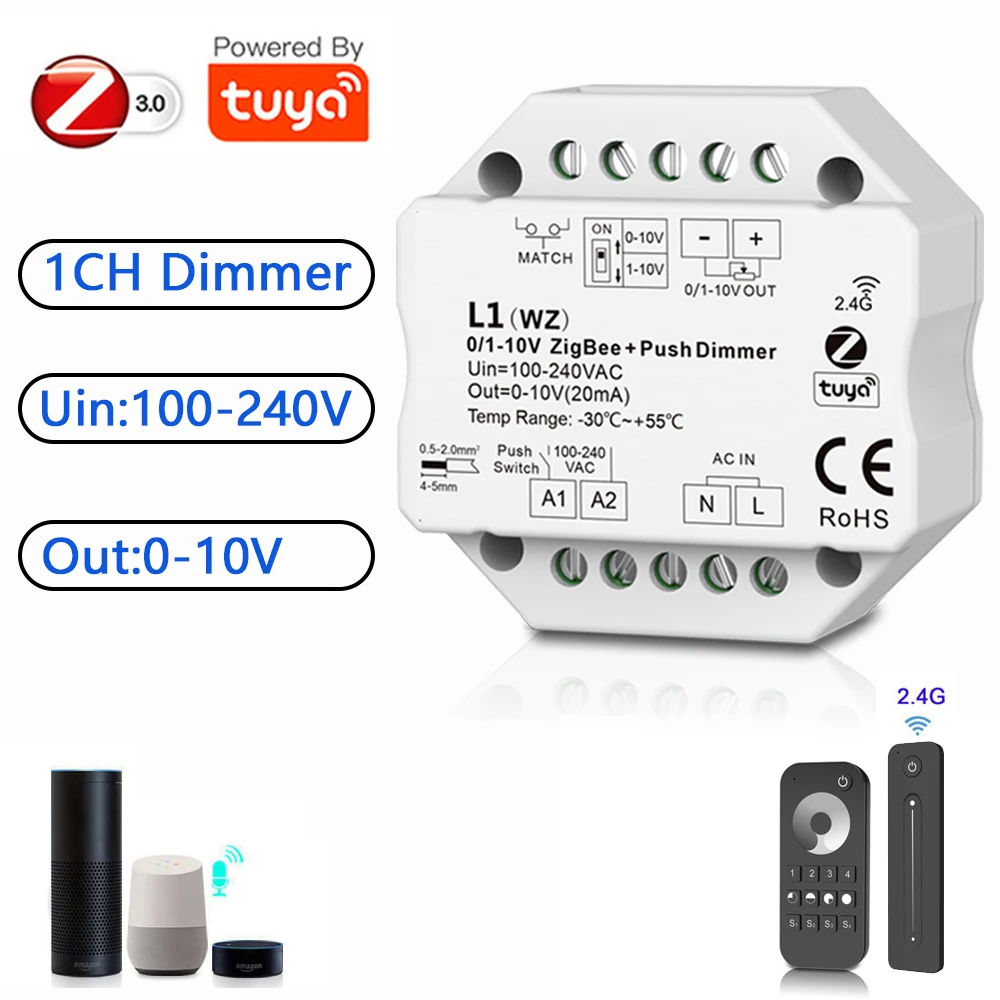

Hi, I purchased a Zigbee dimmer that allows 0-10v dimming, it seems that there a…re not many devices available on the Z2MQTT for that and is pretty interesting to dim led strips.
This is the device:
Thanks to the documentation I manage to make it work: On-Off + Dimming, but in the logs I see this payloads when the brightness is changed from Home Assistant:
