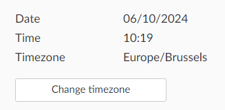

[1] Est-ce que le fuseau horaire entre phoscon et jeedom pourrait poser problème ?

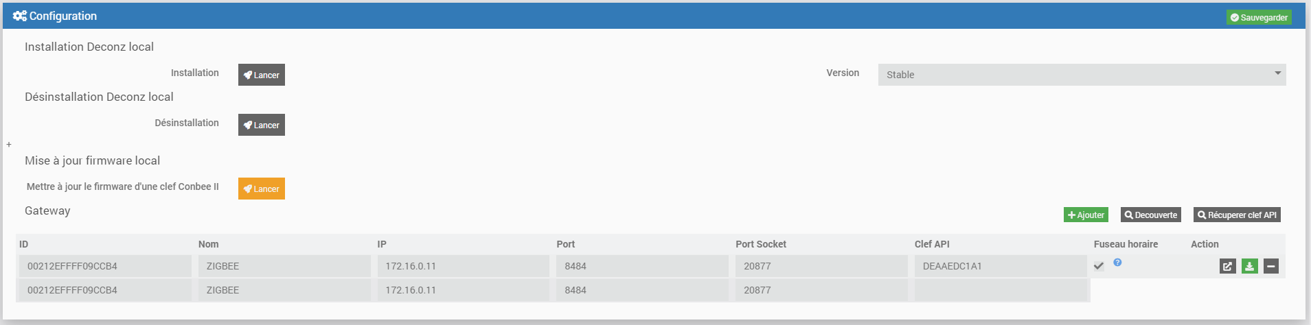

La conf sous jeedom :
La conf sous Phoscon :

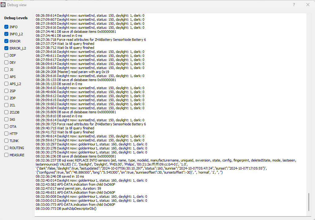

Je crois que j’avance doucement, j’ai installé Deconz sous Win et j’ai branché la clé dessus pour faire du debug lors de l’inclusion :
Est-ce que cela peut aider d’avantage ?
10:40:04:748 Daylight now: goldenHour1, status: 160, daylight: 1, dark: 0
10:40:14:756 Daylight now: goldenHour1, status: 160, daylight: 1, dark: 0
10:40:20:783 send permit join, duration: 59
10:40:24:750 Daylight now: goldenHour1, status: 160, daylight: 1, dark: 0
10:40:34:744 Daylight now: goldenHour1, status: 160, daylight: 1, dark: 0
10:40:40:787 sql exec SELECT conf FROM zbconf ORDER BY rowid desc limit 1
10:40:41:519 0x60EFABFFFED2738A 0x4C9F nwk changed to 0x76CF
10:40:41:527 APS-DATA.indication from child 0x76CF
10:40:41:527 DeviceAnnce of SensorNode: 0x60EFABFFFED2738A [1]
10:40:41:527 don't create binding for attribute reporting of sensor Battery 2
10:40:41:527 skip check bindings for client clusters (no group)
10:40:41:527 	nwk address changed 0x4C9F -> 0x76CF [2]
10:40:41:527 device announce 0x60EFABFFFED2738A (0x76CF) mac capabilities 0x80
10:40:41:528 set fast probe address to 0x60EFABFFFED2738A (0x76CF)
10:40:41:528 FP indication 0x0000 / 0x0013 (0x60EFABFFFED2738A / 0x76CF)
10:40:41:528                       ...     (0x60EFABFFFED2738A / 0x76CF)
10:40:41:528 device announce 0x60EFABFFFED2738A (0x76CF) mac capabilities 0x80
10:40:41:528 DEV Tick.Join: event/device.anounce
10:40:41:528 DEV Tick: fast poll 0x60EFABFFFED2738A, mac capabilities: 0x80
10:40:41:528 don't create binding for attribute reporting of sensor Battery 2
10:40:41:528 skip check bindings for client clusters (no group)
10:40:41:528 MAC poll fastEnddeviceProbe() 0x60EFABFFFED2738A
10:40:41:528 [1] get node descriptor for 0x60efabfffed2738a
10:40:41:528 ZDP get node descriptor for 0x76CF
10:40:41:620 don't create binding for attribute reporting of sensor Battery 2
10:40:41:620 MAC poll fastEnddeviceProbe() 0x60EFABFFFED2738A
10:40:41:620 wait response fastEnddeviceProbe() 0x60EFABFFFED2738A, elapsed 91 ms
10:40:41:621 skip check bindings for client clusters (no group)
10:40:41:628 don't create binding for attribute reporting of sensor Battery 2
10:40:41:628 MAC poll fastEnddeviceProbe() 0x60EFABFFFED2738A
10:40:41:628 wait response fastEnddeviceProbe() 0x60EFABFFFED2738A, elapsed 99 ms
10:40:41:628 skip check bindings for client clusters (no group)
10:40:41:629 don't create binding for attribute reporting of sensor Battery 2
10:40:41:629 MAC poll fastEnddeviceProbe() 0x60EFABFFFED2738A
10:40:41:629 wait response fastEnddeviceProbe() 0x60EFABFFFED2738A, elapsed 100 ms
10:40:41:629 skip check bindings for client clusters (no group)
10:40:41:637 APS-DATA.indication from child 0x76CF
10:40:41:637 DB pushZdpDescriptorDb()
10:40:41:638 FP indication 0x0000 / 0x8002 (0x60EFABFFFED2738A / 0x76CF)
10:40:41:638                       ...     (0x60EFABFFFED2738A / 0x76CF)
10:40:41:638 ZDP indication search sensors 0x60EFABFFFED2738A (0x76CF) cluster 0x8002
10:40:41:638 ZDP indication search sensors 0x60EFABFFFED2738A (0x76CF) clear timeout on cluster 0x8002
10:40:41:643 [2] get active endpoints for 0x60efabfffed2738a
10:40:41:643 ZDP get active endpoints for 0x76CF
10:40:41:774 don't create binding for attribute reporting of sensor Battery 2

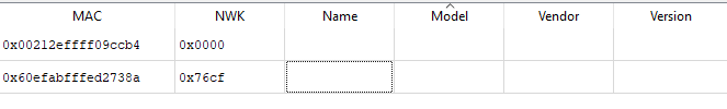

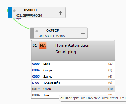

en terme de noeud du coup, je ne vois que ça :

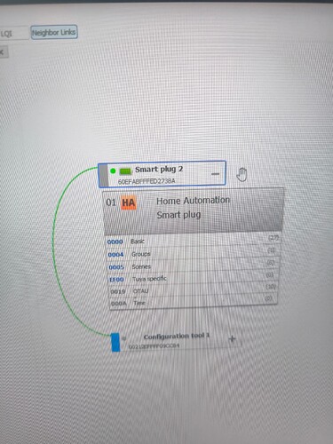

Je viens du coup de lancer un read simple descriptor dans Deconz Win, et voici ce que j’ai obtenu :
Dans DDF edit voici ce que j’ai du coup :

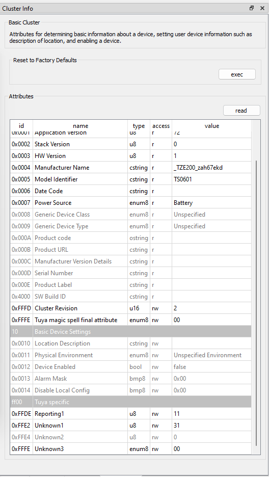

Un truc a faire, tu vires tout, tu utilises le GUI pour récuperer toutes les attributs du cluster « basic » 0x0000, et une fois que deconz connait toutes les infos, tu remets phoscon en permit join, et tu relances une lectures des attributs du même cluster ou une lectures des « descriptors », avec le clic doit sur le node. Ca va forcer une inclusion.
Si ca marche pas, tu peux laisser tomber.
Pour infos
et ect, c’est une scan de capteur, donc tu pourras avoir la batterie mais pas le volet.

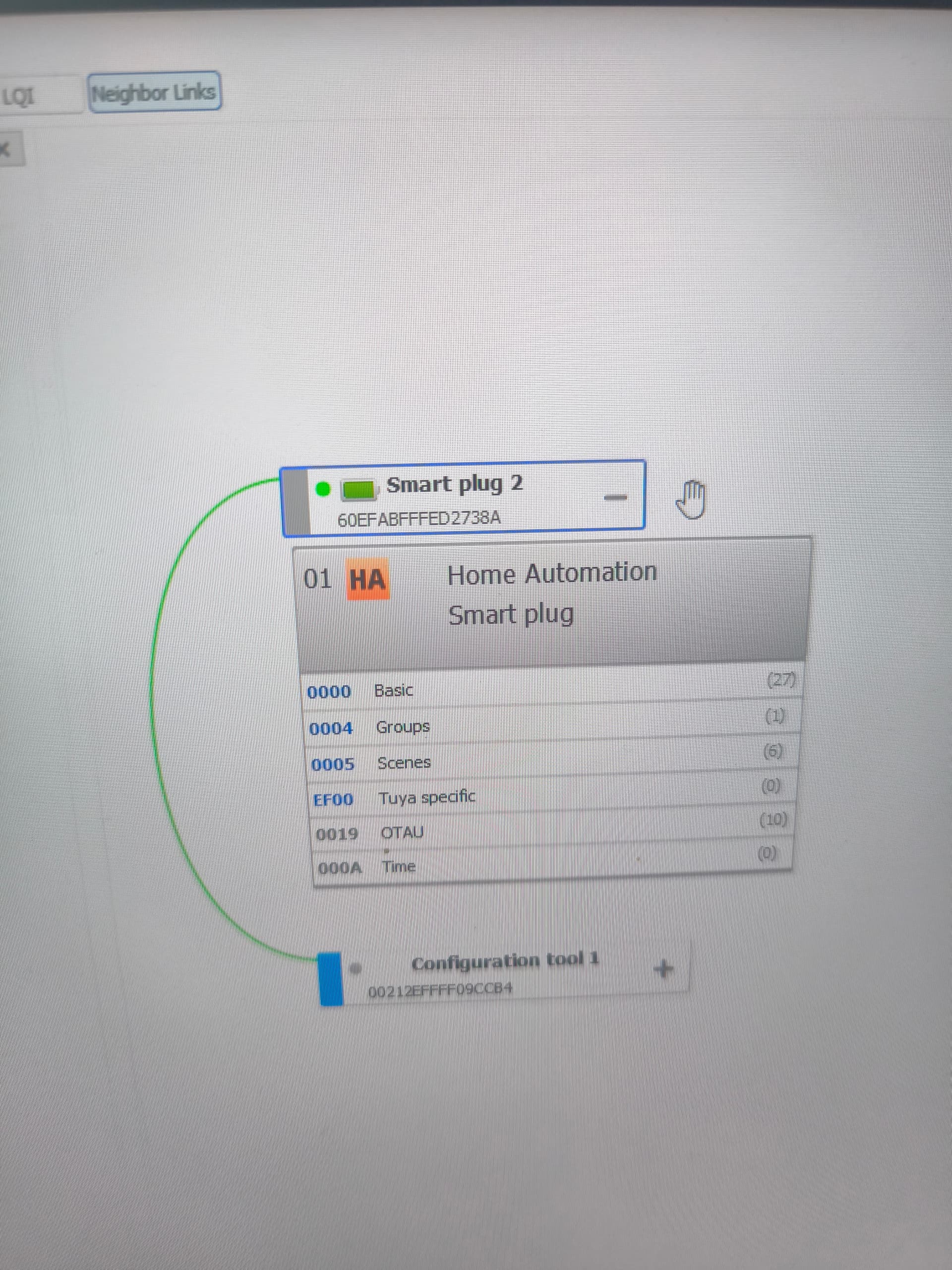

J’ai réussi à obtenir ceci après plusieurs dizaines de minutes…
sous deconz win…
J’ai remis la clé sur jeedom me disant c’est bon c’est réglé… Mais non…
Je vois bien le modèle et la marque du moteur sous jeedom :
Mais pas comme sous deconz win comme un smart plug…
Une idée ?
Même quand l’appareil est reconnu, il n y a pas de changement sur deconz. Deconz affiche la réalité, c’est un firmware de plug, la modification est uniquement dans l’API.
Il te faut cliquer sut le cluster « Basic », pour afficher les attributs et essayer la seconde manip.
Et un appareil peut être sous deconz (dans le réseau zigbee), mais pas dans leur API (non reconnu).

  • Remove your device using deconz
  • Select Basic Cluster « 0x0000 »
  • Ask for attributes, at least Manufacture name / Model ID.
  • When value are filled, set Phoscon in permit join
  • Return on deconz, right clic on node, use Request 1 7 8 (it’s keyboard shortcut)
  • With luck it will trigger the inclusion.

Activer le debug view et cocher les debugs suivants :

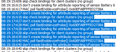

Appairer le moteur avec l’application (Control > Pairing)
Dans le debug view vous devriez avoir ces lignes a répétition :

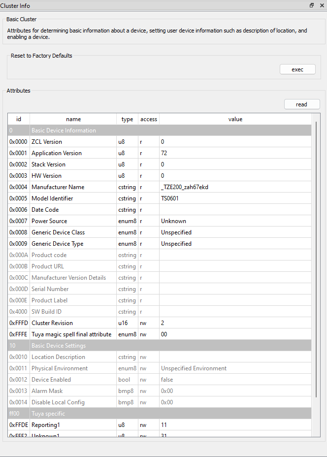

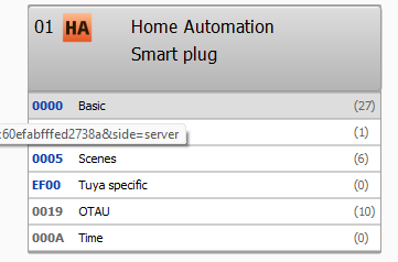

Ouvrir l’arborescence de la batterie trouvée et double cliquer sur basic 0x0000 :
Faire un Read dans la fenêtre Cluster Info jusqu’à avoir le nom du fabricant et le modele ID :

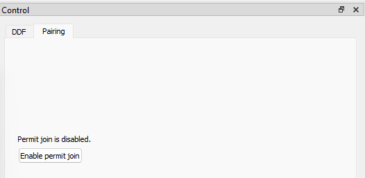

Relancer un Enable permit join dans l’onglet Control :

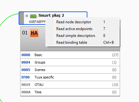

Clic-droit sur le module et faire successivement les fonction 1 puis 7 puis 8 :
(Attention, il se peut qu’il faille relance le permit join, veillez à ce qu’il ne soit pas terminé)
Normalement vous n’avez plus les lignes de debug en « don’t create binding »

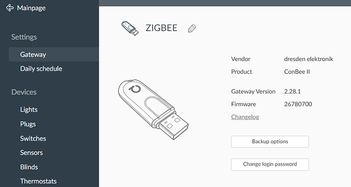

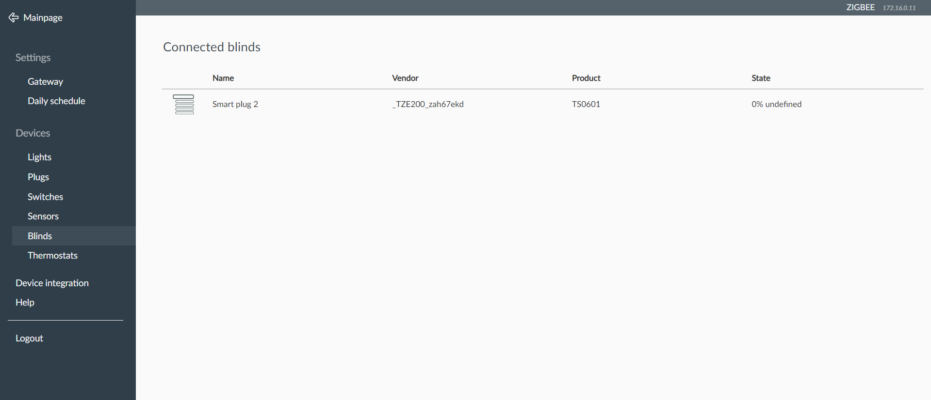

Aller dans Phoscon App (en haut à droite) pour contrôler que le module est devenu un blind :
Sauvegarde la conf de Phoscon App sur Windows l’exporter (fichier *.dat):

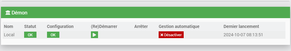

Reconnecter la clé à JEEDOM et relancer le demon de DECONZ pour être sûr que la clé est bien démarrée :
Aller sur Phoscon via l’icone du plugin DECONZ :
Charger la config exportée précédemment, la passerelle redémarre :
Relancer le demon du plugin DECONZ

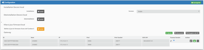

IMPORTANT : Remettre une passerelle avec les même données sans clé API, Sauvegarder et redémarrer le demon :

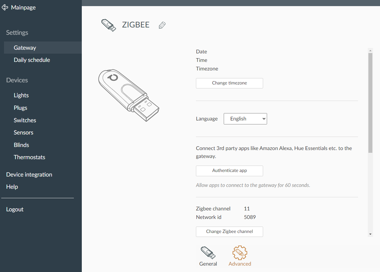

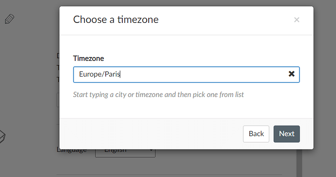

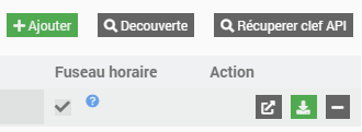

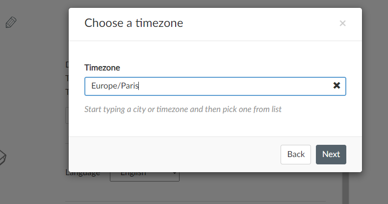

Aller dans Phoscon App via l’icone du plugin DECONZ et remettre le bon TimeZone :
IMPORTANT : refaire l’auth App entre Jeedom et Phoscon pour récuperer la clé API sinon vous aurez une erreur Auth Utilisateur à la synchro :

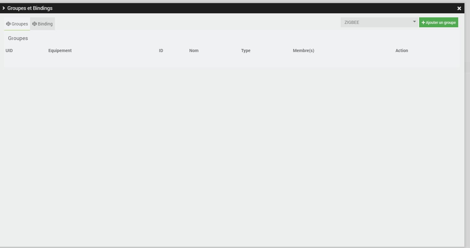

Dans les équipements de Deconz, supprimez tout puis synchronisez (ne pas oublier dans la fenetre (Groupe et binding) :

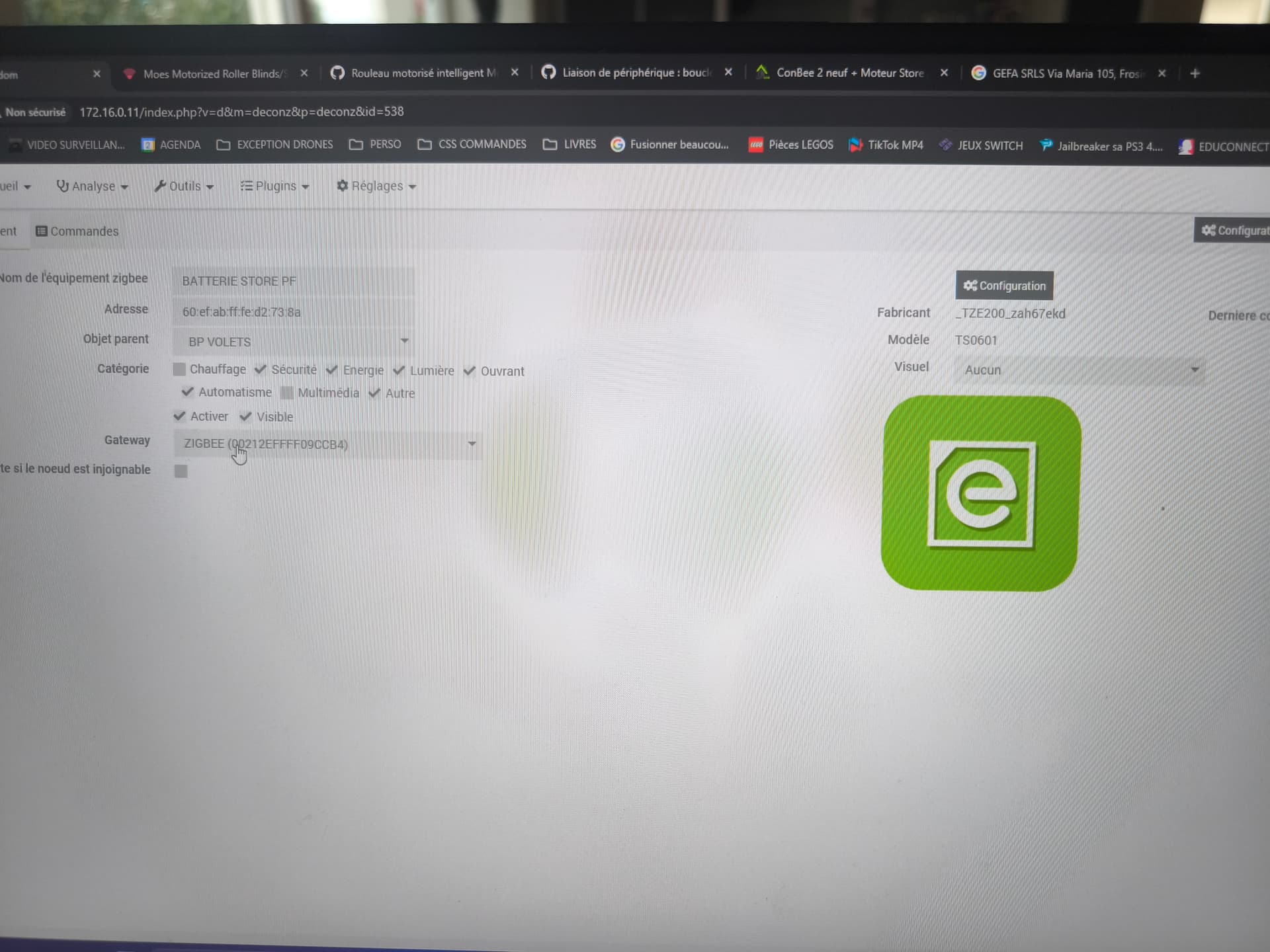

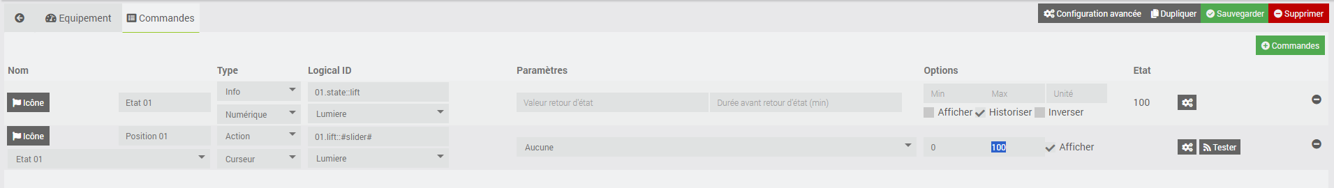

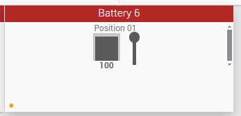

Le module est désormais intégré et reconnu, rendez le visible en cochant visible, MAIS IL FAUT MODIFIER UN PARAMETRE :
Le store est remonté sous le nom Batterie, mais possède bien les commandes nécessaires et le retour d’état, modifiez la valeur max du paramètre position à 100 au lieu de 255 :
