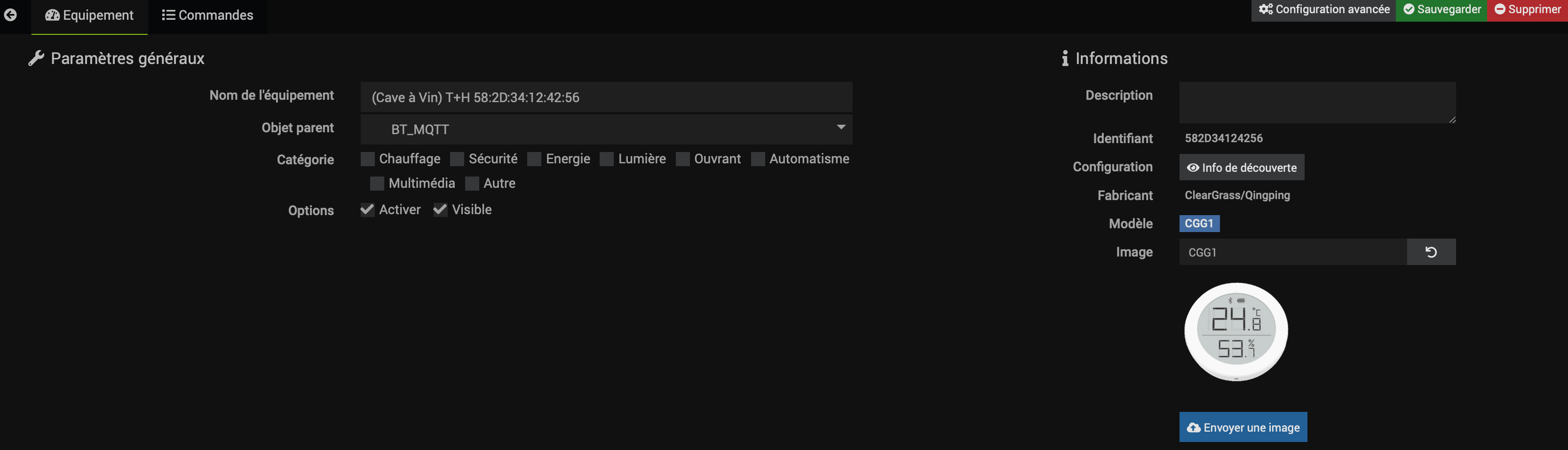

voilà le contenu, après réinstallation et donc configuration correcte du plugin j’ai ceci dans l’appareil ci dessus
{"sensor":{"582D34105499-tempc:
{"stat_t":"+/+/BTtoMQTT/582D34105499","dev_cla":"temperature","unit_of_meas":"°C","state_class":"measurement","name":"CGG1-tempc","uniq_id":"582D34105499-tempc","val_tpl":"{{ value_json.tempc | is_defined }}","device":{"ids":["582D34105499"],"cns":[["mac","582D34105499"]],"mf":"ClearGrass/Qingping","mdl":"CGG1","name":"Round TH-105499","via_device":"RPi0-BLEA-PARENTS"}},"582D34105499-hum":
{"stat_t":"+/+/BTtoMQTT/582D34105499","dev_cla":"humidity","unit_of_meas":"%","state_class":"measurement","name":"CGG1-hum","uniq_id":"582D34105499-hum","val_tpl":"{{ value_json.hum | is_defined }}","device":{"ids":["582D34105499"],"cns":[["mac","582D34105499"]],"mf":"ClearGrass/Qingping","mdl":"CGG1","name":"Round TH-105499","via_device":"RPi0-BLEA-PARENTS"}},"582D34105499-batt":
{"stat_t":"+/+/BTtoMQTT/582D34105499","dev_cla":"battery","unit_of_meas":"%","state_class":"measurement","name":"CGG1-batt","uniq_id":"582D34105499-batt","val_tpl":"{{ value_json.batt | is_defined }}","device":{"ids":["582D34105499"],"cns":[["mac","582D34105499"]],"mf":"ClearGrass/Qingping","mdl":"CGG1","name":"Round TH-105499","via_device":"RPi0-BLEA-PARENTS"}},"582D34105499-volt":
{"stat_t":"+/+/BTtoMQTT/582D34105499","dev_cla":"voltage","unit_of_meas":"V","state_class":"measurement","name":"CGG1-volt","uniq_id":"582D34105499-volt","val_tpl":"{{ value_json.volt | is_defined }}","device":{"ids":["582D34105499"],"cns":[["mac","582D34105499"]],"mf":"ClearGrass/Qingping","mdl":"CGG1","name":"Round TH-105499","via_device":"RPi0-BLEA-PARENTS"}}}}
