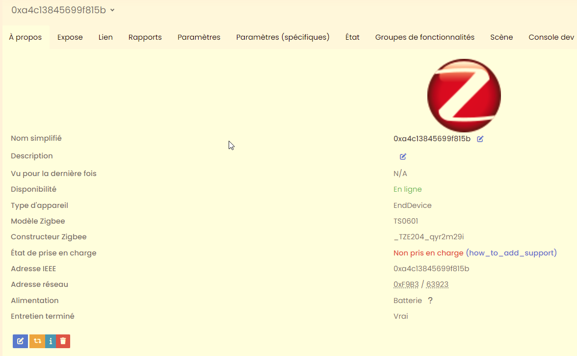

I bought one TRV from the page, and it was _TZE204_rtrmfadk - working great. So I bought some more from the same seller, and all are _TZE204_qyr2m29i. They look absolutely same, but does NOT work with the same converter. The best I could find is this.
