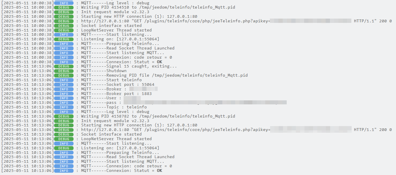

Exact pour « signal 15 », c’était un peu plus haut… Voici le log complet :
[2025-05-11 10:00:37] INFO  : SOCKET-READ------Passage des log du demon en mode debug
[2025-05-11 10:00:38] DEBUG  : MQTT------Signal 15 caught, exiting...
[2025-05-11 10:00:38] DEBUG  : MQTT------Shutdown
[2025-05-11 10:00:38] DEBUG  : MQTT------Removing PID file /tmp/jeedom/teleinfo/teleinfo_Mqtt.pid
[2025-05-11 10:00:38] INFO  : MQTT------Start teleinfo
[2025-05-11 10:00:38] INFO  : MQTT------Socket port : 55064
[2025-05-11 10:00:38] INFO  : MQTT------Broker : ***.***.***.***
[2025-05-11 10:00:38] INFO  : MQTT------Broker port : 1883
[2025-05-11 10:00:38] INFO  : MQTT------User : *******
[2025-05-11 10:00:38] INFO  : MQTT------pass : *****************
[2025-05-11 10:00:38] INFO  : MQTT------Topic : teleinfo
[2025-05-11 10:00:38] INFO  : MQTT------Log level : debug
[2025-05-11 10:00:38] DEBUG  : Writing PID 4154510 to /tmp/jeedom/teleinfo/teleinfo_Mqtt.pid
[2025-05-11 10:00:38] DEBUG  : Init request module v2.32.3
[2025-05-11 10:00:38] DEBUG  : Starting new HTTP connection (1): 127.0.0.1:80
[2025-05-11 10:00:38] DEBUG  : http://127.0.0.1:80 "GET /plugins/teleinfo/core/php/jeeTeleinfo.php?apikey=*********************** HTTP/1.1" 200 0
[2025-05-11 10:00:38] DEBUG  : Socket interface started
[2025-05-11 10:00:38] DEBUG  : LoopNetServer Thread started
[2025-05-11 10:00:38] INFO  : MQTT------Start listening...
[2025-05-11 10:00:38] DEBUG  : Listening on: [127.0.0.1:55064]
[2025-05-11 10:00:38] INFO  : MQTT------Preparing Teleinfo...
[2025-05-11 10:00:38] INFO  : MQTT------Read Socket Thread Launched
[2025-05-11 10:00:38] INFO  : MQTT------Start listening MQTT...
[2025-05-11 10:00:38] INFO  : MQTT------Connexion: code retour = 0
[2025-05-11 10:00:38] INFO  : MQTT------Connexion: Statut = OK
[2025-05-11 10:13:06] DEBUG  : MQTT------Signal 15 caught, exiting...
[2025-05-11 10:13:06] DEBUG  : MQTT------Shutdown
[2025-05-11 10:13:06] DEBUG  : MQTT------Removing PID file /tmp/jeedom/teleinfo/teleinfo_Mqtt.pid
[2025-05-11 10:13:06] INFO  : MQTT------Start teleinfo
[2025-05-11 10:13:06] INFO  : MQTT------Socket port : 55064
[2025-05-11 10:13:06] INFO  : MQTT------Broker : ***.***.***.***
[2025-05-11 10:13:06] INFO  : MQTT------Broker port : 1883
[2025-05-11 10:13:06] INFO  : MQTT------User : ********
[2025-05-11 10:13:06] INFO  : MQTT------pass : ****************
[2025-05-11 10:13:06] INFO  : MQTT------Topic : teleinfo
[2025-05-11 10:13:06] INFO  : MQTT------Log level : debug
[2025-05-11 10:13:06] DEBUG  : Writing PID 4158782 to /tmp/jeedom/teleinfo/teleinfo_Mqtt.pid
[2025-05-11 10:13:06] DEBUG  : Init request module v2.32.3
[2025-05-11 10:13:06] DEBUG  : Starting new HTTP connection (1): 127.0.0.1:80
[2025-05-11 10:13:06] DEBUG  : http://127.0.0.1:80 "GET /plugins/teleinfo/core/php/jeeTeleinfo.php?apikey=******************* HTTP/1.1" 200 0
[2025-05-11 10:13:06] DEBUG  : Socket interface started
[2025-05-11 10:13:06] DEBUG  : LoopNetServer Thread started
[2025-05-11 10:13:06] INFO  : MQTT------Start listening...
[2025-05-11 10:13:06] DEBUG  : Listening on: [127.0.0.1:55064]
[2025-05-11 10:13:06] INFO  : MQTT------Preparing Teleinfo...
[2025-05-11 10:13:06] INFO  : MQTT------Read Socket Thread Launched
[2025-05-11 10:13:06] INFO  : MQTT------Start listening MQTT...
[2025-05-11 10:13:06] INFO  : MQTT------Connexion: code retour = 0
[2025-05-11 10:13:06] INFO  : MQTT------Connexion: Statut = OK

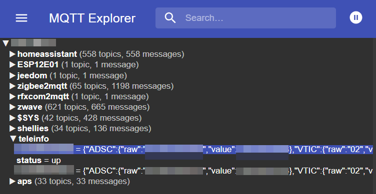

tu as vérifié tes identifiants de connexion au broker? Je sais que ça fonctionnait avant mais on ne sait jamais… Est ce qu’avec un logiciel comme mqtt explorer tu te connectes bien au broker et tu vois bien le topic teleinfo?
Oui tout est OK, d’ailleurs MQTT Manager utilise les mêmes paramètres que Teleinfo. J’ai re-copié / collé le mot de passe et je viens de tester avec un autre compte MQTT mais idem…
J’utilise MQTT en long et en large, le reste ne pose pas de pb :

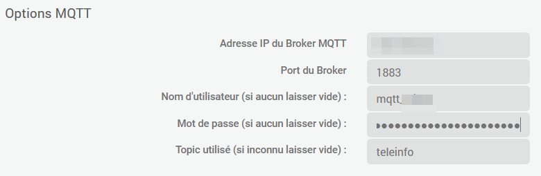

Je reste bloqué sur la dernière valeur avant MAJ du plugin… :
pour le topic il faut que tu y mettes teleinfo/# , je ne sais pas pourquoi ça marchait avant mais cela n’aurait pas dû
Super, ça a marché ! J’ai mis « teleinfo » ce matin en espérant que ça résolve (avant c’était vide) mais j’imagine que je n’aurais pas dû. En tout cas je te remercie sincèrement pour ton aide rapide et efficace.
