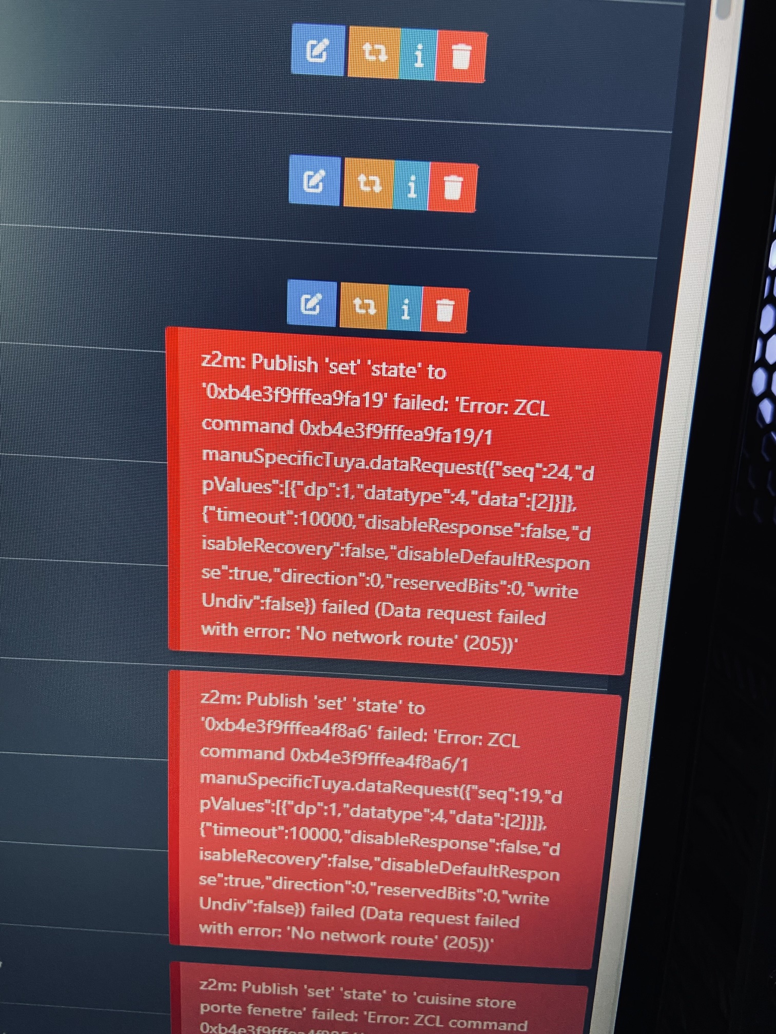

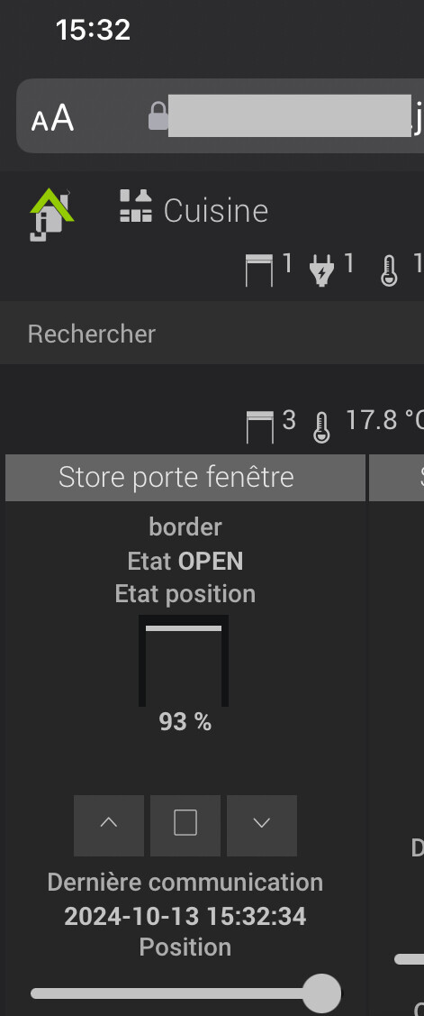

Depuis quelques jours certains de mes stores en zigbee ne réagisse plus.
Ils reçoivent bien la commande ( voir dernière communication) mais ne bouge pas.
Sur zigbee2mqtt j’ai ceci:
Auriez vous une piste ?
Merci d’avance

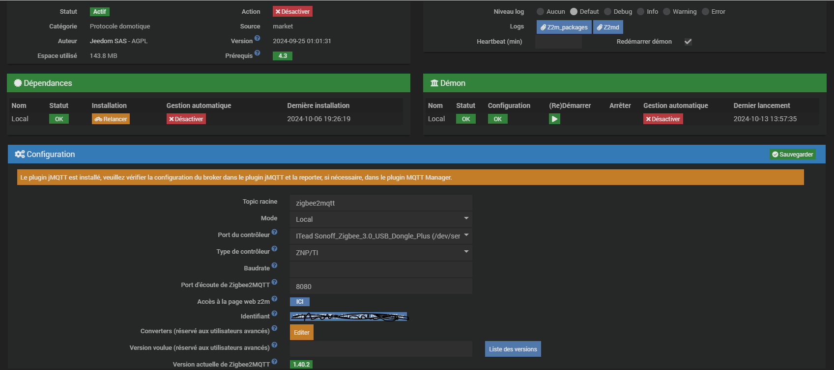

Aucune version de donnée ni pour le core ni le plugin

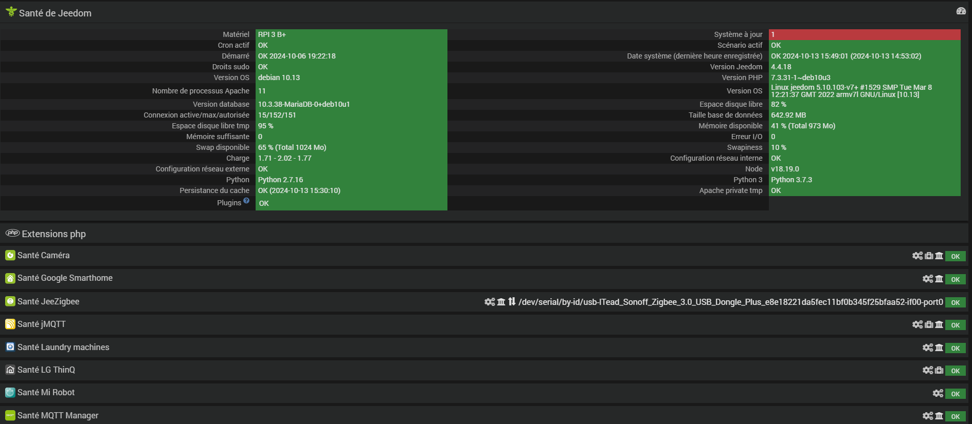

Pas de page santé et aucun log
Expliquez moi comment quelqu’un va faire un diagnostic ?

désolé, voici les infos:
les derniers logs de jeezigbee ( default):
[2024-10-13 15:34:07] e[31merrore[39m: z2m: Publish 'set' 'state' to 'cuisine store porte fenetre' failed: 'Error: ZCL command 0xb4e3f9fffea4f885/1 manuSpecificTuya.dataRequest({"seq":18,"dpValues":[{"dp":1,"datatype":4,"data":[0]}]}, {"timeout":10000,"disableResponse":false,"disableRecovery":false,"disableDefaultResponse":true,"direction":0,"reservedBits":0,"writeUndiv":false}) failed (Data request failed with error: 'No network route' (205))'
[2024-10-13 15:34:24] e[31merrore[39m: z2m: Publish 'set' 'state' to 'cuisine store porte fenetre' failed: 'Error: ZCL command 0xb4e3f9fffea4f885/1 manuSpecificTuya.dataRequest({"seq":25,"dpValues":[{"dp":1,"datatype":4,"data":[2]}]}, {"timeout":10000,"disableResponse":false,"disableRecovery":false,"disableDefaultResponse":true,"direction":0,"reservedBits":0,"writeUndiv":false}) failed (Data request failed with error: 'No network route' (205))'
[2024-10-13 15:34:45] e[31merrore[39m: z2m: Publish 'set' 'state' to 'cuisine store porte fenetre' failed: 'Error: ZCL command 0xb4e3f9fffea4f885/1 manuSpecificTuya.dataRequest({"seq":26,"dpValues":[{"dp":1,"datatype":4,"data":[2]}]}, {"timeout":10000,"disableResponse":false,"disableRecovery":false,"disableDefaultResponse":true,"direction":0,"reservedBits":0,"writeUndiv":false}) failed (Data request failed with error: 'No network route' (205))'
[2024-10-13 15:44:01] e[31merrore[39m: zh:controller:device: Read response to 0xa4c13840eda27d41 failed (ZCL command 0xa4c13840eda27d41/1 genTime.readRsp({"localTime":782149428}, {"timeout":10000,"disableResponse":false,"disableRecovery":false,"disableDefaultResponse":true,"direction":1,"srcEndpoint":1,"reservedBits":0,"transactionSequenceNumber":107,"writeUndiv":false}) failed (Data request failed with error: 'No network route' (205)))
[2024-10-13 15:44:15] e[31merrore[39m: zh:controller:device: Read response to 0xa4c13840eda27d41 failed (ZCL command 0xa4c13840eda27d41/1 genTime.readRsp({"localTime":782149430}, {"timeout":10000,"disableResponse":false,"disableRecovery":false,"disableDefaultResponse":true,"direction":1,"srcEndpoint":1,"reservedBits":0,"transactionSequenceNumber":107,"writeUndiv":false}) failed (Data request failed with error: 'No network route' (205)))
[2024-10-13 15:50:25] e[31merrore[39m: z2m: Publish 'set' 'state' to 'cuisine store porte fenetre' failed: 'Error: ZCL command 0xb4e3f9fffea4f885/1 manuSpecificTuya.dataRequest({"seq":30,"dpValues":[{"dp":1,"datatype":4,"data":[2]}]}, {"timeout":10000,"disableResponse":false,"disableRecovery":false,"disableDefaultResponse":true,"direction":0,"reservedBits":0,"writeUndiv":false}) failed (Data request failed with error: 'No network route' (205))'
[2024-10-13 15:50:25] e[31merrore[39m: z2m: Publish 'set' 'state' to '0xb4e3f9fffea9fa19' failed: 'Error: ZCL command 0xb4e3f9fffea9fa19/1 manuSpecificTuya.dataRequest({"seq":32,"dpValues":[{"dp":1,"datatype":4,"data":[2]}]}, {"timeout":10000,"disableResponse":false,"disableRecovery":false,"disableDefaultResponse":true,"direction":0,"reservedBits":0,"writeUndiv":false}) failed (Data request failed with error: 'No network route' (205))'
[2024-10-13 15:50:27] e[31merrore[39m: z2m: Publish 'set' 'state' to '0xb4e3f9fffea4f8a6' failed: 'Error: ZCL command 0xb4e3f9fffea4f8a6/1 manuSpecificTuya.dataRequest({"seq":31,"dpValues":[{"dp":1,"datatype":4,"data":[2]}]}, {"timeout":10000,"disableResponse":false,"disableRecovery":false,"disableDefaultResponse":true,"direction":0,"reservedBits":0,"writeUndiv":false}) failed (Data request failed with error: 'No network route' (205))'

Non. Quelle version de firmware pour la clé?
Par contre vous êtes en debian 10, il faut penser à passer au 11. Et votre charge est très élevé pour un pi3+.
