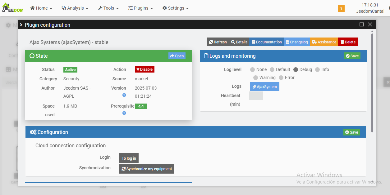

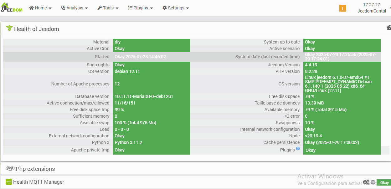

I see many posts with the same question, but I can’t solve my issue with the replies. I can arm/disarm the alarm without issues, but I get no updates on any sensor, including alarm status, unless I manually force a synchronization. I installed it 2 days ago.
As suggested in other threads I have removed and reinstall the plugin which made no difference. I have also activated debug in the plugin logs but I get no additional information.
Here I paste an image of the plugin main page and the jeedom health, both seem good to me.
Can anyone help me or suggest me what to do next?

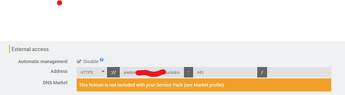

Is your Jeedom accessible from outside via https?
Hello!

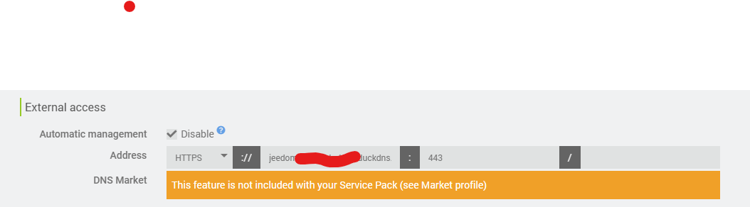

It was not, as I was not aware that it was necessary. Now it is, I can access it from outside through https and I have addded it to the configuration, as it can be seen in the screenshot attached (does automatic management need to be enabled?)
I have tried now and the plugin is still not working. After setting up https I have uninstalled and reinstalled again with no luck.
Any other thing I can check?
