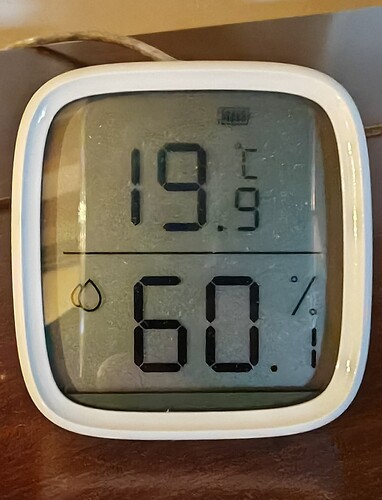

I use Zigbee2MQTT as an addon with Home Assistant OS on Ra…sbPi 4.
I tried to pair a Sonoff SNZB-02D Smart Temperature Humidity Sensor.
It failed to pair and the device is listed as not supported.
Another SNZB-02D (the same delivery) paired successfully.
I tried several things:
* Tried to delete the device after fail (which fails too)
* Forcefully deleted the device before the next try
* Connect the adapter with extension cable to the pi
* Place the Sensor very close to the adapter
* Reset the Sensor by removing the battery several times
* Replaced the battery
* Tried to keep the Sensor alive by tapping the pairing button every 2 to 3 seconds
* Tried to pair via a Philips Hue bulb in another room
* Restarted Home Assistent and the whole pi
* Un- and re-pugged the adapter
