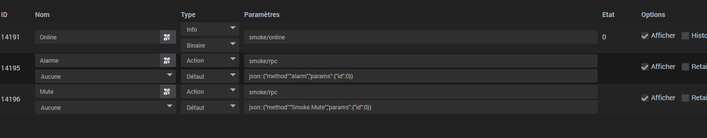

J’ai un Shelly Plus Smoke en détecteur de fumée.
J’ai bien configuré le bignou pour le Mqtt et j’ai réussi à obtenir l’état Online dans MQTT Manager
Je souhaite à présent pouvoir avoir le status de l’alarme et la couper si elle se déclenche
Mais je n’arrive à rien

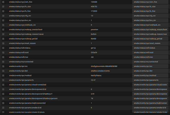

Voici le log dans mqtt manager
3143|[2024-02-11 08:45:55] DEBUG  : Received message on topic : shellies/smoke/online => true
3144|[2024-02-11 08:45:55] DEBUG  : Received message on topic : shellies/smoke/status/ble => {}
3145|[2024-02-11 08:45:55] DEBUG  : Received message on topic : shellies/smoke/status/cloud => {"connected":false}
3146|[2024-02-11 08:45:55] DEBUG  : Received message on topic : shellies/smoke/status/devicepower:0 => {"id": 0,"battery":{"V":2.99, "percent":98}}
3148|[2024-02-11 08:45:55] DEBUG  : Received message on topic : shellies/smoke/status/mqtt => {"connected":true}
3149|[2024-02-11 08:45:55] DEBUG  : Received message on topic : shellies/smoke/status/smoke:0 => {"id":0,"alarm":false, "mute":false}
3151|[2024-02-11 08:45:55] DEBUG  : Received message on topic : shellies/smoke/status/wifi => {"sta_ip":"192.168.1.62","status":"got ip","ssid":"GiGa24","rssi":-54}
3152|[2024-02-11 08:45:55] DEBUG  : Received message on topic : shellies/smoke/status/ws => {"connected":false}
3154|[2024-02-11 08:45:55] DEBUG  : Received message on topic : shellies/smoke/status/mqtt => {"connected":true}
3155|[2024-02-11 08:45:55] DEBUG  : Received message on topic : shellies/smoke/events/rpc => {"src":"shellyplussmoke-80646fd08588","dst":"shellies/smoke/events","method":"NotifyFullStatus","params":{"ts":1.56,"ble":{},"cloud":{"connected":false},"devicepower:0":{"id": 0,"battery":{"V":2.99, "percent":98}},"mqtt":{"connected":true},"smoke:0":{"id":0,"alarm":false, "mute":false},"sys":{"mac":"80646FD08588","restart_required":false,"time":null,"unixtime":null,"uptime":1,"ram_size":262444,"ram_free":155144,"fs_size":458752,"fs_free":172032,"cfg_rev":13,"kvs_rev":1,"webhook_rev":0,"available_updates":{},"wakeup_reason":{"boot":"poweron","cause":"undefined"},"wakeup_period":86400,"reset_reason":1},"wifi":{"sta_ip":"192.168.1.62","status":"got ip","ssid":"GiGa24","rssi":-54},"ws":{"connected":false}}}
3156|[2024-02-11 08:45:55] DEBUG  : Received message on topic : shellies/smoke/events/rpc => {"src":"shellyplussmoke-80646fd08588","dst":"shellies/smoke/events","method":"NotifyStatus","params":{"ts":1.56,"mqtt":{"connected":true}}}
3197|[2024-02-11 08:45:58] DEBUG  : Received message on topic : shellies/smoke/events/rpc => {"src":"shellyplussmoke-80646fd08588","dst":"shellies/smoke/events","method":"NotifyStatus","params":{"ts":1707641158.21,"smoke:0":{"id":0,"alarm":true}}}
3198|[2024-02-11 08:45:58] DEBUG  : Received message on topic : shellies/smoke/status/smoke:0 => {"id":0,"alarm":true, "mute":false}
3199|[2024-02-11 08:45:58] DEBUG  : Received message on topic : shellies/smoke/status/sys => {"mac":"80646FD08588","restart_required":false,"time":"09:45","unixtime":1707641158,"uptime":3,"ram_size":262408,"ram_free":154876,"fs_size":458752,"fs_free":172032,"cfg_rev":13,"kvs_rev":1,"webhook_rev":0,"available_updates":{},"wakeup_reason":{"boot":"poweron","cause":"alarm"},"wakeup_period":86400,"reset_reason":1}
3200|[2024-02-11 08:45:58] DEBUG  : Received message on topic : shellies/smoke/events/rpc => {"src":"shellyplussmoke-80646fd08588","dst":"shellies/smoke/events","method":"NotifyStatus","params":{"ts":1707641158.21,"sys":{"wakeup_reason":{"cause":"alarm"}}}}
3505|[2024-02-11 08:46:06] DEBUG  : Received message on topic : shellies/smoke/events/rpc => {"src":"shellyplussmoke-80646fd08588","dst":"shellies/smoke/events","method":"NotifyStatus","params":{"ts":1707641166.75,"sys":{"available_updates":{"beta":{"version":"1.2.0-beta1"}}}}}
3507|[2024-02-11 08:46:06] DEBUG  : Received message on topic : shellies/smoke/status/sys => {"mac":"80646FD08588","restart_required":false,"time":"09:46","unixtime":1707641166,"uptime":12,"ram_size":262388,"ram_free":153968,"fs_size":458752,"fs_free":172032,"cfg_rev":13,"kvs_rev":1,"webhook_rev":0,"available_updates":{"beta":{"version":"1.2.0-beta1"}},"wakeup_reason":{"boot":"poweron","cause":"alarm"},"wakeup_period":86400,"reset_reason":1}
3974|[2024-02-11 08:46:24] DEBUG  : Received message on topic : shellies/smoke/events/rpc => {"src":"shellyplussmoke-80646fd08588","dst":"shellies/smoke/events","method":"NotifyStatus","params":{"ts":1707641184.37,"smoke:0":{"id":0,"mute":true}}}
3975|[2024-02-11 08:46:24] DEBUG  : Received message on topic : shellies/smoke/status/smoke:0 => {"id":0,"alarm":true, "mute":true}
7799|[2024-02-11 08:48:20] DEBUG  : Received message on topic : shellies/smoke/events/rpc => {"src":"shellyplussmoke-80646fd08588","dst":"shellies/smoke/events","method":"NotifyStatus","params":{"ts":1707641300.25,"smoke:0":{"id":0,"alarm":false}}}
7800|[2024-02-11 08:48:20] DEBUG  : Received message on topic : shellies/smoke/status/smoke:0 => {"id":0,"alarm":false, "mute":true}
7840|[2024-02-11 08:48:20] DEBUG  : Received message on topic : shellies/smoke/online => false

Donc le Online fonctionne, mute aussi on le voit dans les logs
Par contre l’état alarme non mais j’ai mis une action ca devrait etre une info non ?
Info
