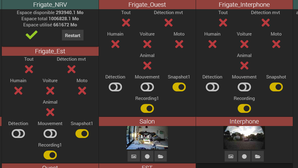

aprés quelques tests , un premier retour :
  1. je n’ai que 3 caméras qui sont remonté alors que dans les log j’en voie 4

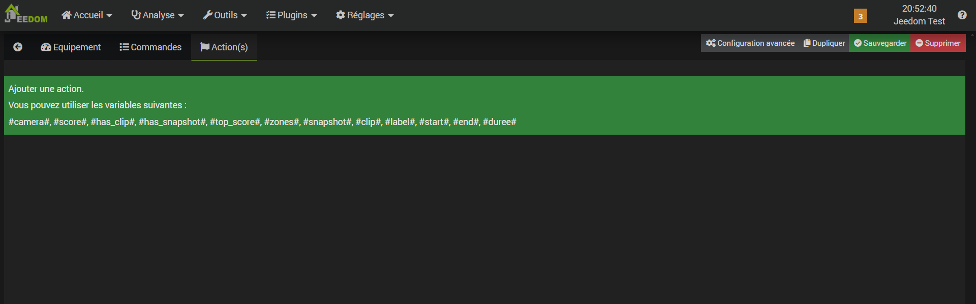

  1. je ne trouve pas les actions comme nous avons sur mqtt.
  2. comment creer des actions sans boutons :slight_smile: :grin:

Toute la div verte est un bouton :grin:

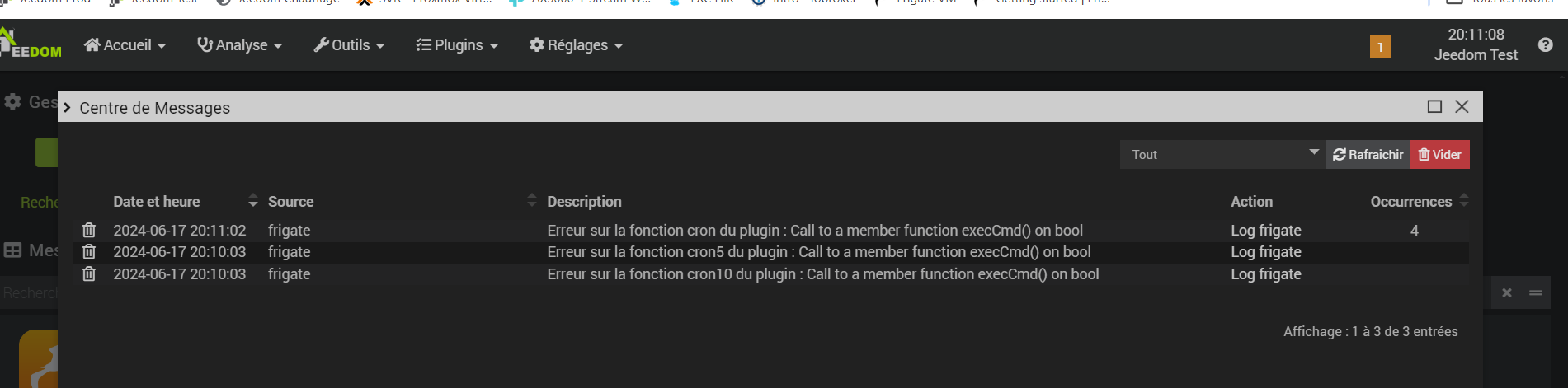

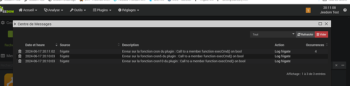

et une nouvelle erreur
[2024-06-17 20:08:02] ERROR  : Erreur sur la fonction cron du plugin : Call to a member function execCmd() on bool
[2024-06-17 20:08:34] DEBUG  : create eqCameras : mise à jour.
[2024-06-17 20:08:34] DEBUG  : Liste de cameras : {"EST":{"audio_dBFS":0,"audio_rms":0,"camera_fps":30,"capture_pid":483,"detection_enabled":0,"detection_fps":0,"ffmpeg_pid":491,"pid":462,"process_fps":30,"skipped_fps":0},"INTERPHONE":{"audio_dBFS":0,"audio_rms":0,"camera_fps":0,"capture_pid":479,"detection_enabled":0,"detection_fps":0,"ffmpeg_pid":1390,"pid":459,"process_fps":0,"skipped_fps":0},"OUEST":{"audio_dBFS":0,"audio_rms":0,"camera_fps":30.1,"capture_pid":467,"detection_enabled":1,"detection_fps":20.4,"ffmpeg_pid":480,"pid":456,"process_fps":20.4,"skipped_fps":9.7},"SALON":{"audio_dBFS":0,"audio_rms":0,"camera_fps":30.1,"capture_pid":488,"detection_enabled":0,"detection_fps":0,"ffmpeg_pid":495,"pid":464,"process_fps":30.1,"skipped_fps":0}}
[2024-06-17 20:09:01] ERROR  : Erreur sur la fonction cron du plugin : Call to a member function execCmd() on bool
[2024-06-17 20:09:38] DEBUG  : create eqCameras : mise à jour.
[2024-06-17 20:09:38] DEBUG  : Liste de cameras : {"EST":{"audio_dBFS":0,"audio_rms":0,"camera_fps":30,"capture_pid":483,"detection_enabled":0,"detection_fps":0,"ffmpeg_pid":491,"pid":462,"process_fps":30,"skipped_fps":0},"INTERPHONE":{"audio_dBFS":0,"audio_rms":0,"camera_fps":0,"capture_pid":479,"detection_enabled":0,"detection_fps":0,"ffmpeg_pid":1666,"pid":459,"process_fps":0,"skipped_fps":0},"OUEST":{"audio_dBFS":0,"audio_rms":0,"camera_fps":30.1,"capture_pid":467,"detection_enabled":1,"detection_fps":12.2,"ffmpeg_pid":480,"pid":456,"process_fps":27.9,"skipped_fps":2.2},"SALON":{"audio_dBFS":0,"audio_rms":0,"camera_fps":30,"capture_pid":488,"detection_enabled":0,"detection_fps":0,"ffmpeg_pid":495,"pid":464,"process_fps":30,"skipped_fps":0}}
[2024-06-17 20:10:03] ERROR  : Erreur sur la fonction cron du plugin : Call to a member function execCmd() on bool
[2024-06-17 20:10:03] ERROR  : Erreur sur la fonction cron10 du plugin : Call to a member function execCmd() on bool
[2024-06-17 20:10:03] ERROR  : Erreur sur la fonction cron5 du plugin : Call to a member function execCmd() on bool

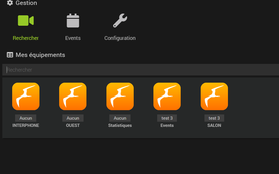

J’ai fait la mise à jour (2024-06-18 09:22:32)
J’ai supprimé la caméra (j’en ai 4 dans frigate)
J’ai fait une recherche
J’ai toujours une seule caméra :unamused:

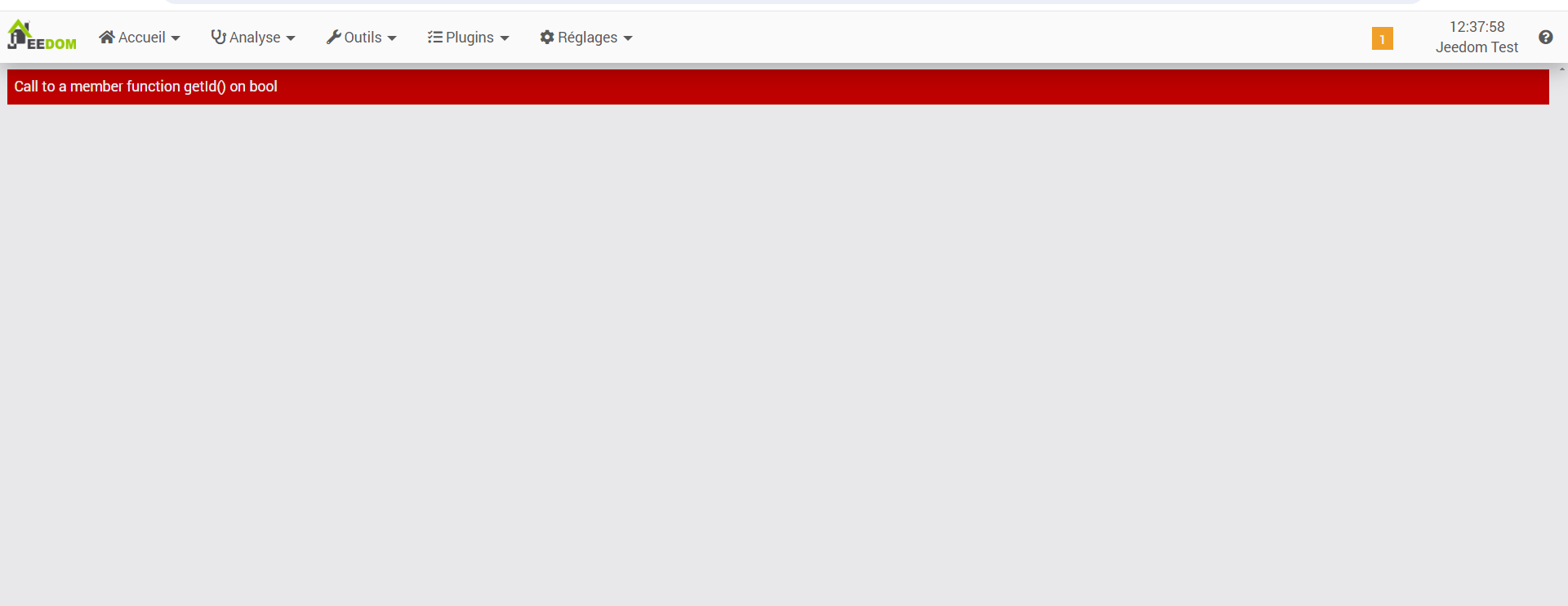

[2024-06-18 09:30:09] ERROR  : Erreur sur la fonction cron5 du plugin : Call to a member function getId() on bool
:vulcan_salute:
Edit
en mode debug c’est bien aussi :wink:
[2024-06-18 10:05:15] ERROR  : Erreur sur la fonction cron5 du plugin : Call to a member function getId() on bool

[2024-06-18 10:10:18] ERROR  : Erreur sur la fonction cron5 du plugin : Call to a member function getId() on bool
Mais l’équipement porche n’est pas crée et j’ai toujours 1 seul équipement (allee)
Passe en mode debug les logs et envoie moi le meme log que plus haut. Je regarde ce soir, je suis en montagne.

@anthopocket et @zeit
Pour les équipements qui ne remontent pas, avez vous déjà dans la pièce un équipement portant le même nom ?
En effet dans mon plugin unifi, j’avais un équipement inactif portant le même nom et dans la même pièce
j’ai ajouté dans la dernière beta une sécurité pour ces cas.

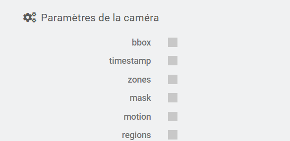

A quoi sert ca?
sachant que ce sont des éléments que nous mettons dans la config frigate.
en cas d’event la commande change d’état instanement ou faut attendre le cron?
Juste pour la visualisation à droite.

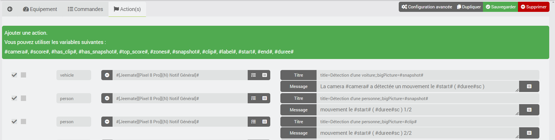

Maj Beta dispo avec une petite correction sur URL clip et snapshot dans les actions.
Pour info exemple d’action de notification via le plugin JeeMate :
N’hésitez pas à partager vos exemple avec d’autres plugins de notifications.
