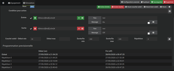

Paramétrage (le screenshot a été fait 1 jour avant le test détaillé dans le log, j’avais oublié d’activer la simulation) :
Le log :
[2020-05-28 23:15:03][DEBUG] : {"simupre_id":59,"simulation_id":"5ecea8cd09ff0","mode":"start","endtime":1590714348,"starttime":1590700548,"repetition":[{"starttime":1590700548,"endtime":1590703567},{"starttime":1590706103,"endtime":1590708691},{"starttime":1590710106,"endtime":1590714348}],"repeat_step":0}
[2020-05-28 23:15:03][DEBUG] : [Aucun][test] - Launch simulation
[2020-05-28 23:15:03][DEBUG] : [Aucun][test] - Simulation mode is start for : test
[2020-05-28 23:15:03][DEBUG] : [Aucun][test] - Repeat mode enable, replan on :2020-05-29 00:06:07
[2020-05-28 23:15:03][DEBUG] : Cron : {"id":"926","enable":1,"class":"simupre","function":"doSimu","schedule":"06 00 29 05 * 2020","timeout":"60","deamon":0,"deamonSleepTime":"1","option":{"simupre_id":59,"simulation_id":"5ecea8cd09ff0","mode":"end","endtime":1590714348,"repetition":[{"starttime":1590700548,"endtime":1590703567},{"starttime":1590706103,"endtime":1590708691},{"starttime":1590710106,"endtime":1590714348}],"repeat_step":0},"once":1,"state":"stop","lastRun":"","pid":null,"runtime":""}
[2020-05-28 23:15:03][DEBUG] : [Aucun][test] - Do action on
[2020-05-29 00:06:02][DEBUG] : {"simupre_id":59,"simulation_id":"5ecea8cd09ff0","mode":"end","endtime":1590714348,"repetition":[{"starttime":1590700548,"endtime":1590703567},{"starttime":1590706103,"endtime":1590708691},{"starttime":1590710106,"endtime":1590714348}],"repeat_step":0}
[2020-05-29 00:06:02][DEBUG] : [Aucun][test] - Launch simulation
[2020-05-29 00:06:02][DEBUG] : [Aucun][test] - Simulation mode is end for test
[2020-05-29 00:06:02][DEBUG] : [Aucun][test] - Repeat mode enable, replan on :2020-05-29 00:48:23
[2020-05-29 00:06:02][DEBUG] : [Aucun][test] - Do action off
