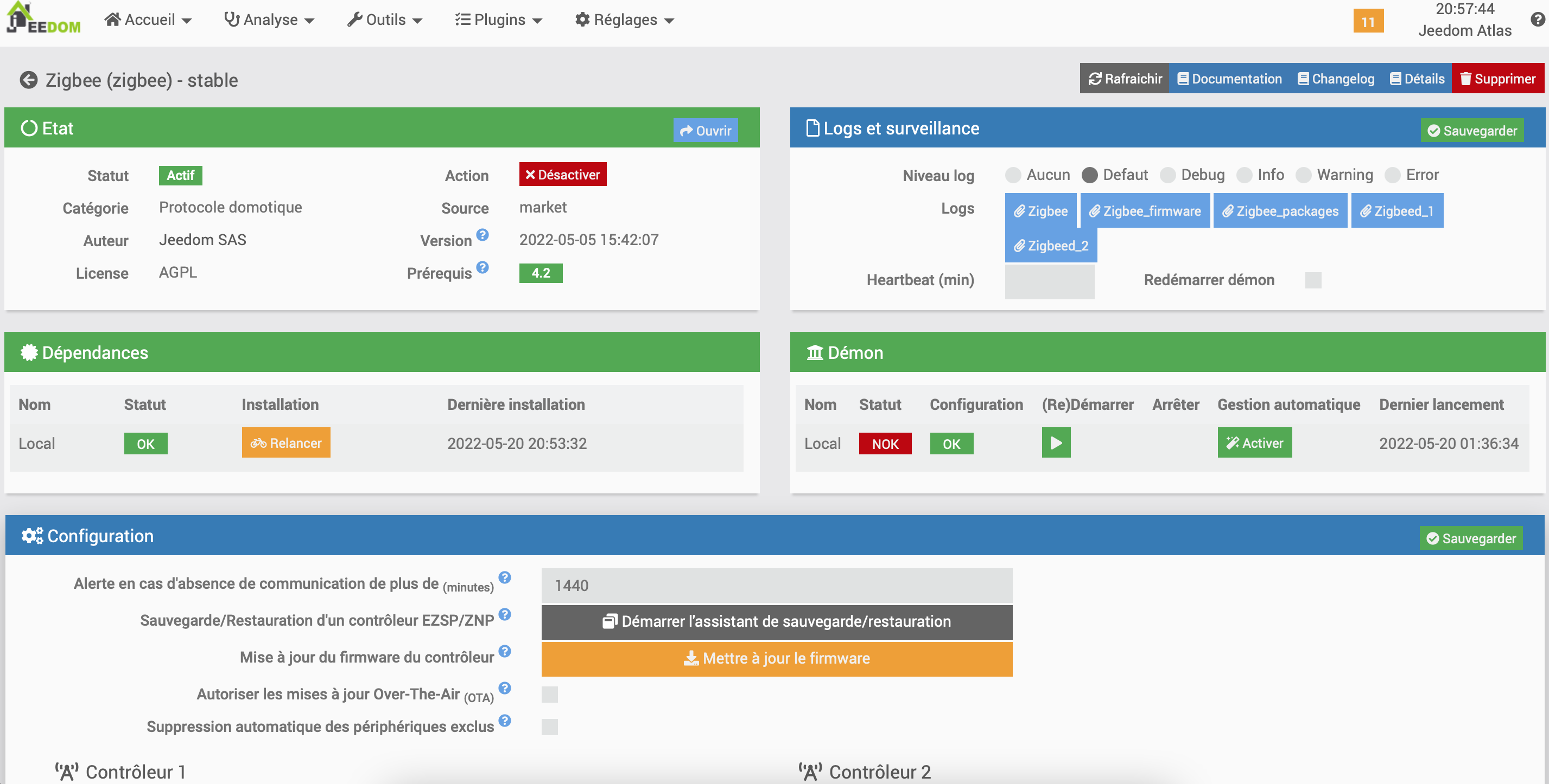

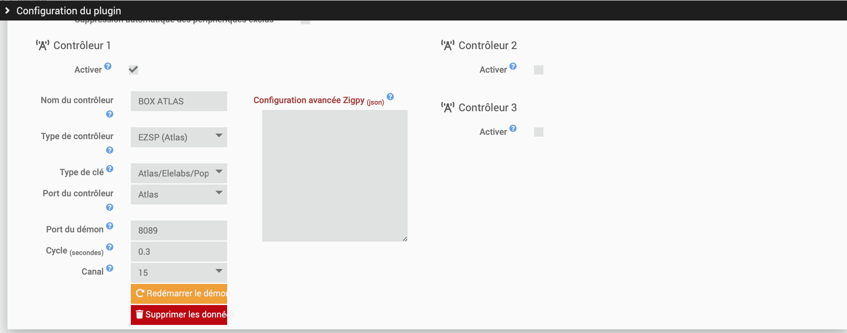

Bonjour, Merci pour vos réponses.
Il me semble que la configuration zigbee est bien comme il faut.

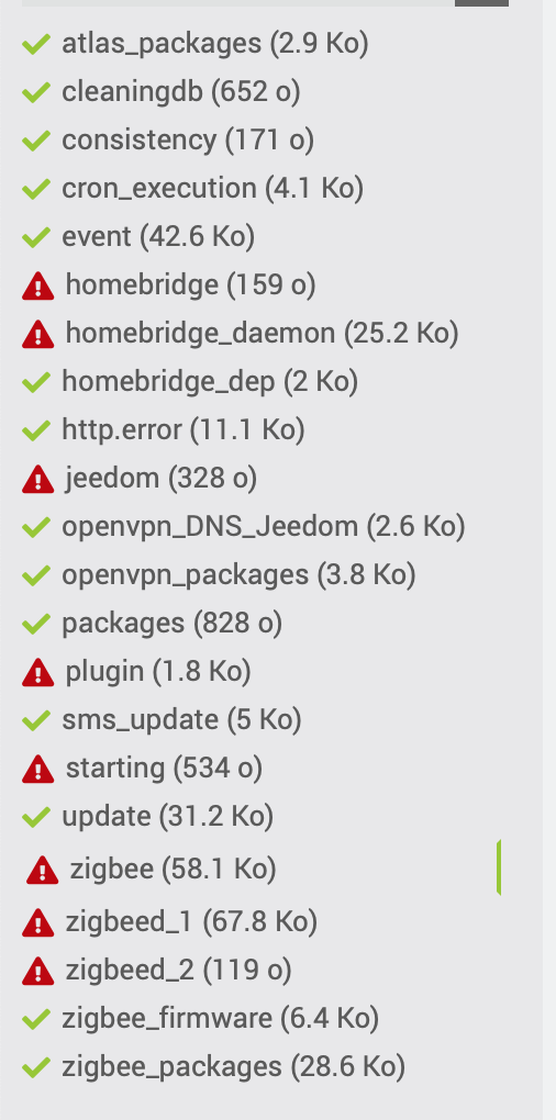

Tous les logs sont tous en erreur :

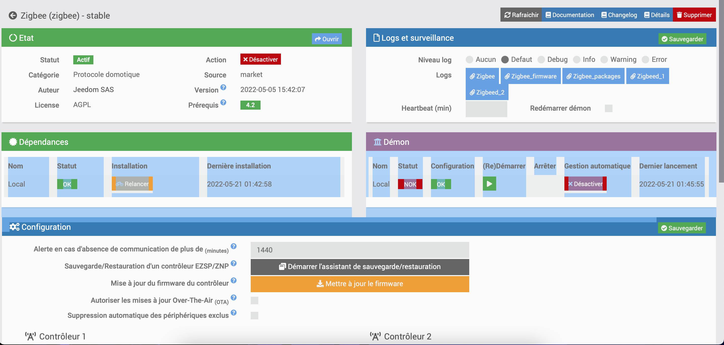

Je rencontre le même soucis en ce moment :confused:
[2022-05-21 15:32:51][INFO] : Start zigbeed
[2022-05-21 15:32:51][INFO] : Log level : debug
[2022-05-21 15:32:51][INFO] : PID file : /tmp/jeedom/zigbee/deamon_1.pid
[2022-05-21 15:32:51][INFO] : Device : /dev/ttyUSB1
[2022-05-21 15:32:51][INFO] : Apikey : QJeYQUBTD5VWis5RsXdvLLxWPeSZ1f66
[2022-05-21 15:32:51][INFO] : Callback : http://127.0.0.1:80/plugins/zigbee/core/php/jeeZigbee.php
[2022-05-21 15:32:51][INFO] : Cycle : 0.3
[2022-05-21 15:32:51][INFO] : Controller : ezsp
[2022-05-21 15:32:51][INFO] : Channel : 11
[2022-05-21 15:32:51][INFO] : Data folder : /var/www/html/plugins/zigbee/data/1
[2022-05-21 15:32:51][INFO] : Device folder : /var/www/html/plugins/zigbee/data/device
[2022-05-21 15:32:51][INFO] : Folder OTA : /var/www/html/plugins/zigbee/data/ota
[2022-05-21 15:32:51][INFO] : Zigpy advance configuration file : None
[2022-05-21 15:32:52][DEBUG] : SQLite version for <module 'sqlite3' from '/usr/lib/python3.7/sqlite3/__init__.py'>: 3.27.2
[2022-05-21 15:32:54][INFO] : Find device : /dev/ttyUSB1
[2022-05-21 15:32:55][INFO] : Writing PID 2152 to /tmp/jeedom/zigbee/deamon_1.pid
[2022-05-21 15:32:55][INFO] : Init request module v2.27.1
[2022-05-21 15:32:55][DEBUG] : Starting new HTTP connection (1): 127.0.0.1:80
[2022-05-21 15:32:55][DEBUG] : http://127.0.0.1:80 "GET /plugins/zigbee/core/php/jeeZigbee.php?apikey=QJeYQUBTD5VWis5RsXdvLLxWPeSZ1f66 HTTP/1.1" 200 0
[2022-05-21 15:33:03][DEBUG] : Using selector: EpollSelector
[2022-05-21 15:33:03][DEBUG] : Resetting EZSP
[2022-05-21 15:33:03][DEBUG] : Resetting ASH
[2022-05-21 15:33:03][DEBUG] : Sending: b'1ac038bc7e'
[2022-05-21 15:33:08][ERROR] : Couldn't start application
[2022-05-21 15:33:08][DEBUG] : executing functools.partial(<built-in method close of sqlite3.Connection object at 0x7f84dd7c70>)
[2022-05-21 15:33:08][DEBUG] : operation functools.partial(<built-in method close of sqlite3.Connection object at 0x7f84dd7c70>) completed
[2022-05-21 15:33:08][INFO] : Shutting down ControllerApplication
[2022-05-21 15:33:08][ERROR] : [start_zigbee] Fatal error :
[2022-05-21 15:33:08][INFO] : Traceback (most recent call last):
File "/var/www/html/plugins/zigbee/resources/zigbeed/zigbeed.py", line 102, in start_zigbee
start_radio=True,
File "/usr/local/lib/python3.7/dist-packages/zigpy/application.py", line 69, in new
await app.startup(auto_form)
File "/usr/local/lib/python3.7/dist-packages/bellows/zigbee/application.py", line 132, in startup
self._ezsp = await bellows.ezsp.EZSP.initialize(self.config)
File "/usr/local/lib/python3.7/dist-packages/bellows/ezsp/__init__.py", line 83, in initialize
await ezsp.reset()
File "/usr/local/lib/python3.7/dist-packages/bellows/ezsp/__init__.py", line 98, in reset
await self._gw.reset()
File "/usr/local/lib/python3.7/dist-packages/bellows/uart.py", line 223, in reset
return await asyncio.wait_for(self._reset_future, timeout=RESET_TIMEOUT)
File "/usr/lib/python3.7/asyncio/tasks.py", line 423, in wait_for
raise futures.TimeoutError()
concurrent.futures._base.TimeoutError
[2022-05-21 15:33:08][INFO] : Shutdown
[2022-05-21 15:33:08][INFO] : Removing PID file /tmp/jeedom/zigbee/deamon_1.pid
[2022-05-21 15:33:08][INFO] : Exit 0
J’ai essayé les commandes pour sortir la clé qui pouvait être en mode « boorloader » en suivant et adaptant la procédure du lien suivant (cf. « base.timeout ») : https://doc.jeedom.com/fr_FR/plugins/automation%20protocol/zigbee/
Mais rien, Idem avec une mise à jour du RPI (Demon ok puis nok sur plugin Zigbee + clé Popp - #8 par Jean_Surville)
Je suis un peu à sec d’idées.
Bonne journée et merci pour votre aide :slight_smile:
