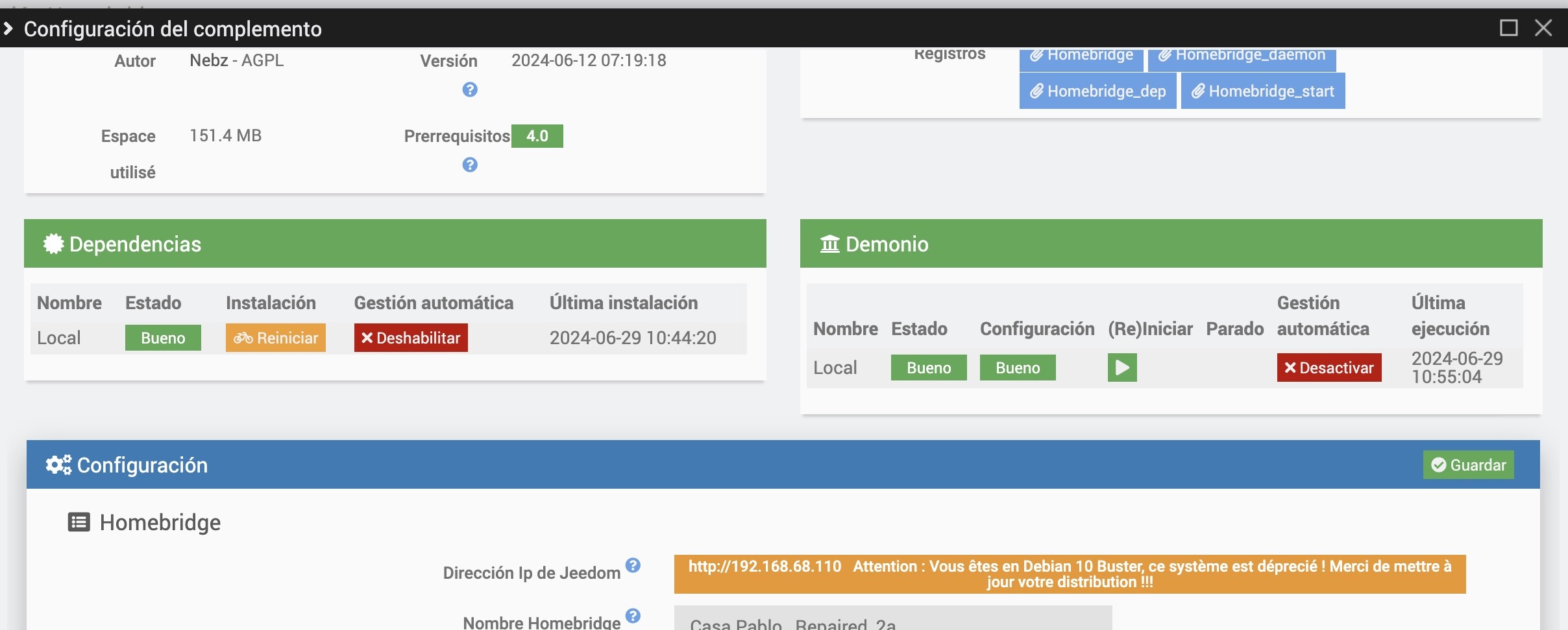

Problème avec le plugin, il ne charge pas les accessoires
quand je scanne le pont il ne charge pas les accessoires, c’est un jeedom pro. :melting_face:

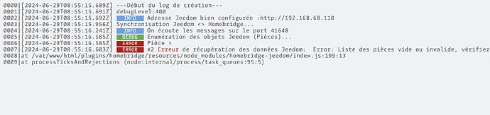

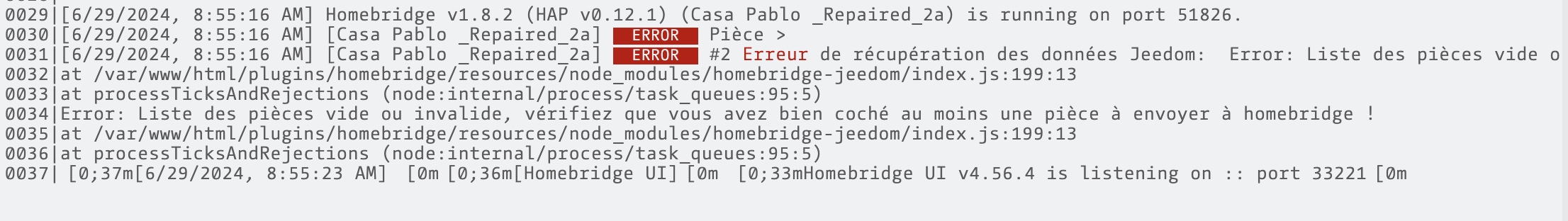

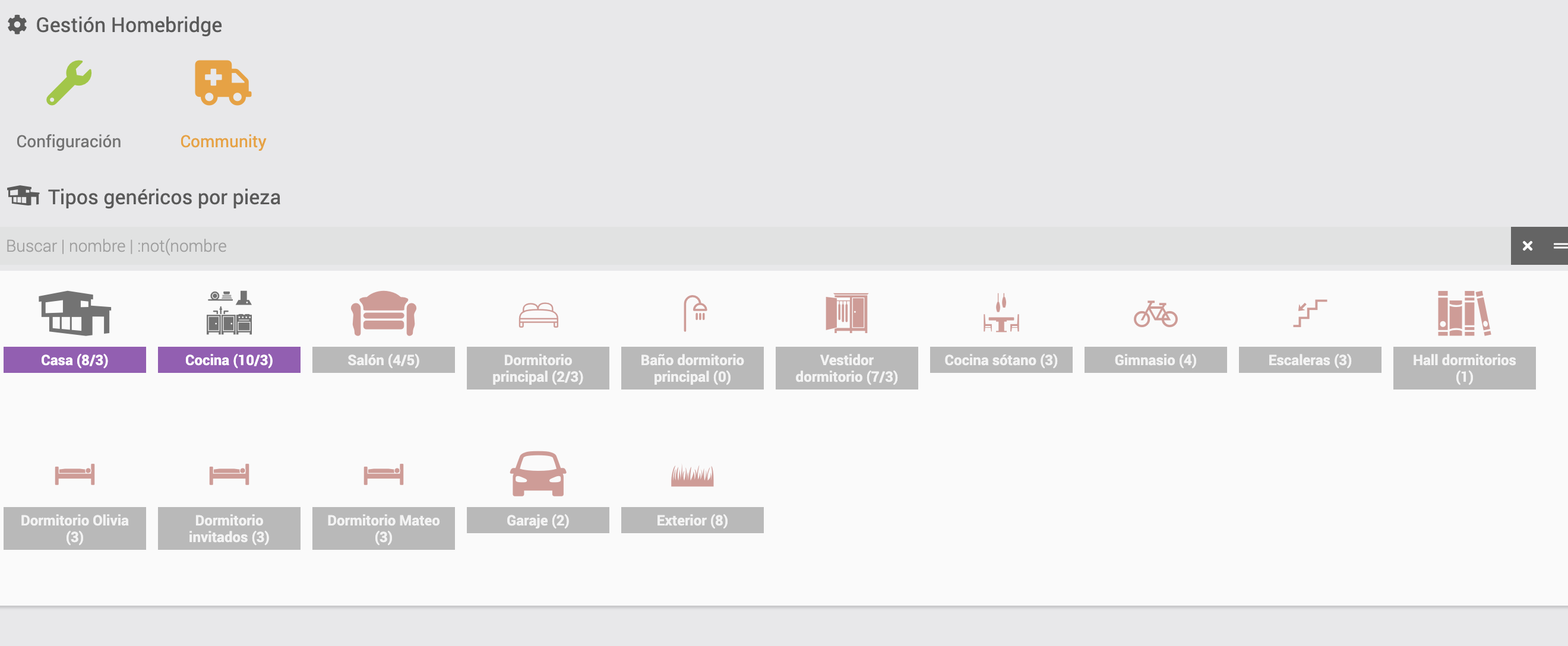

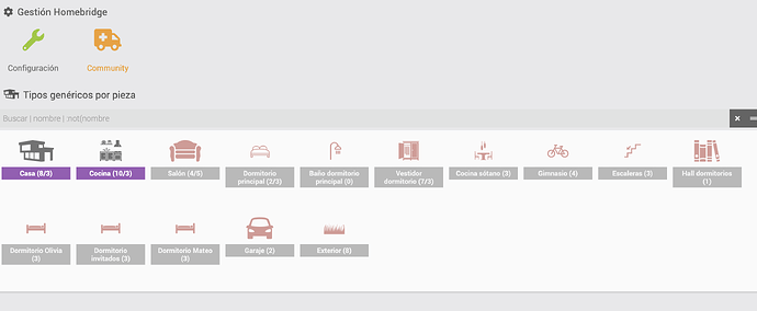

There is an issue with the room list, either empty (no rooms) either a problem in one name.
Could you show the rooms (objects) you are using ?
Are you the same victor who did contact Homebridge support too ?
Yes, i contact
I restored a backup from 2 years ago and it works now.
