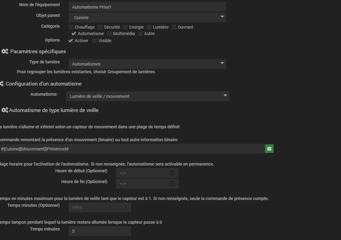

Ca a bien fonctionné chez moi. Tu pourrais m’envoyer en photo la config de l’automatisme + le log debug ?
Voici le log. Alors j’ai détourné le système pour que cela allume des prises. J’ai attribué le même autmatisme aux 3 équipements

[2021-10-06 16:45:36][DEBUG] : AUTOM QUEUE :[]
[2021-10-06 16:45:36][DEBUG] : SET AUTOMATISME QUEUE : [{"time":1633531536,"instanceId":"615db6902fb4b","status":1,"idAutomatisme":"2392","uniqueId":3,"automatismeType":"night_light","humanName":null,"name":"Automatisme Prise1","ponderation":0}]
[2021-10-06 16:45:36][DEBUG] : --------------------------------
[2021-10-06 16:45:36][DEBUG] : START AUTOMATISME
[2021-10-06 16:45:36][DEBUG] : Automatisme type is: night_light
[2021-10-06 16:45:36][DEBUG] : 0 equipments contain this automatisme
[2021-10-06 16:45:36][DEBUG] : END AUTOMATISME
[2021-10-06 16:46:21][DEBUG] : AUTOM QUEUE :[{"time":1633531466,"instanceId":"615db64aef25c","status":1,"idAutomatisme":"2392","uniqueId":3,"automatismeType":"night_light","humanName":null,"name":"Automatisme Prise1","ponderation":0}]
[2021-10-06 16:46:21][DEBUG] : Autom for verif queue [{"time":1633531466,"instanceId":"615db64aef25c","status":1,"idAutomatisme":"2392","uniqueId":3,"automatismeType":"night_light","humanName":null,"name":"Automatisme Prise1","ponderation":0}]
[2021-10-06 16:46:21][DEBUG] : ABORT AUTOMATISME, NO LONGER IN QUEUE
[2021-10-06 16:46:21][DEBUG] : END NIGHT LIGHT AUTOMATISME
[2021-10-06 16:46:21][DEBUG] : --------------------------------
[2021-10-06 16:46:21][DEBUG] : START NIGHT LIGHT AUTOMATISME for light: Prise Nespresso with presence 0
[2021-10-06 16:46:21][DEBUG] : In interval or interval not defined
[2021-10-06 16:46:21][DEBUG] : light status: 1
[2021-10-06 16:46:21][DEBUG] : AUTOM QUEUE :[{"time":1633530627,"instanceId":"615db3031932d","status":1,"idAutomatisme":"2390","uniqueId":1,"automatismeType":"night_light","humanName":null,"name":"Automatisme Prise","ponderation":0},{"time":1633531467,"instanceId":"615db64b2262f","status":1,"idAutomatisme":"2392","uniqueId":4,"automatismeType":"night_light","humanName":null,"name":"Automatisme Prise1","ponderation":0}]
[2021-10-06 16:46:21][DEBUG] : Autom queue [{"time":1633530627,"instanceId":"615db3031932d","status":1,"idAutomatisme":"2390","uniqueId":1,"automatismeType":"night_light","humanName":null,"name":"Automatisme Prise","ponderation":0},{"time":1633531467,"instanceId":"615db64b2262f","status":1,"idAutomatisme":"2392","uniqueId":4,"automatismeType":"night_light","humanName":null,"name":"Automatisme Prise1","ponderation":0}]
[2021-10-06 16:46:21][DEBUG] : SET AUTOMATISME QUEUE : [{"time":1633530627,"instanceId":"615db3031932d","status":1,"idAutomatisme":"2390","uniqueId":1,"automatismeType":"night_light","humanName":null,"name":"Automatisme Prise","ponderation":0}]
[2021-10-06 16:46:21][DEBUG] : AUTOM QUEUE :[{"time":1633530627,"instanceId":"615db3031932d","status":1,"idAutomatisme":"2390","uniqueId":1,"automatismeType":"night_light","humanName":null,"name":"Automatisme Prise","ponderation":0}]
[2021-10-06 16:46:21][DEBUG] : SET AUTOMATISME QUEUE : [{"time":1633530627,"instanceId":"615db3031932d","status":1,"idAutomatisme":"2390","uniqueId":1,"automatismeType":"night_light","humanName":null,"name":"Automatisme Prise","ponderation":0},{"time":1633531581,"instanceId":"615db6bda3e6b","status":1,"idAutomatisme":"2392","uniqueId":2,"automatismeType":"night_light","humanName":null,"name":"Automatisme Prise","ponderation":0}]
[2021-10-06 16:49:13][INFO] : Start deamon
[2021-10-06 16:49:13][INFO] : --------------------------------
[2021-10-06 16:49:13][INFO] : START RETRIEVE AUTOMATISME
[2021-10-06 16:49:13][INFO] : 0 linked automatismes
[2021-10-06 16:49:13][INFO] : END RETRIEVE AUTOMATISME
[2021-10-06 16:50:36][DEBUG] : --------------------------------
[2021-10-06 16:50:36][DEBUG] : START NIGHT LIGHT AUTOMATISME for light: Prise Cafetière with presence 0
[2021-10-06 16:50:36][DEBUG] : In interval or interval not defined
[2021-10-06 16:50:36][DEBUG] : light status: 1
[2021-10-06 16:50:36][DEBUG] : AUTOM QUEUE :[{"time":1633531466,"instanceId":"615db64aef25c","status":1,"idAutomatisme":"2392","uniqueId":3,"automatismeType":"night_light","humanName":null,"name":"Automatisme Prise1","ponderation":0}]
[2021-10-06 16:50:36][DEBUG] : Autom queue [{"time":1633531466,"instanceId":"615db64aef25c","status":1,"idAutomatisme":"2392","uniqueId":3,"automatismeType":"night_light","humanName":null,"name":"Automatisme Prise1","ponderation":0}]
[2021-10-06 16:50:36][DEBUG] : SET AUTOMATISME QUEUE : []
[2021-10-06 16:50:36][DEBUG] : AUTOM QUEUE :[]
[2021-10-06 16:50:36][DEBUG] : SET AUTOMATISME QUEUE : [{"time":1633531836,"instanceId":"615db7bc6e2c1","status":1,"idAutomatisme":"2392","uniqueId":3,"automatismeType":"night_light","humanName":null,"name":"Automatisme Prise1","ponderation":0}]
[2021-10-06 16:50:37][DEBUG] : Pull values
[2021-10-06 16:50:37][DEBUG] : START REFRESH VALUES with status / lumen / color / temperature: 0
[2021-10-06 16:50:37][DEBUG] : Binary light state
[2021-10-06 16:50:37][DEBUG] : Set new status Prise Bouilloire
[2021-10-06 16:50:37][DEBUG] : Found group: Groupe Prise that contains the equipment Prise Bouilloire
[2021-10-06 16:50:37][DEBUG] : WILL REFRESH WIDGET
Bon j’ai trouvé, ca va me demander un peu de temps de résolution.
Pour te débloquer tu peux utiliser un groupe et appliquer l’automatisme sur le groupe. Ca devrait résoudre ton problème.
Yes t’inquiète pas j’ai fait un groupe et cela fonctionne impec
