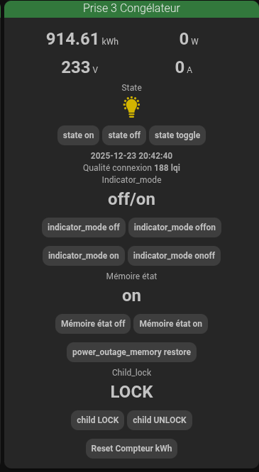

Nous A1Z
Power outage memory (enum)
Recover state after power outage. Value can be found in the published state on the power_outage_memory property. To read (/get) the value publish a message to topic zigbee2mqtt/FRIENDLY_NAME/get with payload {"power_outage_memory": ""}. To write (/set) a value publish a message to topic zigbee2mqtt/FRIENDLY_NAME/set with payload {"power_outage_memory": NEW_VALUE}. The possible values are: on, off, restore.

Trop rapide, j’allais répondre la même chose: Nous A1Z

Pour confirmer et jamais 2 sans 3, les prises Nous A1Z :wink:

Et les shelly plug S aussi.
