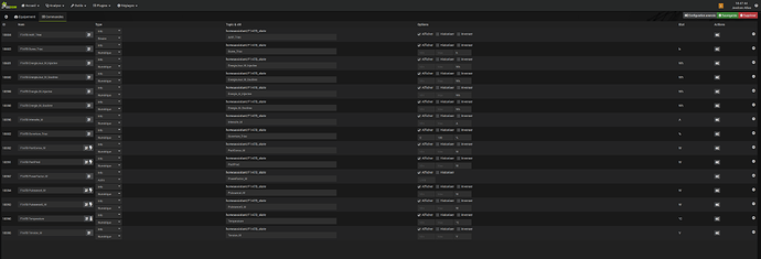

J’ai supprimé mais pas mieux quand il sait ajouté , dsl
Capture d'écran 2024-08-24 122758
{"sensor":{"F1ATB_Temperature":{"name":"F1ATB Temperature","uniq_id":"F1ATB_Temperature","stat_t":"homeassistant/F1ATB_state","device_class":"temperature","unit_of_meas":"°C","val_tpl":"{{ value_json.Temperature|default(0)|round(1)}}","device":{"ids":"c3dc24","name":"Routeur - RMS","mdl":"ESP32 - c3dc24","mf":"F1ATB - https://f1atb.fr","hw":"ESP32-D0WD rev.301","sw":"11.17","cu":"http://192.168.68.23"}},"F1ATB_PactProd":{"name":"F1ATB PactProd","uniq_id":"F1ATB_PactProd","stat_t":"homeassistant/F1ATB_state","device_class":"power","unit_of_meas":"W","val_tpl":"{{ value_json.PactProd|default(0)|round(0)}}","device":{"ids":"c3dc24","name":"Routeur - RMS","mdl":"ESP32 - c3dc24","mf":"F1ATB - https://f1atb.fr","hw":"ESP32-D0WD rev.301","sw":"11.17","cu":"http://192.168.68.23"}},"F1ATB_PactConso_M":{"name":"F1ATB PactConso_M","uniq_id":"F1ATB_PactConso_M","stat_t":"homeassistant/F1ATB_state","device_class":"power","unit_of_meas":"W","val_tpl":"{{ value_json.PactConso_M|default(0)|round(0)}}","device":{"ids":"c3dc24","name":"Routeur - RMS","mdl":"ESP32 - c3dc24","mf":"F1ATB - https://f1atb.fr","hw":"ESP32-D0WD rev.301","sw":"11.17","cu":"http://192.168.68.23"}},"F1ATB_PuissanceS_M":{"name":"F1ATB PuissanceS_M","uniq_id":"F1ATB_PuissanceS_M","stat_t":"homeassistant/F1ATB_state","device_class":"power","unit_of_meas":"W","val_tpl":"{{ value_json.PuissanceS_M|default(0)|round(0)}}","device":{"ids":"c3dc24","name":"Routeur - RMS","mdl":"ESP32 - c3dc24","mf":"F1ATB - https://f1atb.fr","hw":"ESP32-D0WD rev.301","sw":"11.17","cu":"http://192.168.68.23"}},"F1ATB_PuissanceI_M":{"name":"F1ATB PuissanceI_M","uniq_id":"F1ATB_PuissanceI_M","stat_t":"homeassistant/F1ATB_state","device_class":"power","unit_of_meas":"W","val_tpl":"{{ value_json.PuissanceI_M|default(0)|round(0)}}","device":{"ids":"c3dc24","name":"Routeur - RMS","mdl":"ESP32 - c3dc24","mf":"F1ATB - https://f1atb.fr","hw":"ESP32-D0WD rev.301","sw":"11.17","cu":"http://192.168.68.23"}},"F1ATB_Tension_M":{"name":"F1ATB Tension_M","uniq_id":"F1ATB_Tension_M","stat_t":"homeassistant/F1ATB_state","device_class":"voltage","unit_of_meas":"V","val_tpl":"{{ value_json.Tension_M|default(0)|round(2)}}","device":{"ids":"c3dc24","name":"Routeur - RMS","mdl":"ESP32 - c3dc24","mf":"F1ATB - https://f1atb.fr","hw":"ESP32-D0WD rev.301","sw":"11.17","cu":"http://192.168.68.23"}},"F1ATB_Intensite_M":{"name":"F1ATB Intensite_M","uniq_id":"F1ATB_Intensite_M","stat_t":"homeassistant/F1ATB_state","device_class":"current","unit_of_meas":"A","val_tpl":"{{ value_json.Intensite_M|default(0)|round(2)}}","device":{"ids":"c3dc24","name":"Routeur - RMS","mdl":"ESP32 - c3dc24","mf":"F1ATB - https://f1atb.fr","hw":"ESP32-D0WD rev.301","sw":"11.17","cu":"http://192.168.68.23"}},"F1ATB_PowerFactor_M":{"name":"F1ATB PowerFactor_M","uniq_id":"F1ATB_PowerFactor_M","stat_t":"homeassistant/F1ATB_state","device_class":"power_factor","unit_of_meas":"","val_tpl":"{{ value_json.PowerFactor_M|default(0)|round(2)}}","device":{"ids":"c3dc24","name":"Routeur - RMS","mdl":"ESP32 - c3dc24","mf":"F1ATB - https://f1atb.fr","hw":"ESP32-D0WD rev.301","sw":"11.17","cu":"http://192.168.68.23"}},"F1ATB_Energie_M_Soutiree":{"name":"F1ATB Energie_M_Soutiree","uniq_id":"F1ATB_Energie_M_Soutiree","stat_t":"homeassistant/F1ATB_state","device_class":"energy","unit_of_meas":"Wh","state_class":"total_increasing","val_tpl":"{{ value_json.Energie_M_Soutiree|default(0)|round(0)}}","device":{"ids":"c3dc24","name":"Routeur - RMS","mdl":"ESP32 - c3dc24","mf":"F1ATB - https://f1atb.fr","hw":"ESP32-D0WD rev.301","sw":"11.17","cu":"http://192.168.68.23"}},"F1ATB_Energie_M_Injectee":{"name":"F1ATB Energie_M_Injectee","uniq_id":"F1ATB_Energie_M_Injectee","stat_t":"homeassistant/F1ATB_state","device_class":"energy","unit_of_meas":"Wh","state_class":"total_increasing","val_tpl":"{{ value_json.Energie_M_Injectee|default(0)|round(0)}}","device":{"ids":"c3dc24","name":"Routeur - RMS","mdl":"ESP32 - c3dc24","mf":"F1ATB - https://f1atb.fr","hw":"ESP32-D0WD rev.301","sw":"11.17","cu":"http://192.168.68.23"}},"F1ATB_EnergieJour_M_Soutiree":{"name":"F1ATB EnergieJour_M_Soutiree","uniq_id":"F1ATB_EnergieJour_M_Soutiree","stat_t":"homeassistant/F1ATB_state","device_class":"energy","unit_of_meas":"Wh","state_class":"total_increasing","val_tpl":"{{ value_json.EnergieJour_M_Soutiree|default(0)|round(0)}}","device":{"ids":"c3dc24","name":"Routeur - RMS","mdl":"ESP32 - c3dc24","mf":"F1ATB - https://f1atb.fr","hw":"ESP32-D0WD rev.301","sw":"11.17","cu":"http://192.168.68.23"}},"F1ATB_EnergieJour_M_Injectee":{"name":"F1ATB EnergieJour_M_Injectee","uniq_id":"F1ATB_EnergieJour_M_Injectee","stat_t":"homeassistant/F1ATB_state","device_class":"energy","unit_of_meas":"Wh","state_class":"total_increasing","val_tpl":"{{ value_json.EnergieJour_M_Injectee|default(0)|round(0)}}","device":{"ids":"c3dc24","name":"Routeur - RMS","mdl":"ESP32 - c3dc24","mf":"F1ATB - https://f1atb.fr","hw":"ESP32-D0WD rev.301","sw":"11.17","cu":"http://192.168.68.23"}},"F1ATB_Ouverture_Triac":{"name":"F1ATB Ouverture_Triac","uniq_id":"F1ATB_Ouverture_Triac","stat_t":"homeassistant/F1ATB_state","device_class":"power_factor","unit_of_meas":"%","val_tpl":"{{ value_json.Ouverture_Triac|default(0)|round(0)}}","device":{"ids":"c3dc24","name":"Routeur - RMS","mdl":"ESP32 - c3dc24","mf":"F1ATB - https://f1atb.fr","hw":"ESP32-D0WD rev.301","sw":"11.17","cu":"http://192.168.68.23"}},"F1ATB_Duree_Triac":{"name":"F1ATB Duree_Triac","uniq_id":"F1ATB_Duree_Triac","stat_t":"homeassistant/F1ATB_state","device_class":"duration","unit_of_meas":"h","val_tpl":"{{ value_json.Duree_Triac|default(0)|round(2)}}","device":{"ids":"c3dc24","name":"Routeur - RMS","mdl":"ESP32 - c3dc24","mf":"F1ATB - https://f1atb.fr","hw":"ESP32-D0WD rev.301","sw":"11.17","cu":"http://192.168.68.23"}}},"binary_sensor":{"F1ATB_Actif_Triac":{"name":"F1ATB Actif_Triac","uniq_id":"F1ATB_Actif_Triac","stat_t":"homeassistant/F1ATB_state","init":0,"ic":"mdi:electric-switch","payload_off":"0","payload_on":"1","val_tpl":"{{ value_json.Actif_Triac}}","device":{"ids":"c3dc24","name":"Routeur - RMS","mdl":"ESP32 - c3dc24","mf":"F1ATB - https://f1atb.fr","hw":"ESP32-D0WD rev.301","sw":"11.17","cu":"http://192.168.68.23"}}}}
Je ne sais rien faire avec un widget
il me faut les logs & la page de config des commandes
C’était juste pour info le wiget, pas de soucis
