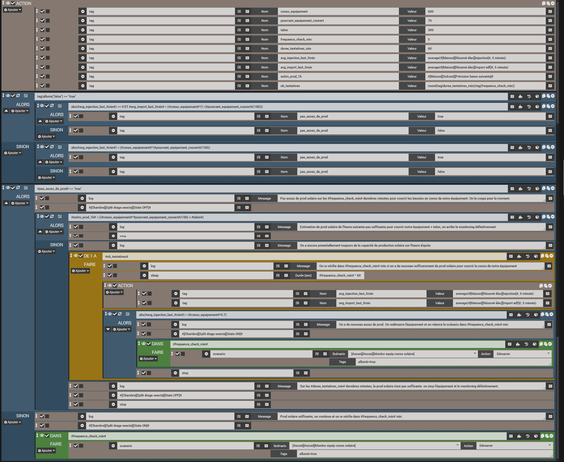

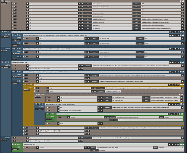

- Nom du scénario : Monitor equip conso solaire
- Mode du scénario : provoke
    - Evènement :
    ACTION
     tag - Options : {"enable":"1","background":"0","name":"conso_equipement","value":"600"}
     tag - Options : {"enable":"1","background":"0","name":"pourcent_equipement_couvert","value":"70"}
     tag - Options : {"enable":"1","background":"0","name":"talon","value":"300"}
     tag - Options : {"enable":"1","background":"0","name":"frequence_check_min","value":"5"}
     tag - Options : {"enable":"1","background":"0","name":"duree_tentatives_min","value":"60"}
     tag - Options : {"enable":"1","background":"0","name":"avg_injection_last_Xmin","value":"average(#[Maison][R\u00e9sum\u00e9 \u00e9lec][Injection]#, 5 minute)"}
     tag - Options : {"enable":"1","background":"0","name":"avg_import_last_Xmin","value":"average(#[Maison][R\u00e9sum\u00e9 \u00e9lec][Import edf]#, 5 minute)"}
     tag - Options : {"enable":"1","background":"0","name":"estim_prod_1h","value":"#[Maison][Solcast][Pr\u00e9vision heure suivante]#"}
     tag - Options : {"enable":"1","background":"0","name":"nb_tentatives","value":"round(tag(duree_tentatives_min)\/tag(frequence_check_min))"}
    SI tag(allumé,"false") == "true"
    ALORS
        SI abs(#avg_injection_last_Xmin#) == 0 ET #avg_import_last_Xmin# > (#conso_equipement#*(1-(#pourcent_equipement_couvert#/100)))
        ALORS
         tag - Options : {"enable":"1","background":"0","name":"pas_assez_de_prod","value":"true"}
        SINON
         tag - Options : {"enable":"1","background":"0","name":"pas_assez_de_prod","value":"false"}
    SINON
        SI abs(#avg_injection_last_Xmin#) < (#conso_equipement#*(#pourcent_equipement_couvert#/100))
        ALORS
        SINON
    SI #pas_assez_de_prod# == "true"
    ALORS
     log - Options : {"enable":"1","background":"0","message":"Pas assez de prod solaire sur les #frequence_check_min# derni\u00e8res minutes pour couvrir les besoins en conso de notre \u00e9quipement. On le coupe pour le moment."}
     #[Chambre][Split étage onecta][State OFF]# - Options : {"enable":"1","background":"0"}
        SI #estim_prod_1h# < ((#conso_equipement#*#pourcent_equipement_couvert#/100) + #talon#)
        ALORS
         log - Options : {"enable":"1","background":"0","message":"Estimation de prod solaire de l'heure suivante pas suffisante pour couvrir notre \u00e9quipement + talon, on arr\u00eate le monitoring d\u00e9finitivement"}
         (stop) Arret du scenario
        SINON
         log - Options : {"enable":"1","background":"0","message":"On a encore potentiellement toujours de la capacit\u00e9 de production solaire sur l'heure d'apr\u00e8s"}
            POUR #nb_tentatives#
            FAIRE
             log - Options : {"enable":"1","background":"0","message":"On re v\u00e9rifie dans #frequence_check_min# min si on a de nouveau suffisamment de prod solaire pour couvrir la conso de notre \u00e9quipement"}
             (sleep) Pause de  : #frequence_check_min# * 60
                ACTION
                SI abs(#avg_injection_last_Xmin#) > (#conso_equipement#*0.7)
                ALORS
                 log - Options : {"enable":"1","background":"0","message":"On a de nouveau assez de prod. On red\u00e9marre l'\u00e9quipement et on relance le sc\u00e9nario dans #frequence_check_min# min"}
                 #[Chambre][Split étage onecta][State ON]# - Options : {"enable":"1","background":"0"}
                    DANS #frequence_check_min#
                    FAIRE
                     (scenario) start de [Aucun][Aucun][Monitor equip conso solaire]
                SINON
         log - Options : {"enable":"1","background":"0","message":"Sur les #duree_tentatives_min# derni\u00e8res minutes, la prod solaire n'est pas suffisante. on stop l'\u00e9quipement et le monitoring d\u00e9finitivement."}
    SINON
     log - Options : {"enable":"1","background":"0","message":"Prod solaire suffisante, on continue et on re v\u00e9rifie dans #frequence_check_min# min."}
        FAIRE
