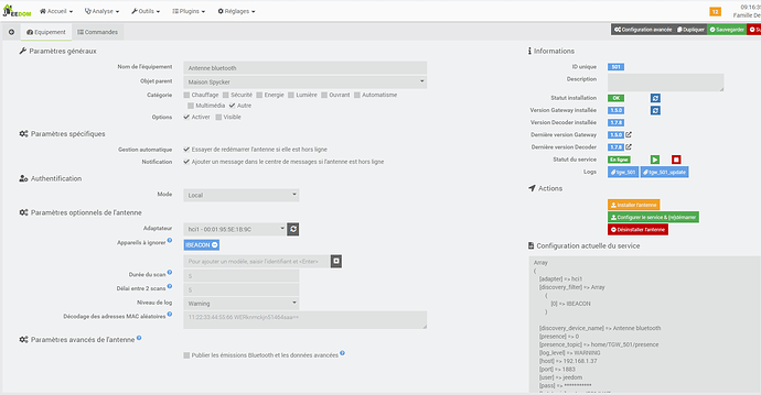

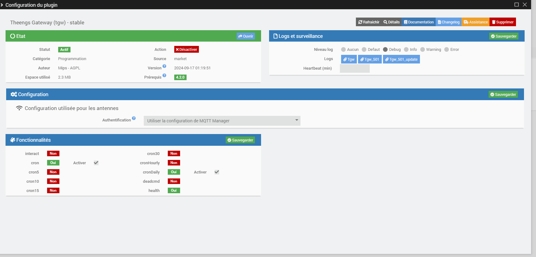

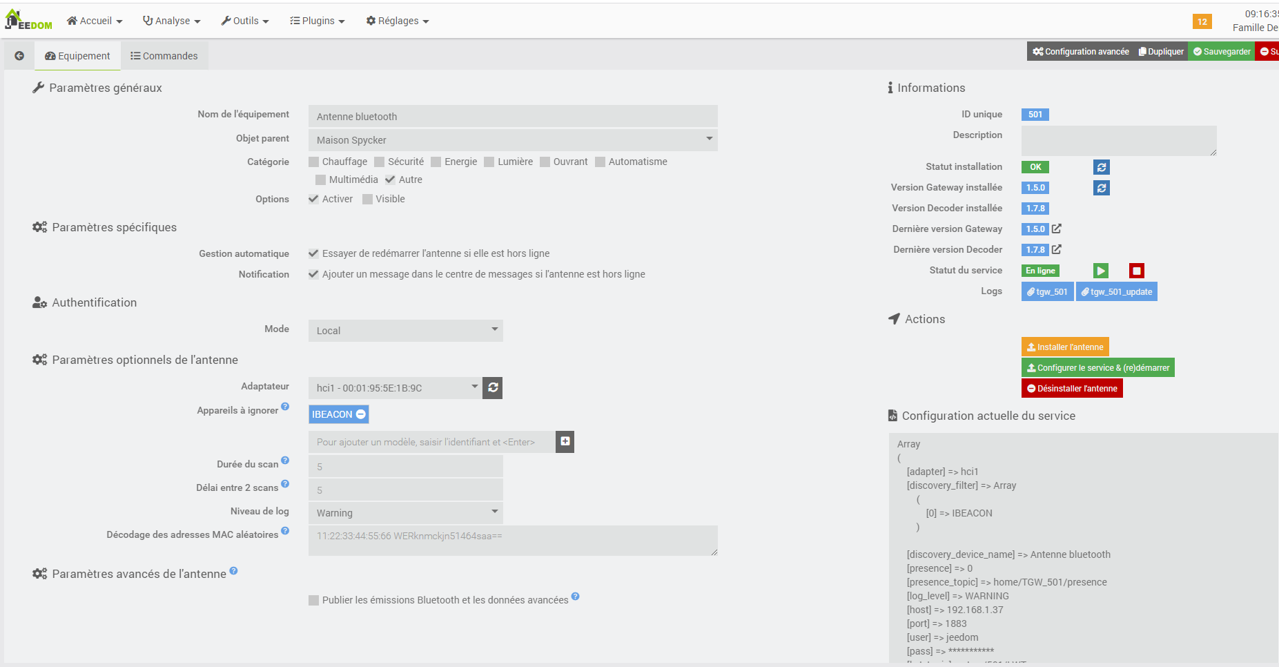

J’ai vidé le log, installer l’antenne (au préalable j’ai désinstallé le dongle qui date et qui n’a pas été testé depuis un moment), voici le premier log sur tgw 501
ERROR:BLEGateway:[org.bluez.Error.InProgress] Operation already in progress

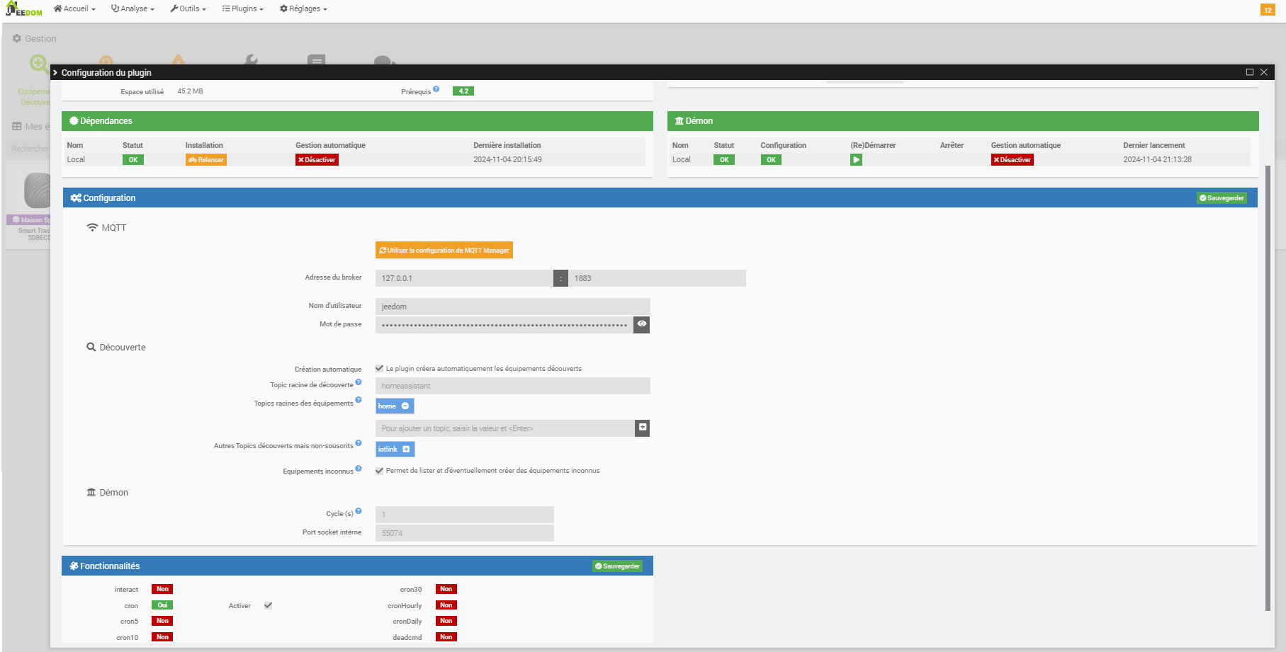

Ensuite j’ai relancé les dépendances de MQTT Discovery, puis activer le demon, voici le log :

[2024-11-05 13:32:17] INFO  : Lancement de l'installation de l'antenne 'Antenne bluetooth'
[2024-11-05 13:32:17] DEBUG  : local exec:sudo systemctl stop TheengsGateway.service =>
[2024-11-05 13:32:17] DEBUG  : local exec:sudo bash /var/www/html/plugins/tgw/core/class/../../resources/install.sh http://192.168.1.37/plugins/tgw/core/php/jeetgw.php?id=501 > /var/www/html/log/tgw_501_update 2>&1 & =>
[2024-11-05 13:32:21] DEBUG  : step:0 for id:501
[2024-11-05 13:32:29] DEBUG  : step:1 for id:501
[2024-11-05 13:33:01] DEBUG  : step:2 for id:501
[2024-11-05 13:33:05] DEBUG  : step:3 for id:501
[2024-11-05 13:33:05] DEBUG  : local exec:ls /tmp/ | grep -Ec tgw_install_in_progress => 0
[2024-11-05 13:33:07] DEBUG  : local exec:sudo /opt/TheengsGateway/bin/python3 -m TheengsGateway -h | grep -Ecw "usage:" => 1
[2024-11-05 13:33:07] DEBUG  : Task 'pullGatewayVersion' executed now
[2024-11-05 13:33:07] DEBUG  : Listening to topic:'tgw'
[2024-11-05 13:33:07] INFO  : Configuration de l'antenne 'Antenne bluetooth'
[2024-11-05 13:33:07] DEBUG  : Informations reçues de mqtt2: {"ip":"127.0.0.1","port":"1883","protocol":"mqtt","user":"jeedom","password":"qiWqqW0ZN6FPRwrbakyMWmsnM0xcwRNTGbTAEAkdzdgWzT1KoWiIuEU3oniBuAql"}
[2024-11-05 13:33:07] DEBUG  : local exec:echo '{"adapter":"hci0","discovery_filter":["IBEACON"],"discovery_device_name":"Antenne bluetooth","presence":0,"presence_topic":"home\/TGW_501\/presence","log_level":"WARNING","host":"192.168.1.37","port":1883,"user":"jeedom","pass":"qiWqqW0ZN6FPRwrbakyMWmsnM0xcwRNTGbTAEAkdzdgWzT1KoWiIuEU3oniBuAql","lwt_topic":"tgw\/501\/LWT","publish_topic":"home\/TGW_501\/BTtoMQTT","ble_scan_time":5,"ble_time_between_scans":5,"publish_advdata":"0"}' | sudo tee /root/theengsgw.conf => {"adapter":"hci0","discovery_filter":["IBEACON"],"discovery_device_name":"Antenne bluetooth","presence":0,"presence_topic":"home\/TGW_501\/presence","log_level":"WARNING","host":"192.168.1.37","port":1883,"user":"jeedom","pass":"qiWqqW0ZN6FPRwrbakyMWmsnM0xcwRNTGbTAEAkdzdgWzT1KoWiIuEU3oniBuAql","lwt_topic":"tgw\/501\/LWT","publish_topic":"home\/TGW_501\/BTtoMQTT","ble_scan_time":5,"ble_time_between_scans":5,"publish_advdata":"0"}
[2024-11-05 13:33:07] DEBUG  : local exec:sudo systemctl stop TheengsGateway.service =>
[2024-11-05 13:33:07] DEBUG  : local exec:echo '     [Unit]     Description=TheengsGateway Service     Requires=bluetooth.target network-online.target      [Service]     Type=simple     ExecStart=/opt/TheengsGateway/bin/python3 -m TheengsGateway     Restart=always     RestartSec=10     StandardOutput=append:/var/www/html/log/tgw_501     StandardError=append:/var/www/html/log/tgw_501      [Install]     WantedBy=multi-user.target     ' | sudo tee /etc/systemd/system/TheengsGateway.service =>
[2024-11-05 13:33:07] DEBUG  : local exec:ls /opt/TheengsGateway/lib/python3.*/site-packages | grep -Po 'TheengsDecoder-\K([0-9]\.[0-9]\.[0-9])' => 1.7.8
[2024-11-05 13:33:07] INFO  : TheengsDecoder version of Antenne bluetooth: 1.7.8
[2024-11-05 13:33:07] DEBUG  : local exec:ls /opt/TheengsGateway/lib/python3.*/site-packages | grep -Po 'TheengsGateway-\K([0-9]\.[0-9]\.[0-9])' => 1.5.0
[2024-11-05 13:33:07] INFO  : TheengsGateway version of Antenne bluetooth: 1.5.0
[2024-11-05 13:33:08] DEBUG  : local exec:sudo systemctl daemon-reload =>
[2024-11-05 13:33:09] DEBUG  : local exec:sudo systemctl enable --now TheengsGateway.service =>
[2024-11-05 13:33:10] DEBUG  : handle Mqtt Message:{"tgw":{"501":{"LWT":"online"}}}
[2024-11-05 13:33:10] INFO  : LWT update:online
[2024-11-05 13:35:44] DEBUG  : local exec:hcitool dev | grep hci => 	hci0	00:01:95:5E:1B:9C
le problème n’est ni dans plugin-mqttdiscovery ni dans plugin-tgw donc ces logs là ne servent pas.
c’est uniquement le « log de l’antenne » qui est donc le log de theengsgateway qui pourrait peut-être aider vu que c’est theengsgateway qui n’arrive pas à utiliser la clé bluetooth.
c’est la sena qui est branchée là?
je ne sais pas pq je ne vois que des problèmes avec cette clé, et j’ai l’impression que c’est aussi plus sur smart…
Oui j’ai changé pour la sena, puisque c’est la clé qui fonctionnait jusqu’alors avec phone detection, j’étais sûr de son fonctionnement, jusqu’ici je tentais avec l’autre.
Si je ne me trompe pas, dans le log antenne j’ai uniquement :
Et j’ai remarqué un warning à la fin de mon log MQTT Discovery, rien à voir d’après ce que tu dis mais bon…
Le pire c’est que ça fonctionne pour décrocher 5 minutes après…
bah non, ca informe que le composant « camera » n’est pas encore supporté par plugin-mqttdiscovery
c’est pour intégrer ta passerelle « iotlink »; mqtt discovery n’est pas limité à fonctionner avec theengsgateway
