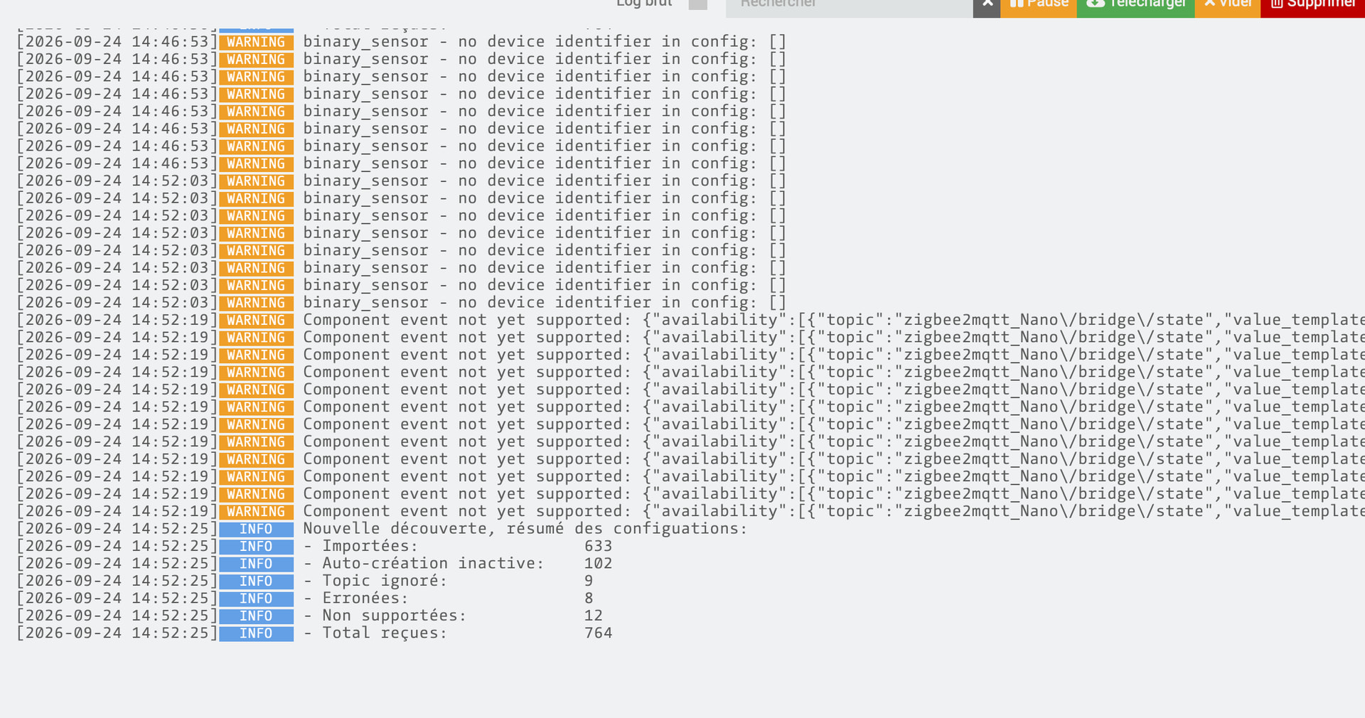

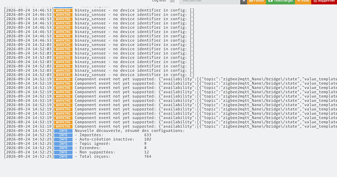

Log Mqtt discovery
[2026-09-24 14:46:30]WARNING Component event not yet supported: {"availability":[{"topic":"zigbee2mqtt_Nano\/bridge\/state","value_template":"{{ value_json.state }}"},{"topic":"zigbee2mqtt_Nano\/Bouton Ikea Ch Verte\/availability","value_template":"{{ value_json.state }}"}],"availability_mode":"all","default_entity_id":"event.bouton_ikea_ch_verte_action","device":{"hw_version":1,"identifiers":["zigbee2mqtt_0x000d6ffffee84181"],"manufacturer":"IKEA","model":"TRADFRI on\/off switch","model_id":"E1743","name":"Bouton Ikea Ch Verte","sw_version":"2.3.079","via_device":"zigbee2mqtt_bridge_0xbc8d7efffe2638bb"},"event_types":["on","off","brightness_move_up","brightness_move_down","brightness_stop"],"icon":"mdi:gesture-double-tap","name":"Action","object_id":"bouton_ikea_ch_verte_action","origin":{"name":"Zigbee2MQTT","sw":"2.13.0","url":"https:\/\/www.zigbee2mqtt.io"},"state_topic":"zigbee2mqtt_Nano\/Bouton Ikea Ch Verte","unique_id":"0x000d6ffffee84181_action_zigbee2mqtt_Nano","value_template":"{% set patterns = [\n{\"pattern\": '^(?P<button>(?:button_)?[a-z0-9]+)_(?P<action>(?:press|hold)(?:_release)?)$', \"groups\": [\"button\", \"action\"]},\n{\"pattern\": '^(?P<action>recall|scene)_(?P<scene>[0-2][0-9]{0,2})$', \"groups\": [\"action\", \"scene\"]},\n{\"pattern\": '^(?P<actionPrefix>region_)(?P<region>[1-9]|10)_(?P<action>enter|leave|occupied|unoccupied)$', \"groups\": [\"actionPrefix\", \"region\", \"action\"]},\n{\"pattern\": '^(?P<action>dial_rotate)_(?P<direction>left|right)_(?P<speed>step|slow|fast)$', \"groups\": [\"action\", \"direction\", \"speed\"]},\n{\"pattern\": '^(?P<action>brightness_step)(?:_(?P<direction>up|down))?$', \"groups\": [\"action\", \"direction\"]}\n] %}\n{% set action_value = value_json.action|default('') %}\n{% set ns = namespace(r=[('action', action_value)]) %}\n{% for p in patterns %}\n  {% set m = action_value|regex_findall(p.pattern) %}\n  {% if m[0] is undefined %}{% continue %}{% endif %}\n  {% for key, value in zip(p.groups, m[0]) %}\n    {% set ns.r = ns.r|rejectattr(0, 'eq', key)|list + [(key, value)] %}\n  {% endfor %}\n{% endfor %}\n{% if (ns.r|selectattr(0, 'eq', 'actionPrefix')|first) is defined %}\n  {% set ns.r = ns.r|rejectattr(0, 'eq', 'action')|list + [('action', ns.r|selectattr(0, 'eq', 'actionPrefix')|map(attribute=1)|first + ns.r|selectattr(0, 'eq', 'action')|map(attribute=1)|first)] %}\n{% endif %}\n{% set ns.r = ns.r + [('event_type', ns.r|selectattr(0, 'eq', 'action')|map(attribute=1)|first)] %}\n{{dict.from_keys(ns.r|rejectattr(0, 'in', ('action', 'actionPrefix'))|reject('eq', ('event_type', None))|reject('eq', ('event_type', '')))|to_json}}"}
cette partie log qui ne représente qu’une seule ligne. et j’ai remarqué que lorsque j’avais le probleme j’avais des timeout dans le log démon et cette ligne qui apparait a plusieurs reprises…
J’arrive a tout faire repartir en changeant de broker mais pas un broker qu’il a déjà utilisé… il faut carrément que je reparte sur un broker vierge…
Je ne sais pas si ces infos vont pouvoir aider.

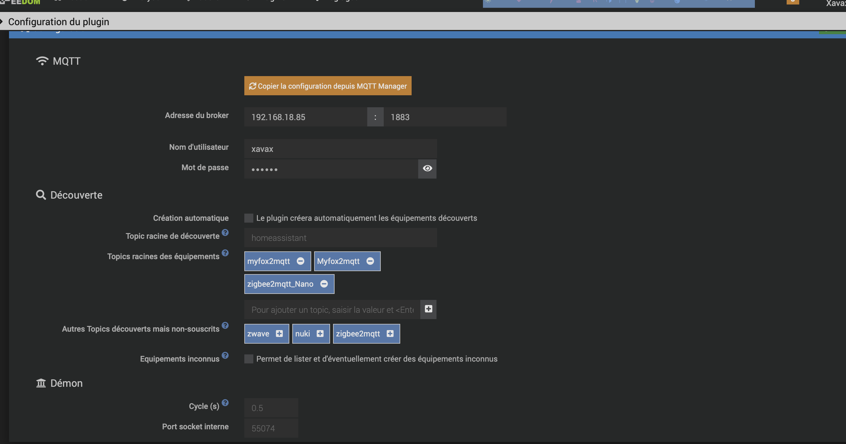

Déjà je constate que dans la configuration smhub zigbee2mqtt tu persistes à activer HA Settings et Experimental Events,
alors que ce n’est pas supporté dans le plugin mqttdiscovery.
Ce qui a déjà été dit dans le sujet que tu cites en référence : « Configuration du broker du smhub nano » :
akenad :slight_smile:

[2026-09-28 09:07:06][INFO] Nouvelle découverte, résumé des configuations:
[2026-09-28 09:07:06][INFO] - Total reçues:              765

tu as configuré un cycle particulier sur le démon? (config plugin)
quelle valeur as-tu?
j’ai laissé par défaut

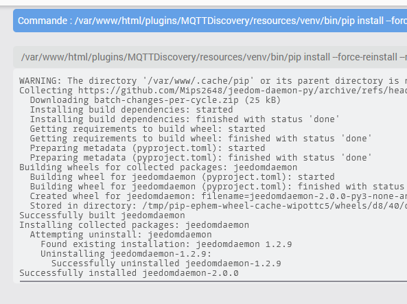

root@jeedom:~# /var/www/html/plugins/MQTTDiscovery/resources/venv/bin/pip install --force-reinstall --no-deps "https://github.com/Mips2648/jeedom-daemon-py/archive/refs/heads/feat/batch-changes-per-cycle.zip"
Collecting https://github.com/Mips2648/jeedom-daemon-py/archive/refs/heads/feat/batch-changes-per-cycle.zip
  Downloading batch-changes-per-cycle.zip
     - 25.1 kB 427.5 kB/s 0:00:00
  Installing build dependencies ... done
  Getting requirements to build wheel ... done
  Preparing metadata (pyproject.toml) ... done
Building wheels for collected packages: jeedomdaemon
  Building wheel for jeedomdaemon (pyproject.toml) ... done
  Created wheel for jeedomdaemon: filename=jeedomdaemon-2.0.0-py3-none-any.whl size=12953 sha256=bc8087dd5c015cd00832db707d61f24ef080f076af9e746436d9b4b2b174c255
  Stored in directory: /root/.cache/pip/wheels/b7/2f/e0/7da93fa24c07ba58d7a76e5eaa950c9243ece32a1bd2fd1221
Successfully built jeedomdaemon
Installing collected packages: jeedomdaemon
  Attempting uninstall: jeedomdaemon
    Found existing installation: jeedomdaemon 1.2.9
    Uninstalling jeedomdaemon-1.2.9:
      Successfully uninstalled jeedomdaemon-1.2.9
Successfully installed jeedomdaemon-2.0.0
root@jeedom:~#
