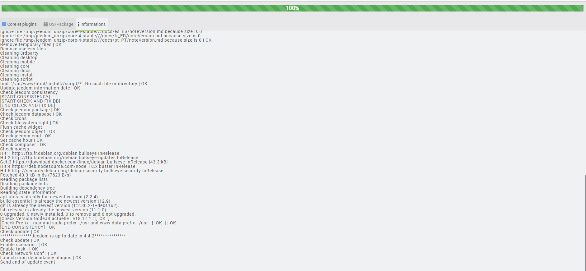

Mise à jour 4.4.2 de Beta vers Stable bloqué à 100%
Je viens de faire la mise à jour du core 4.4.2 sauf je passe de Beta vers Stable, il reste bloqué sur 100%
Les logs ci-dessous :
[START UPDATE]
****Update from 4.4.2 (2024-04-04 10:11:05)****
Parameters : {"preUpdate":"0","backup::before":"1","core":"1","force":"0","plugins":"0","update::reapply":""}
Send begin of update event | OK
Check rights | OK
[START BACKUP]
***************Start of Jeedom backup at 2024-04-04 10:11:11***************
Send begin backup event | OK
Checking files rights | OK
Checking  database | OK
Backing up database | OK
Cache persistence: | OK
Creating archive | OK
Cleaning old backup | OK
Limiting backup size to 500 Mb
Delete: /var/www/html/core/php///backup/backup-Prod-4.4.2-2024-04-01-07h15.tar.gz
Delete: /var/www/html/core/php///backup/backup-Prod-4.4.2-2024-04-02-07h15.tar.gz | OK
Backup name: /var/www/html/core/php///backup/backup-Prod-4.4.2-2024-04-04-10h11.tar.gz
Send end backup event | OK
Backup operation duration: 37s
***************Jeedom backup end***************
[END BACKUP SUCCESS]
Download url : https://github.com/jeedom/core/archive/V4-stable.zip
Download in progress--2024-04-04 10:11:48--  https://github.com/jeedom/core/archive/V4-stable.zip
Resolving github.com (github.com) 140.82.121.3, 64:ff9b::8c52:7903
Connecting to github.com (github.com)|140.82.121.3|:443 connected.
HTTP request sent, awaiting response
302 Found
Location: https://codeload.github.com/jeedom/core/zip/refs/heads/V4-stable [following]
--2024-04-04 10:11:48--  https://codeload.github.com/jeedom/core/zip/refs/heads/V4-stable
Resolving codeload.github.com (codeload.github.com) 140.82.121.10, 64:ff9b::8c52:790a
Connecting to codeload.github.com (codeload.github.com)|140.82.121.10|:443 connected.
HTTP request sent, awaiting response 200 | OK
Length: 87539897 (83M) [application/zip]
Saving to: '/tmp/jeedom/install/jeedom_update.zip'
0K        3% 10.4M 8s
3072K        7% 15.6M 6s
6144K .
10% 13.0M 6s
9216K       14% 20.9M 5s
12288K       17% 21.7M 5s
15360K       21% 25.0M 4s
18432K       25% 20.5M 4s
21504K       28% 18.5M 4s
24576K       32% 20.6M 3s
27648K .
35% 19.0M 3s
30720K       39% 22.5M 3s
33792K       43% 21.5M 3s
36864K       46% 19.7M 2s
39936K       50% 20.0M 2s
43008K       53% 15.6M 2s
46080K
57% 18.7M 2s
49152K       61% 22.4M 2s
52224K       64% 21.9M 2s
55296K       68% 24.8M 1s
58368K       71% 24.6M 1s
61440K       75% 21.7M 1s
64512K       79% 21.0M 1s
67584K       82% 18.7M 1s
70656K
86% 14.0M 1s
73728K       89% 22.9M 0s
76800K       93% 24.7M 0s
79872K       97% 20.4M 0s
82944K               100% 20.0M=4.3s
2024-04-04 10:11:53 (19.2 MB/s) - '/tmp/jeedom/install/jeedom_update.zip' saved [87539897/87539897] | OK
Cleaning folders | OK
Create temporary folder | OK
Unzip in progress | OK
Clean temporary files (tmp) | OK
Disable all task. | OK
Disable all scenario | OK
Moving files
Ignore file /tmp/jeedom_unzip/core-4-stable///docs/de_DE/noteVersion.md because size is 0
Ignore file /tmp/jeedom_unzip/core-4-stable///docs/en_US/noteVersion.md because size is 0
Ignore file /tmp/jeedom_unzip/core-4-stable///docs/es_ES/noteVersion.md because size is 0
Ignore file /tmp/jeedom_unzip/core-4-stable///docs/fr_FR/noteVersion.md because size is 0
Ignore file /tmp/jeedom_unzip/core-4-stable///docs/pt_PT/noteVersion.md because size is 0 | OK
Remove temporary files | OK
Remove useless files
Cleaning 3rdparty
Cleaning desktop
Cleaning mobile
Cleaning core
Cleaning docs
Cleaning install
Cleaning script
find: '/var/www/html/install//script/*': No such file or directory | OK
Update jeedom information date | OK
Check jeedom consistency
[START CONSISTENCY]
[START CHECK AND FIX DB]
[END CHECK AND FIX DB]
Check jeedom package | OK
Check jeedom database | OK
Check crons
Check filesystem right | OK
Flush cache widget
Check jeedom object | OK
Check jeedom cmd | OK
Set cache hour | OK
Check composer | OK
Check nodejs
Hit:1 http://ftp.fr.debian.org/debian bullseye InRelease
Hit:2 http://ftp.fr.debian.org/debian bullseye-updates InRelease
Get:3 https://download.docker.com/linux/debian bullseye InRelease [43.3 kB]
Hit:4 https://deb.nodesource.com/node_18.x buster InRelease
Hit:5 http://security.debian.org/debian-security bullseye-security InRelease
Fetched 43.3 kB in 6s (7623 B/s)
Reading package lists
Building dependency tree
Reading state information
apt-utils is already the newest version (2.2.4).
git is already the newest version (1:2.30.2-1+deb11u2).
lsb-release is already the newest version (11.1.0).
0 upgraded, 0 newly installed, 0 to remove and 6 not upgraded.
[Check Version NodeJS actuelle : v18.17.1 : [  OK  ]
[Check Prefix : /usr and sudo prefix : /usr and www-data prefix : /usr : [  OK  ] | OK
[END CONSISTENCY] | OK
Check update | OK
***************Jeedom is up to date in 4.4.2***************
Check update | OK
Enable scenario : | OK
Enable task : | OK
Check Network Conf : | OK
Launch cron dependancy plugins | OK
Send end of update event
Savoir si c’est normal qui reste bloqué sur Send end of update event
Merci d’avance
Cordialement

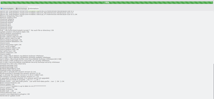

As tu un scénario sur un evenement de fin de mise a jour ?
Non pas du tout ou peux être un sans le savoir :slight_smile: , on peux le voir à un endroit ?
Bon j’ai relancé la maj, c’est passé …
