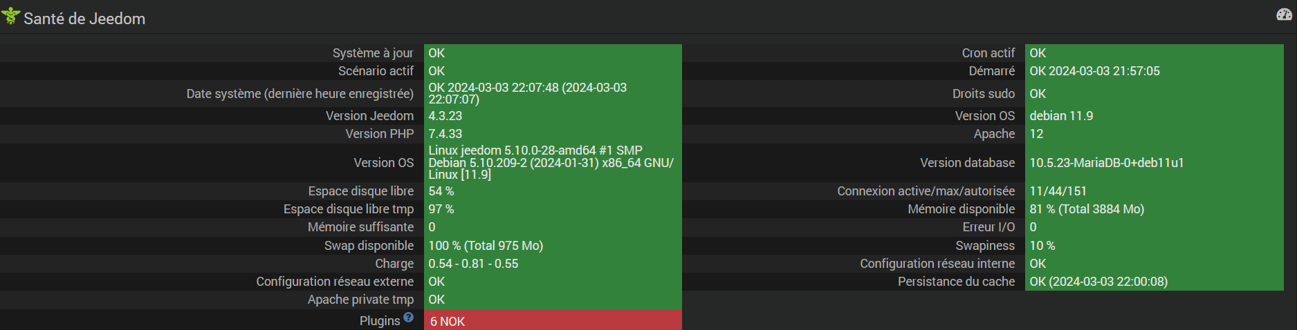

Mise à jour 4.3-> 4.4 impossible
J’ai demandé une mise à jour du core en 4.4 à partir de la dernière 4.3 en mode forcé. Les beta sont autorisés dans mon profil.
logs obtenus :
[START UPDATE]
****Update from 4.3.23 (2024-03-03 21:54:05)****
Parameters : {"preUpdate":"0","backup::before":"0","plugins":"0","core":"1","force":"1","update::reapply":"4.4.2"}
Send begin of update event | OK
Check rights | OK
Disable all task.
kill: (21456): No such process
kill: (21449): No such process | OK
Disable all scenario | OK
Update system into : 4.4.2 | OK
Check jeedom consistency
[START CONSISTENCY]
[START CHECK AND FIX DB]
[END CHECK AND FIX DB]
Check jeedom package | OK
Check jeedom database | OK
Check crons
Check filesystem right | OK
Flush cache widget
Check jeedom object | OK
Check jeedom cmd | OK
Set cache hour | OK
Check nodejs
Hit:1 http://ftp.fr.debian.org/debian bullseye InRelease
Hit:2 http://ftp.fr.debian.org/debian bullseye-updates InRelease
Hit:3 https://deb.nodesource.com/node_18.x nodistro InRelease
Reading package lists
Building dependency tree
Reading state information
apt-utils is already the newest version (2.2.4).
git is already the newest version (1:2.30.2-1+deb11u2).
lsb-release is already the newest version (11.1.0).
0 upgraded, 0 newly installed, 0 to remove and 1 not upgraded.
[Check Version NodeJS actuelle : v18.19.0 : [  OK  ]
[Check Prefix : /usr and sudo prefix : /usr and www-data prefix : /usr : [  OK  ] | OK
[END CONSISTENCY] | OK
Check update | OK
***************Jeedom is up to date in 4.3.23***************
Check update | OK
Enable scenario : | OK
Enable task : | OK
Check Network Conf : | OK
Launch cron dependancy plugins | OK
Send end of update event | OK
Update duration : 15s
[END UPDATE SUCCESS]
Pas de téléchargement
toujours en 4.3 malgré un reboot.
