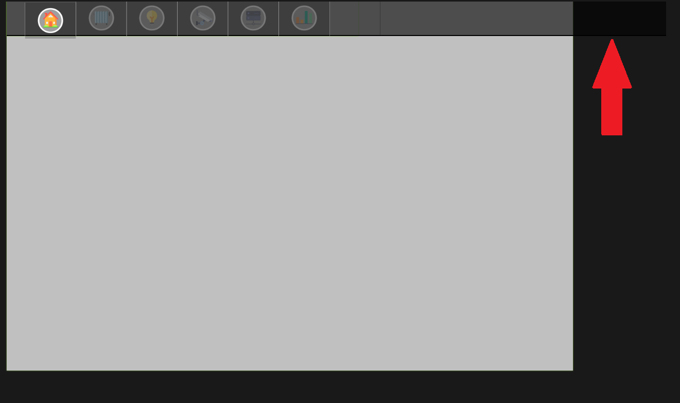

Menu trop long
Salut, je voudrais réduire le menu (voir photo) pour que ça rentre dans mon design
Quelqu’un aurait la solution? Je sais pas trop quelle ligne modifier … merci
Joyeux Noël au passage :grinning:
Texte/html:
    <a onClick="planHeader_id=33; displayPlan();"><li class="monmenu"><div class="selected"><img src="montheme/images/MAISON2.png" height=50px width=50px></div></br></li></a>
    <a onClick="planHeader_id=14; displayPlan();"><li class="monmenu"><div class="imagette"><img src="montheme/images/RADIATEUR.png" height=50px width=50px></div></br></li></a>
    <a onClick="planHeader_id=32; displayPlan();"><li class="monmenu"><div class="imagette"><img src="montheme/images/LUMIERE.png" height=50px width=50px></div></br></li></a>
    <a onClick="planHeader_id=1; displayPlan();"><li class="monmenu"><div class="imagette"><img src="montheme/images/CAMERA.png" height=50px width=50px></div></br></li></a>
    <a onClick="planHeader_id=1; displayPlan();"><li class="monmenu"><div class="imagette"><img src="montheme/images/LAN.png" height=50px width=50px></div></br></li></a>
    <a onClick="planHeader_id=1; displayPlan();"><li class="monmenu" ><div class="imagette"><img src="montheme/images/GRAPH.png" height=50px width=50px></div></br></li></a>

Mon theme CSS:
div.menu_top
width:1281px;
height:70px;
background-color:rgba(0,0,0,0.6);
border-bottom:2px solid rgba(0,0,0,1);
ul.monmenu
width:1281px;
margin: 0 auto;
ul.monmenu ul.monmenu_sep
list-style-type:none;
color:rgba(255,255,255,0.8);
font-family:Roboto;
font-size: 16px;
font-weight: normal;
li.monmenu
display:inline-block;
width: 100px;
margin-left: -5px;
text-align: center;
height: 70px;
padding-top: 10px;
border-left: 1px solid rgba(255,255,255,0.3);
border-right: 1px solid rgba(255,255,255,0.3);
background-color: rgba(0,0,0,0.2);
div.imagette
text-align: center;
margin-bottom: 5px;
opacity: 0.3 ;
li.monmenu:hover{
background-color: rgba(255,255,255,0.2);
li.selected{
width: 100px;
margin-left: -5px;
text-align: center;
height: 70px;
padding-top: 10px;
li.monmenu_sep
width: 100px;
margin-left: -5px;
text-align: center;
height: 70px;
padding-top: 10px;
border-right: 1px solid rgba(0,0,0,0.3);
div.bouton{
opacity: 1;
div.bouton:hover
opacity: 0.5;
Tu peux réduire la valeur des width:1281px; et penses bien à rafraichir la page avec ctrl+F5 sinon tu ne verras jamais les changements
