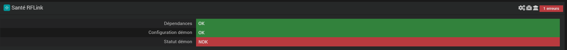

HS suite a la mise a jour de zigbeelinker
Hier j’ai mis a jour le plugin zigbeelinker et le service zigbee2mqtt.
Depuis le demaon RFlink est mort.
voici les logs après réinstallation du plugin :

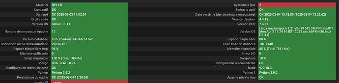

Page santé jeedom svp.

npm error  2551 |     , signature);
npm error       |                ^
npm error In file included from /root/.cache/node-gyp/20.18.3/include/node/v8-function.h:15,
npm error                  from /root/.cache/node-gyp/20.18.3/include/node/v8.h:33,
npm error                  from /root/.cache/node-gyp/20.18.3/include/node/node.h:73,
npm error                  from ../../../nan/nan.h:58,
npm error                  from ../src/./serialport.h:13,
npm error                  from ../src/serialport.cpp:1:
npm error /root/.cache/node-gyp/20.18.3/include/node/v8-template.h:809:8: note: candidate: 'void v8::ObjectTemplate::SetAccessor(v8::Local<v8::String>, v8::AccessorGetterCallback, v8::AccessorSetterCallback, v8::Local<v8::Value>, v8::AccessControl, v8::PropertyAttribute, v8::SideEffectType, v8::SideEffectType)'
npm error   809 |   void SetAccessor(
npm error       |        ^~~~~~~~~~~
npm error /root/.cache/node-gyp/20.18.3/include/node/v8-template.h:814:22: note:   no known conversion for argument 7 from 'Nan::imp::Sig' {aka 'int'} to 'v8::SideEffectType'
npm error   814 |       SideEffectType getter_side_effect_type = SideEffectType::kHasSideEffect,
npm error       |       ~~~~~~~~~~~~~~~^~~~~~~~~~~~~~~~~~~~~~~~~~~~~~~~~~~~~~~~~~~~~~~~~~~~~~~~
npm error /root/.cache/node-gyp/20.18.3/include/node/v8-template.h:816:8: note: candidate: 'void v8::ObjectTemplate::SetAccessor(v8::Local<v8::Name>, v8::AccessorNameGetterCallback, v8::AccessorNameSetterCallback, v8::Local<v8::Value>, v8::AccessControl, v8::PropertyAttribute, v8::SideEffectType, v8::SideEffectType)'
npm error   816 |   void SetAccessor(
npm error /root/.cache/node-gyp/20.18.3/include/node/v8-template.h:821:22: note:   no known conversion for argument 7 from 'Nan::imp::Sig' {aka 'int'} to 'v8::SideEffectType'
npm error   821 |       SideEffectType getter_side_effect_type = SideEffectType::kHasSideEffect,
npm error ../src/serialport.cpp: In function 'Nan::NAN_METHOD_RETURN_TYPE Open(Nan::NAN_METHOD_ARGS_TYPE)':
npm error ../src/serialport.cpp:78:51: warning: cast between incompatible function types from 'void (*)(uv_work_t*)' {aka 'void (*)(uv_work_s*)'} to 'uv_after_work_cb' {aka 'void (*)(uv_work_s*, int)'} [-Wcast-function-type]
npm error    78 |   uv_queue_work(uv_default_loop(), req, EIO_Open, (uv_after_work_cb)EIO_AfterOpen);
npm error       |                                                   ^~~~~~~~~~~~~~~~~~~~~~~~~~~~~~~
npm error ../src/serialport.cpp: In function 'Nan::NAN_METHOD_RETURN_TYPE Update(Nan::NAN_METHOD_ARGS_TYPE)':
npm error ../src/serialport.cpp:135:53: warning: cast between incompatible function types from 'void (*)(uv_work_t*)' {aka 'void (*)(uv_work_s*)'} to 'uv_after_work_cb' {aka 'void (*)(uv_work_s*, int)'} [-Wcast-function-type]
npm error   135 |   uv_queue_work(uv_default_loop(), req, EIO_Update, (uv_after_work_cb)EIO_AfterUpdate);
npm error       |                                                     ^~~~~~~~~~~~~~~~~~~~~~~~~~~~~~~~~
npm error ../src/serialport.cpp: In function 'Nan::NAN_METHOD_RETURN_TYPE Close(Nan::NAN_METHOD_ARGS_TYPE)':
npm error ../src/serialport.cpp:175:52: warning: cast between incompatible function types from 'void (*)(uv_work_t*)' {aka 'void (*)(uv_work_s*)'} to 'uv_after_work_cb' {aka 'void (*)(uv_work_s*, int)'} [-Wcast-function-type]
npm error   175 |   uv_queue_work(uv_default_loop(), req, EIO_Close, (uv_after_work_cb)EIO_AfterClose);
npm error ../src/serialport.cpp: In function 'Nan::NAN_METHOD_RETURN_TYPE Flush(Nan::NAN_METHOD_ARGS_TYPE)':
npm error ../src/serialport.cpp:215:52: warning: cast between incompatible function types from 'void (*)(uv_work_t*)' {aka 'void (*)(uv_work_s*)'} to 'uv_after_work_cb' {aka 'void (*)(uv_work_s*, int)'} [-Wcast-function-type]
npm error   215 |   uv_queue_work(uv_default_loop(), req, EIO_Flush, (uv_after_work_cb)EIO_AfterFlush);
npm error ../src/serialport.cpp: In function 'Nan::NAN_METHOD_RETURN_TYPE Set(Nan::NAN_METHOD_ARGS_TYPE)':
npm error ../src/serialport.cpp:271:50: warning: cast between incompatible function types from 'void (*)(uv_work_t*)' {aka 'void (*)(uv_work_s*)'} to 'uv_after_work_cb' {aka 'void (*)(uv_work_s*, int)'} [-Wcast-function-type]
npm error   271 |   uv_queue_work(uv_default_loop(), req, EIO_Set, (uv_after_work_cb)EIO_AfterSet);
npm error ../src/serialport.cpp: In function 'Nan::NAN_METHOD_RETURN_TYPE Get(Nan::NAN_METHOD_ARGS_TYPE)':
npm error ../src/serialport.cpp:316:50: warning: cast between incompatible function types from 'void (*)(uv_work_t*)' {aka 'void (*)(uv_work_s*)'} to 'uv_after_work_cb' {aka 'void (*)(uv_work_s*, int)'} [-Wcast-function-type]
npm error   316 |   uv_queue_work(uv_default_loop(), req, EIO_Get, (uv_after_work_cb)EIO_AfterGet);
npm error ../src/serialport.cpp: In function 'Nan::NAN_METHOD_RETURN_TYPE GetBaudRate(Nan::NAN_METHOD_ARGS_TYPE)':
npm error ../src/serialport.cpp:366:58: warning: cast between incompatible function types from 'void (*)(uv_work_t*)' {aka 'void (*)(uv_work_s*)'} to 'uv_after_work_cb' {aka 'void (*)(uv_work_s*, int)'} [-Wcast-function-type]
npm error   366 |   uv_queue_work(uv_default_loop(), req, EIO_GetBaudRate, (uv_after_work_cb)EIO_AfterGetBaudRate);
npm error       |                                                          ^~~~~~~~~~~~~~~~~~~~~~~~~~~~~~~~~~~~~~
npm error ../src/serialport.cpp: In function 'Nan::NAN_METHOD_RETURN_TYPE Drain(Nan::NAN_METHOD_ARGS_TYPE)':
npm error ../src/serialport.cpp:412:52: warning: cast between incompatible function types from 'void (*)(uv_work_t*)' {aka 'void (*)(uv_work_s*)'} to 'uv_after_work_cb' {aka 'void (*)(uv_work_s*, int)'} [-Wcast-function-type]
npm error   412 |   uv_queue_work(uv_default_loop(), req, EIO_Drain, (uv_after_work_cb)EIO_AfterDrain);
npm error ../src/serialport.cpp: At global scope:
npm error ../src/serialport.cpp:433:28: warning: unnecessary parentheses in declaration of 'ToParityEnum' [-Wparentheses]
npm error   433 | SerialPortParity NAN_INLINE(ToParityEnum(const v8::Local<v8::String>& v8str)) {
npm error       |                            ^
npm error ../src/serialport.cpp:452:30: warning: unnecessary parentheses in declaration of 'ToStopBitEnum' [-Wparentheses]
npm error   452 | SerialPortStopBits NAN_INLINE(ToStopBitEnum(double stopBits)) {
npm error       |                              ^
npm error In file included from ../../../nan/nan.h:58,
npm error /root/.cache/node-gyp/20.18.3/include/node/node.h:1226:7: warning: cast between incompatible function types from 'void (*)(Nan::ADDON_REGISTER_FUNCTION_ARGS_TYPE)' {aka 'void (*)(v8::Local<v8::Object>)'} to 'node::addon_register_func' {aka 'void (*)(v8::Local<v8::Object>, v8::Local<v8::Value>, void*)'} [-Wcast-function-type]
npm error  1226 |       (node::addon_register_func) (regfunc),                          \
npm error /root/.cache/node-gyp/20.18.3/include/node/node.h:1260:3: note: in expansion of macro 'NODE_MODULE_X'
npm error  1260 |   NODE_MODULE_X(modname, regfunc, NULL, 0)  // NOLINT (readability/null_usage)
npm error ../src/serialport.cpp:486:1: note: in expansion of macro 'NODE_MODULE'
npm error   486 | NODE_MODULE(serialport, init);
npm error make: *** [bindings.target.mk:109: Release/obj.target/bindings/src/serialport.o] Error 1
npm error gyp ERR! build error
npm error gyp ERR! stack Error: `make` failed with exit code: 2
npm error gyp ERR! stack at ChildProcess.<anonymous> (/usr/lib/node_modules/npm/node_modules/node-gyp/lib/build.js:216:23)
npm error gyp ERR! System Linux 6.1.21-v8+
npm error gyp ERR! command "/usr/bin/node" "/usr/lib/node_modules/npm/node_modules/node-gyp/bin/node-gyp.js" "rebuild"
npm error gyp ERR! cwd /var/www/html/plugins/rflink/resources/node_modules/@serialport/bindings
npm error gyp ERR! node -v v20.18.3
npm error gyp ERR! node-gyp -v v11.0.0
npm error gyp ERR! not ok
npm error A complete log of this run can be found in: /root/.npm/_logs/2025-03-04T13_27_35_854Z-debug-0.log
+ sudo chown -R www-data:www-data node_modules.backup nodejs.sh package-lock.json package.json rflink rflink.js update_firmware.sh
+ echo 6
+ php /var/www/html/core/class/../php/jeecli.php plugin dependancy_end rflink
+ echo 7
+ rm /tmp/jeedom_install_in_progress_rflink

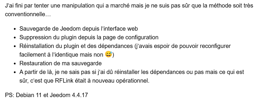

Applique cette solution pour voir.
Je suis passé en version beta, mais j’ai toujours un pb de dependance:
+ touch /tmp/jeedom_install_in_progress_rflink
+ echo 1
+ echo 2
Hit:1 http://raspbian.raspberrypi.org/raspbian bullseye InRelease
Hit:2 http://archive.raspberrypi.org/debian bullseye InRelease
Get:3 https://download.docker.com/linux/debian bullseye InRelease [43.3 kB]
Hit:4 https://deb.nodesource.com/node_20.x nodistro InRelease
Hit:5 https://packagecloud.io/ookla/speedtest-cli/debian bullseye InRelease
Fetched 43.3 kB in 4s (10.8 kB/s)
Reading package lists...
Building dependency tree...
Reading state information...
apt-utils is already the newest version (2.2.4).
git is already the newest version (1:2.30.2-1+deb11u4).
lsb-release is already the newest version (11.1.0+rpi1).
The following packages were automatically installed and are no longer required:
libpython2-dev libpython2-stdlib libpython2.7 libpython2.7-dev
libpython2.7-minimal libpython2.7-stdlib python2 python2-dev python2-minimal
python2.7 python2.7-dev python2.7-minimal
Use 'sudo apt autoremove' to remove them.
0 upgraded, 0 newly installed, 0 to remove and 97 not upgraded.
[Check Version NodeJS actuelle : v20.18.3 : [  OK  ]
+ echo 3
Get:2 https://download.docker.com/linux/debian bullseye InRelease [43.3 kB]
Hit:3 http://archive.raspberrypi.org/debian bullseye InRelease
Fetched 43.3 kB in 3s (15.1 kB/s)
+ echo 4
+ sudo chmod +x /var/www/html/core/class/../../resources/install_composer.sh
+ sudo /var/www/html/core/class/../../resources/install_composer.sh
Begin installation of composer
--2025-03-04 14:42:58--  https://getcomposer.org/installer
Resolving getcomposer.org (getcomposer.org)... 2001:41d0:302:1100::8:104f, 54.36.53.46
Connecting to getcomposer.org (getcomposer.org)|2001:41d0:302:1100::8:104f|:443... connected.
HTTP request sent, awaiting response... 200 OK
Length: 58444 (57K) [application/octet-stream]
Saving to: 'composer-setup.php'
0K .......... .......... .......... .......... .......... 87% 3.88M 0s
50K .......                                               100% 4.18M=0.01s
2025-03-04 14:42:58 (3.91 MB/s) - 'composer-setup.php' saved [58444/58444]
All settings correct for using Composer
Downloading...
Composer (version 2.8.6) successfully installed to: /var/www/html/core/ajax/composer.phar
Use it: php composer.phar
End installation of composer
+ echo 5
+ cd /var/www/html/core/class/../../plugins/rflink/resources
+ rm -rf node_modules
+ sudo NODE_OPTIONS=--dns-result-order=ipv4first npm install
npm warn deprecated har-validator@5.1.5: this library is no longer supported
npm warn deprecated uuid@3.4.0: Please upgrade  to version 7 or higher.  Older versions may use Math.random() in certain circumstances, which is known to be problematic.  See https://v8.dev/blog/math-random for details.
npm warn deprecated request@2.88.2: request has been deprecated, see https://github.com/request/request/issues/3142
npm error code 1
npm error path /var/www/html/plugins/rflink/resources/node_modules/@serialport/bindings
npm error command failed
npm error command sh -c prebuild-install --tag-prefix @serialport/bindings@ || node-gyp rebuild
npm error make: Entering directory '/var/www/html/plugins/rflink/resources/node_modules/@serialport/bindings/build'
npm error   CXX(target) Release/obj.target/bindings/src/serialport.o
npm error make: Leaving directory '/var/www/html/plugins/rflink/resources/node_modules/@serialport/bindings/build'
npm error prebuild-install WARN install No prebuilt binaries found (target=20.18.3 runtime=node arch=arm libc= platform=linux)
npm error gyp info it worked if it ends with ok
npm error gyp info using node-gyp@11.0.0
npm error gyp info using node@20.18.3 | linux | arm
npm error gyp info find Python using Python version 3.9.2 found at "/usr/bin/python3"
npm error gyp info spawn /usr/bin/python3
npm error gyp info spawn args [
npm error gyp info spawn args '/usr/lib/node_modules/npm/node_modules/node-gyp/gyp/gyp_main.py',
npm error gyp info spawn args 'binding.gyp',
npm error gyp info spawn args '-f',
npm error gyp info spawn args 'make',
npm error gyp info spawn args '-I',
npm error gyp info spawn args '/var/www/html/plugins/rflink/resources/node_modules/@serialport/bindings/build/config.gypi',
npm error gyp info spawn args '/usr/lib/node_modules/npm/node_modules/node-gyp/addon.gypi',
npm error gyp info spawn args '/root/.cache/node-gyp/20.18.3/include/node/common.gypi',
npm error gyp info spawn args '-Dlibrary=shared_library',
npm error gyp info spawn args '-Dvisibility=default',
npm error gyp info spawn args '-Dnode_root_dir=/root/.cache/node-gyp/20.18.3',
npm error gyp info spawn args '-Dnode_gyp_dir=/usr/lib/node_modules/npm/node_modules/node-gyp',
npm error gyp info spawn args '-Dnode_lib_file=/root/.cache/node-gyp/20.18.3/<(target_arch)/node.lib',
npm error gyp info spawn args '-Dmodule_root_dir=/var/www/html/plugins/rflink/resources/node_modules/@serialport/bindings',
npm error gyp info spawn args '-Dnode_engine=v8',
npm error gyp info spawn args '--depth=.',
npm error gyp info spawn args '--no-parallel',
npm error gyp info spawn args '--generator-output',
npm error gyp info spawn args 'build',
npm error gyp info spawn args '-Goutput_dir=.'
npm error gyp info spawn args ]
npm error gyp info spawn make
npm error gyp info spawn args [ 'BUILDTYPE=Release', '-C', 'build' ]
npm error In file included from ../../../nan/nan.h:178,
npm error ../../../nan/nan_callbacks.h:55:23: error: 'AccessorSignature' is not a member of 'v8'
npm error    55 | typedef v8::Local<v8::AccessorSignature> Sig;
npm error ../../../nan/nan_callbacks.h:55:40: error: template argument 1 is invalid
npm error       |                                        ^
npm error In file included from ../src/./serialport.h:13,
npm error ../../../nan/nan.h: In function 'void Nan::SetAccessor(v8::Local<v8::ObjectTemplate>, v8::Local<v8::String>, Nan::GetterCallback, Nan::SetterCallback, v8::Local<v8::Value>, v8::AccessControl, v8::PropertyAttribute, Nan::imp::Sig)':
npm error ../../../nan/nan.h:2551:16: error: no matching function for call to 'v8::ObjectTemplate::SetAccessor(v8::Local<v8::String>&, void (*&)(v8::Local<v8::Name>, const v8::PropertyCallbackInfo<v8::Value>&), void (*&)(v8::Local<v8::Name>, v8::Local<v8::Value>, const v8::PropertyCallbackInfo<void>&), v8::Local<v8::Object>&, v8::AccessControl&, v8::PropertyAttribute&, Nan::imp::Sig&)'
npm error       |                ^
npm error       |                            ^
npm error       |                              ^
npm error A complete log of this run can be found in: /root/.npm/_logs/2025-03-04T13_43_00_423Z-debug-0.log
+ echo 6
+ echo 7

C’est très étrange que la version python2.7 ait été installée sur une debian 11, vous avez installé python2.7 pour une raison particulière ?
A+
Michel
Bonne question. Je sais plus.
Bonjour Maxmont,
J’ai eu un pb similaire ce jour,
as tu appliqué cette procédure :
Par contre dans ma cas cela me sert à piloter mes volets as tu perdu la config de tes équipements et donc tout reconfigurer
Merci.
Oui j ai appliqué la procédure a la lettre.
Le restore du backup permet de récupérer les équipements.
