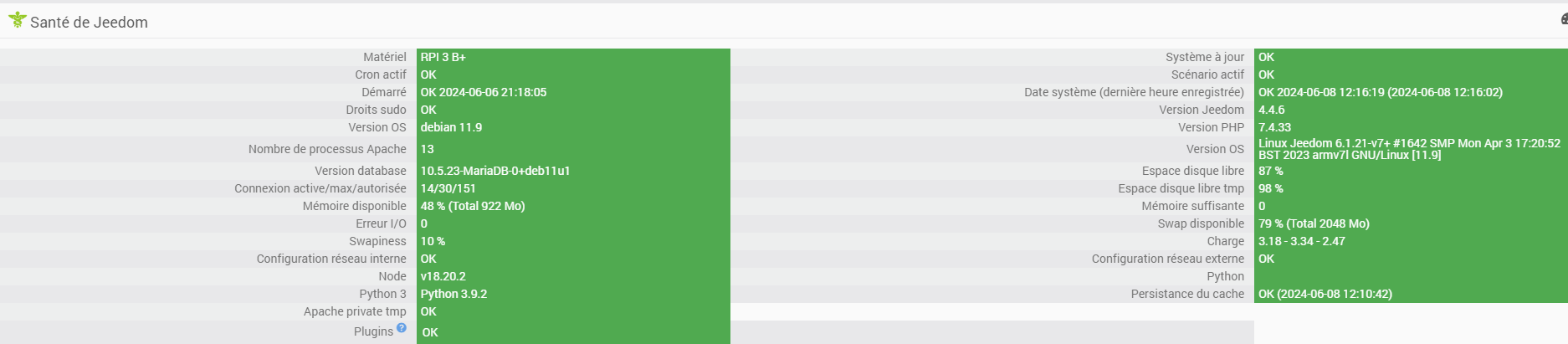

Voici ma page santé :

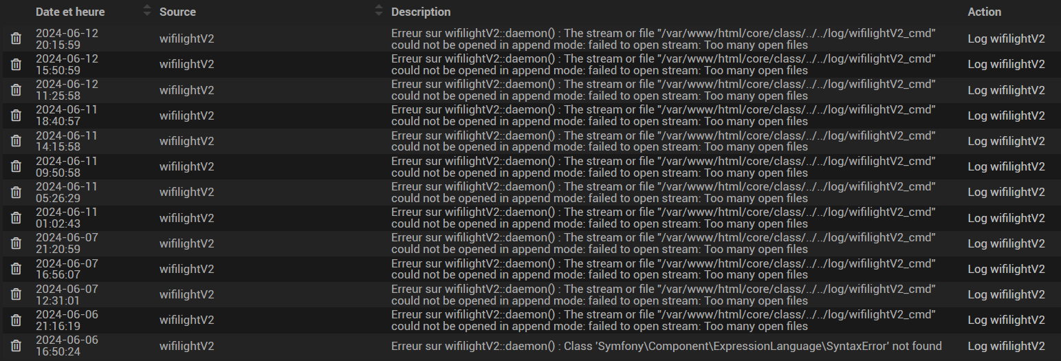

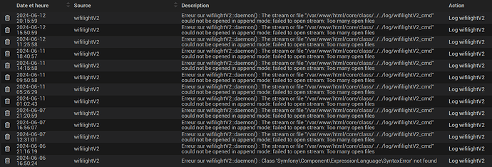

Voici les message affiché

0495|[2024-06-11 01:02:43] ERROR  : Erreur sur wifilightV2::daemon() : The stream or file "/var/www/html/core/class/../../log/wifilightV2_cmd" could not be opened in append mode: failed to open stream: Too many open files
0496|[2024-06-11 05:26:29] ERROR  : Erreur sur wifilightV2::daemon() : The stream or file "/var/www/html/core/class/../../log/wifilightV2_cmd" could not be opened in append mode: failed to open stream: Too many open files
0497|[2024-06-11 09:50:58] ERROR  : Erreur sur wifilightV2::daemon() : The stream or file "/var/www/html/core/class/../../log/wifilightV2_cmd" could not be opened in append mode: failed to open stream: Too many open files
0498|[2024-06-11 14:15:58] ERROR  : Erreur sur wifilightV2::daemon() : The stream or file "/var/www/html/core/class/../../log/wifilightV2_cmd" could not be opened in append mode: failed to open stream: Too many open files
0499|[2024-06-11 18:40:57] ERROR  : Erreur sur wifilightV2::daemon() : The stream or file "/var/www/html/core/class/../../log/wifilightV2_cmd" could not be opened in append mode: failed to open stream: Too many open files
0500|[2024-06-12 11:25:58] ERROR  : Erreur sur wifilightV2::daemon() : The stream or file "/var/www/html/core/class/../../log/wifilightV2_cmd" could not be opened in append mode: failed to open stream: Too many open files
0501|[2024-06-12 15:50:59] ERROR  : Erreur sur wifilightV2::daemon() : The stream or file "/var/www/html/core/class/../../log/wifilightV2_cmd" could not be opened in append mode: failed to open stream: Too many open files
0502|[2024-06-12 20:15:59] ERROR  : Erreur sur wifilightV2::daemon() : The stream or file "/var/www/html/core/class/../../log/wifilightV2_cmd" could not be opened in append mode: failed to open stream: Too many open files
