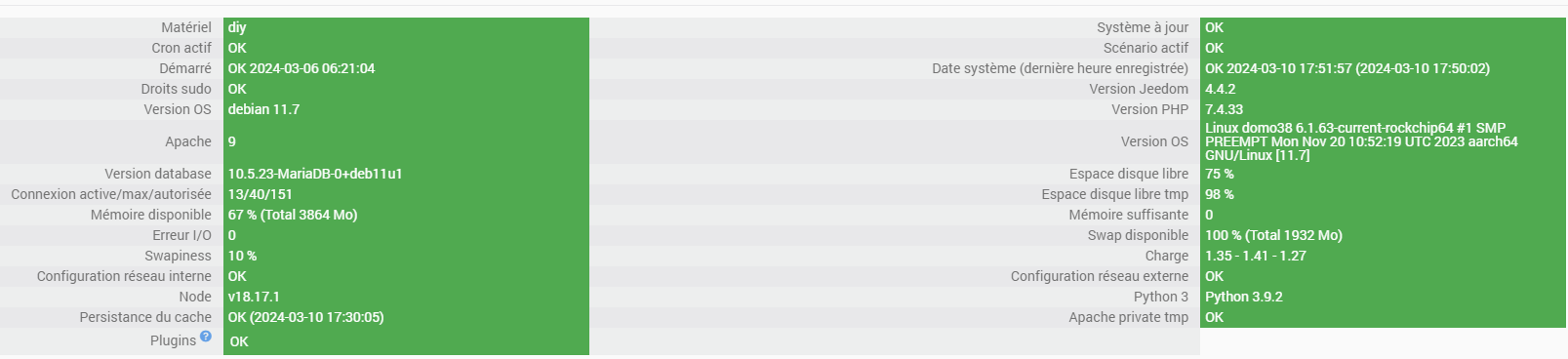

ma page santé

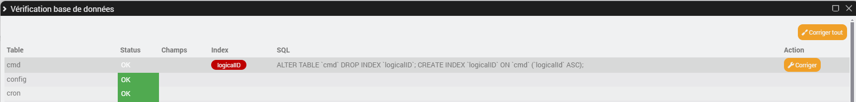

si je fais un verif complete :
[START CONSISTENCY]
[START CHECK AND FIX DB]
Fix : ALTER TABLE `cmd` DROP INDEX `logicalID`;
Fix :
CREATE INDEX `logicalID` ON `cmd` (`logicalId` ASC)[END CHECK AND FIX DB]
Check jeedom package...**OK**
Check jeedom database...
Fix :
CREATE INDEX `logicalID` ON `cmd` (`logicalId` ASC)**OK** Check crons...
Check filesystem right...**OK**
Flush cache widget...
une idée ?
