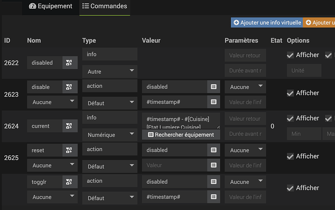

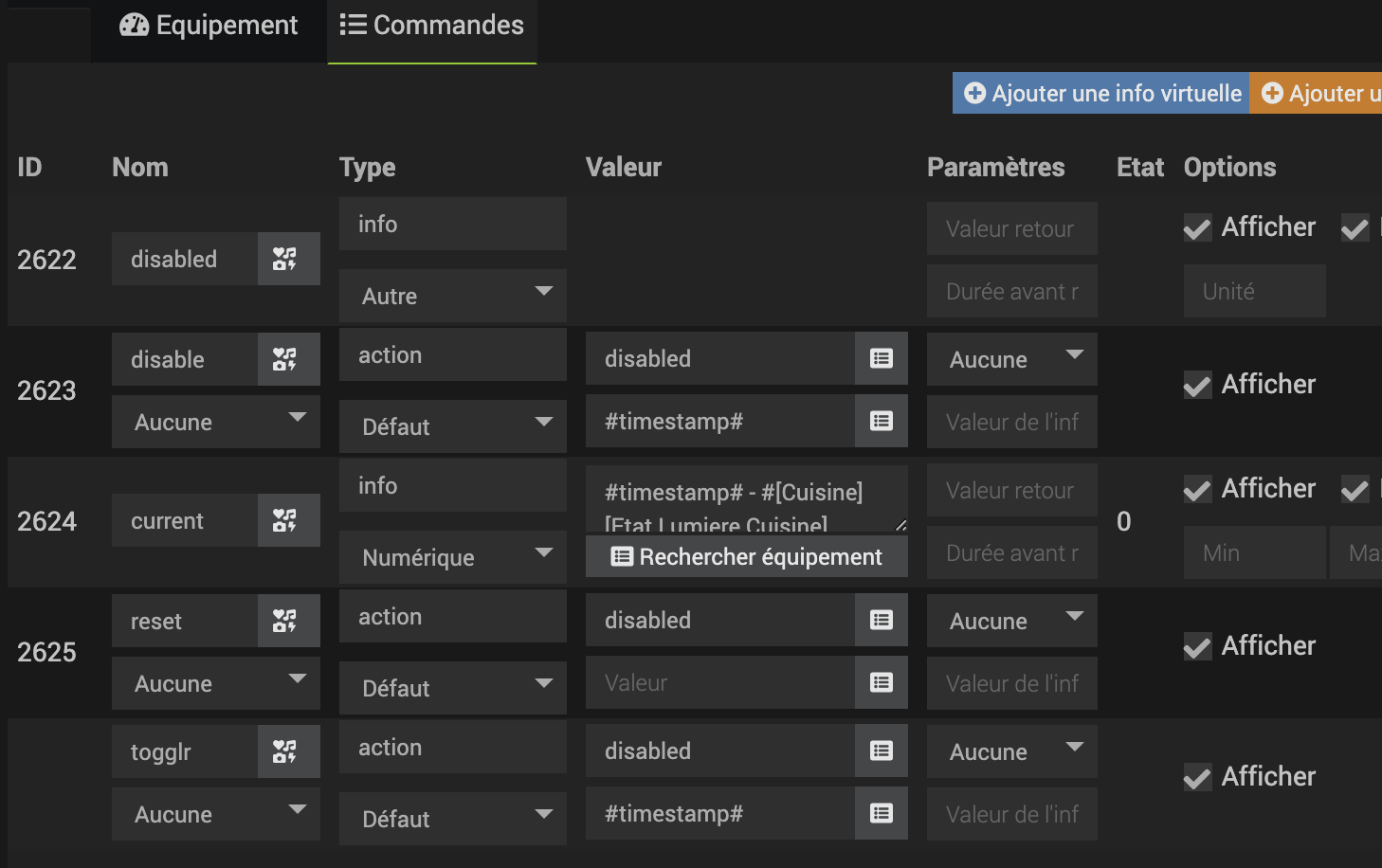

je le constate également sur la page d’édition d’un virtuel lorsque j’essaye d’ajouter une commande action ; la commande n’a pas d’ID

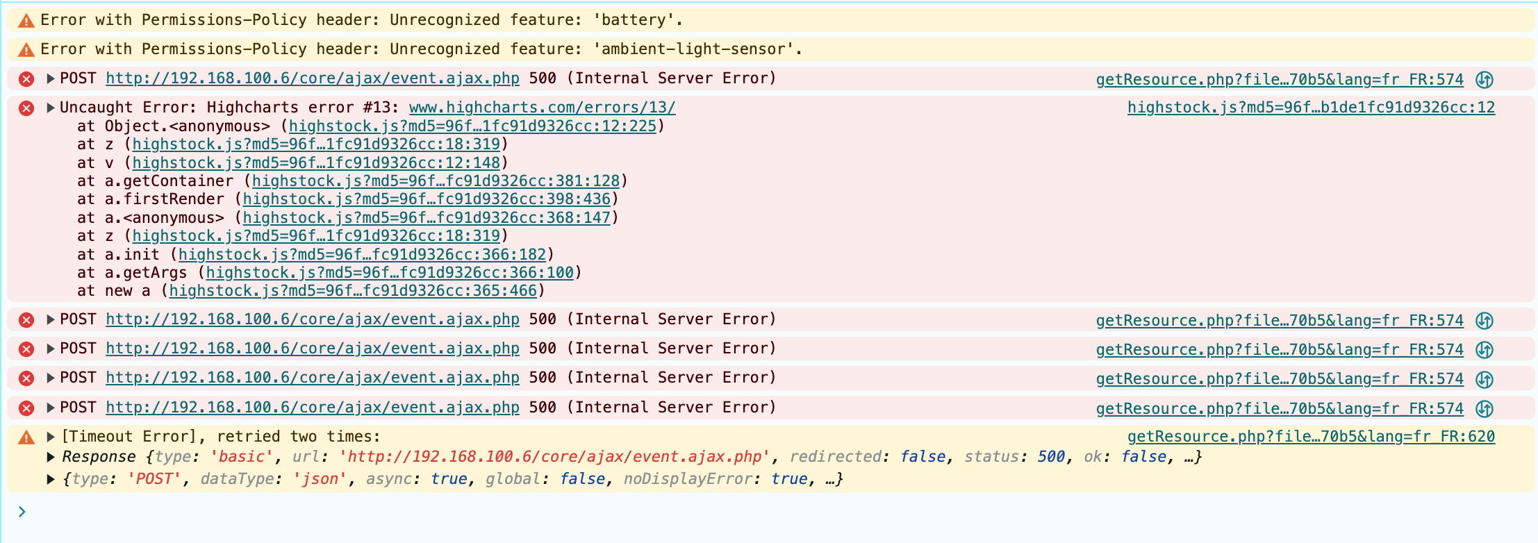

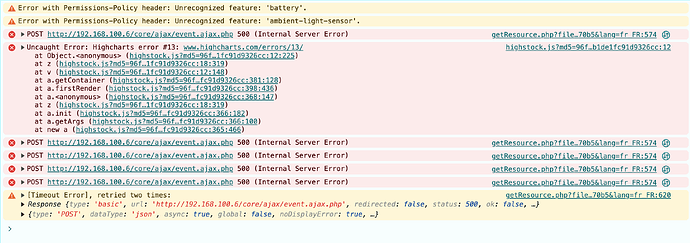

voici une copie de l’erreur dans la console

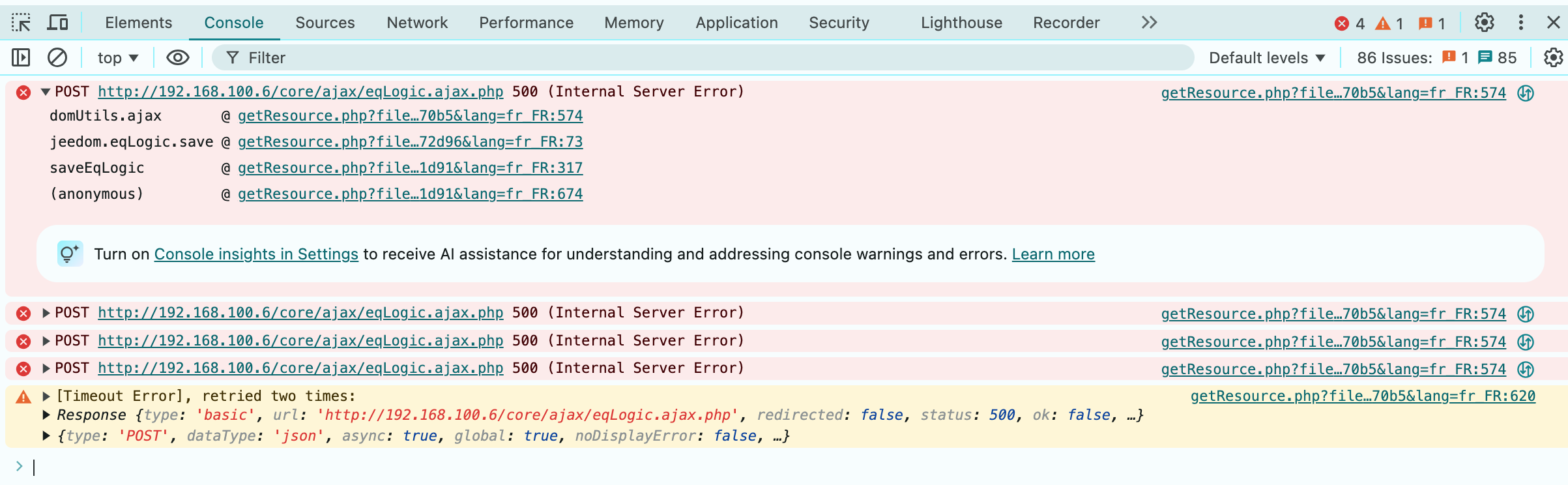

quand j’essaye de « sauver » mon virtuel
0000|[Thu Jan 02 23:20:25.935250 2025] [php:error] [pid 2328792:tid 2328792] [client 192.168.100.2:54376] PHP Fatal error:  Uncaught TypeError: Unsupported operand types: int - string in /var/www/html/vendor/symfony/expression-language/Node/BinaryNode.php:149\nStack trace:\n#0 /var/www/html/vendor/symfony/expression-language/ExpressionLanguage.php(67): Symfony\\Component\\ExpressionLanguage\\Node\\BinaryNode->evaluate()\n#1 /var/www/html/core/php/utils.inc.php(1014): Symfony\\Component\\ExpressionLanguage\\ExpressionLanguage->evaluate()\n#2 /var/www/html/core/class/jeedom.class.php(1416): evaluate()\n#3 /var/www/html/plugins/virtual/core/class/virtual.class.php(549): jeedom::evaluateExpression()\n#4 /var/www/html/plugins/virtual/core/class/virtual.class.php(535): virtualCmd->execute()\n#5 /var/www/html/core/class/DB.class.php(250): virtualCmd->postSave()\n#6 /var/www/html/core/class/cmd.class.php(1102): DB::save()\n#7 /var/www/html/core/ajax/eqLogic.ajax.php(522): cmd->save()\n#8 {main}\n  thrown in /var/www/html/vendor/symfony/expression-language/Node/BinaryNode.php on line 149
0001|[Thu Jan 02 23:20:26.069285 2025] [php:error] [pid 2154417:tid 2154417] [client 192.168.100.2:55025] PHP Fatal error:  Uncaught TypeError: Unsupported operand types: int - string in /var/www/html/vendor/symfony/expression-language/Node/BinaryNode.php:149\nStack trace:\n#0 /var/www/html/vendor/symfony/expression-language/ExpressionLanguage.php(67): Symfony\\Component\\ExpressionLanguage\\Node\\BinaryNode->evaluate()\n#1 /var/www/html/core/php/utils.inc.php(1014): Symfony\\Component\\ExpressionLanguage\\ExpressionLanguage->evaluate()\n#2 /var/www/html/core/class/jeedom.class.php(1416): evaluate()\n#3 /var/www/html/plugins/virtual/core/class/virtual.class.php(549): jeedom::evaluateExpression()\n#4 /var/www/html/plugins/virtual/core/class/virtual.class.php(535): virtualCmd->execute()\n#5 /var/www/html/core/class/DB.class.php(250): virtualCmd->postSave()\n#6 /var/www/html/core/class/cmd.class.php(1102): DB::save()\n#7 /var/www/html/core/ajax/eqLogic.ajax.php(522): cmd->save()\n#8 {main}\n  thrown in /var/www/html/vendor/symfony/expression-language/Node/BinaryNode.php on line 149
0002|[Thu Jan 02 23:20:26.209703 2025] [php:error] [pid 2326733:tid 2326733] [client 192.168.100.2:55026] PHP Fatal error:  Uncaught TypeError: Unsupported operand types: int - string in /var/www/html/vendor/symfony/expression-language/Node/BinaryNode.php:149\nStack trace:\n#0 /var/www/html/vendor/symfony/expression-language/ExpressionLanguage.php(67): Symfony\\Component\\ExpressionLanguage\\Node\\BinaryNode->evaluate()\n#1 /var/www/html/core/php/utils.inc.php(1014): Symfony\\Component\\ExpressionLanguage\\ExpressionLanguage->evaluate()\n#2 /var/www/html/core/class/jeedom.class.php(1416): evaluate()\n#3 /var/www/html/plugins/virtual/core/class/virtual.class.php(549): jeedom::evaluateExpression()\n#4 /var/www/html/plugins/virtual/core/class/virtual.class.php(535): virtualCmd->execute()\n#5 /var/www/html/core/class/DB.class.php(250): virtualCmd->postSave()\n#6 /var/www/html/core/class/cmd.class.php(1102): DB::save()\n#7 /var/www/html/core/ajax/eqLogic.ajax.php(522): cmd->save()\n#8 {main}\n  thrown in /var/www/html/vendor/symfony/expression-language/Node/BinaryNode.php on line 149
0003|[Thu Jan 02 23:20:26.366103 2025] [php:error] [pid 2332393:tid 2332393] [client 192.168.100.2:55027] PHP Fatal error:  Uncaught TypeError: Unsupported operand types: int - string in /var/www/html/vendor/symfony/expression-language/Node/BinaryNode.php:149\nStack trace:\n#0 /var/www/html/vendor/symfony/expression-language/ExpressionLanguage.php(67): Symfony\\Component\\ExpressionLanguage\\Node\\BinaryNode->evaluate()\n#1 /var/www/html/core/php/utils.inc.php(1014): Symfony\\Component\\ExpressionLanguage\\ExpressionLanguage->evaluate()\n#2 /var/www/html/core/class/jeedom.class.php(1416): evaluate()\n#3 /var/www/html/plugins/virtual/core/class/virtual.class.php(549): jeedom::evaluateExpression()\n#4 /var/www/html/plugins/virtual/core/class/virtual.class.php(535): virtualCmd->execute()\n#5 /var/www/html/core/class/DB.class.php(250): virtualCmd->postSave()\n#6 /var/www/html/core/class/cmd.class.php(1102): DB::save()\n#7 /var/www/html/core/ajax/eqLogic.ajax.php(522): cmd->save()\n#8 {main}\n  thrown in /var/www/html/vendor/symfony/expression-language/Node/BinaryNode.php on line 149

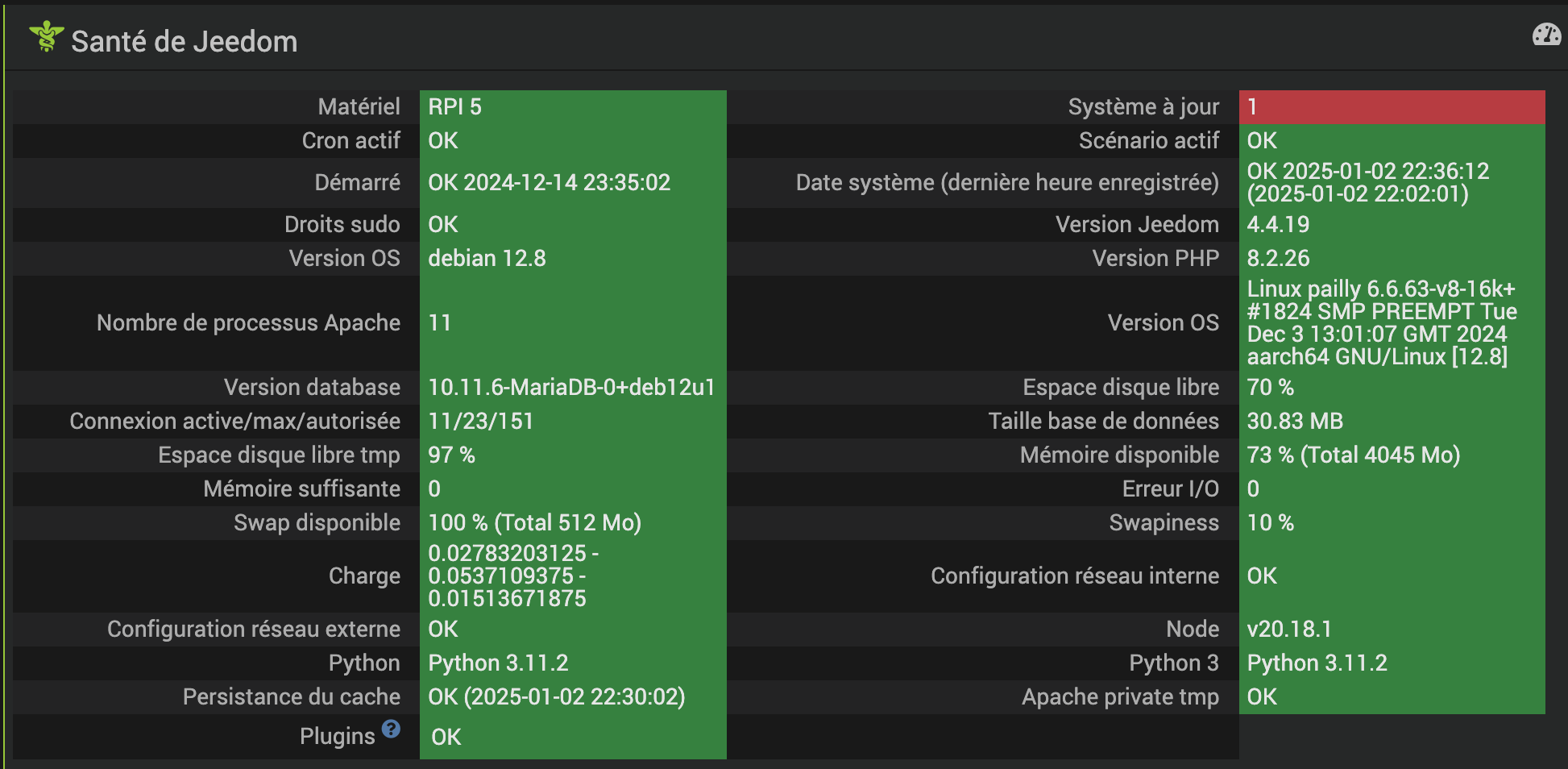

Voici ma page santé:
Je ne sais quelle log fournir pour debug le sujet, ou quelle action entreprendre ;
Je précise que cela ne semble pas être un problème du navigateur: tout fonctionne correctement sur une autre installation de jeedom
Sur debian 12 il faut tester avec la 4.5 pour être sur que ce n’est pas déjà fixé.
