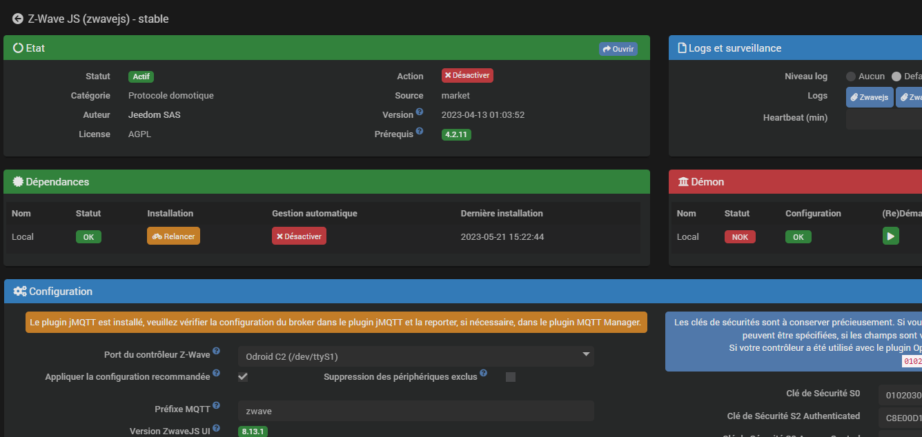

Par contre pour ZWAVEJS je n’y arrive pas.
Je suis sur SMART en 4.3.17
Dernier version du ZWAVE
Les log des dependance de ZWAVEJS :

Setting up node-cliui (4.1.0-1) ...
Setting up node-rimraf (2.6.2-1) ...
Setting up node-stream-each (1.2.2-2) ...
Setting up node-yargs (10.0.3-2) ...
Setting up node-mississippi (3.0.0-1) ...
Setting up node-read-package-json (2.0.13-1) ...
Setting up node-copy-concurrently (1.0.5-4) ...
Setting up node-move-concurrently (1.0.1-2) ...
Setting up node-fs-vacuum (1.2.10-2) ...
Setting up node-gauge (2.7.4-1) ...
Setting up node-boxen (1.2.2-1) ...
Setting up node-libnpx (10.2.0+repack-1) ...
Setting up node-npmlog (4.1.2-1) ...
Setting up node-cacache (11.3.2-2) ...
Setting up node-gyp (3.8.0-6) ...
Setting up npm (5.8.0+ds6-4+deb10u2) ...
npm WARN npm npm does not support Node.js v10.24.0
npm WARN npm You should probably upgrade to a newer version of node as we
npm WARN npm can't make any promises that npm will work with this version.
npm WARN npm Supported releases of Node.js are the latest release of 4, 6, 7, 8, 9.
npm WARN npm You can find the latest version at https://nodejs.org/
npm WARN npm@9.6.7 had bundled packages that do not match the required version(s). They have been replaced with non-bundled versions.
npm ERR! code EUNSUPPORTEDPROTOCOL
npm ERR! Unsupported URL Type "npm:": npm:string-width@^4.2.0
npm ERR! A complete log of this run can be found in:
npm ERR! /root/.npm/_logs/2023-05-21T09_28_43_478Z-debug.log
[Check Prefix : /usr/local and sudo prefix : /usr/local and www-data prefix : /usr/local : [ OK ]
+ echo 4
+ cd /var/www/html/core/class/../../plugins/mqtt2/resources/mqtt2d
+ rm -rf node_modules
+ sudo npm install
npm WARN read-shrinkwrap This version of npm is compatible with lockfileVersion@1, but package-lock.json was generated for lockfileVersion@2. I'll try to do my best with it!
npm WARN mqtt2@1.0.0 No repository field.
npm WARN mqtt2@1.0.0 No license field.
added 147 packages from 117 contributors in 24.669s
+ chown -R www-data:www-data jeedom mqtt2d.js node_modules package.json package-lock.json
+ echo 5
+ php /var/www/html/core/class/../php/jeecli.php plugin dependancy_end mqtt2
+ rm /tmp/jeedom_install_in_progress_mqtt2
Et j’utilise jmqtt avec un mosquito local
et les log des dependances :
== 21/05/2023 12:53:07 == Dependencies installation for jMQTT
[ 0% ] : Checking parameters...
== System: Linux Jeedom 3.16.85+ #1 SMP PREEMPT Mon Jul 13 14:40:04 UTC 2020 aarch64 GNU/Linux
== Jeedom version: 4.3.17
== jMQTT version: 2023-04-15
[ 9% ] : Checking parameters : [ OK ]
[ 10% ] : Synchronize the package index...
[ 19% ] : Synchronize the package index : ERROR
[ 20% ] : Install Composer...
[ 29% ] : Install Composer : [ OK ]
[ 30% ] : Install JsonPath-PHP library...
[ 39% ] : Install JsonPath-PHP library : [ OK ]
[ 40% ] : Remove Composer...
[ 49% ] : Remove Composer : [ OK ]
[ 50% ] : Install python3 venv and pip debian packages...
[ 59% ] : Install python3 venv and pip debian packages : [ OK ]
[ 60% ] : Create a python3 Virtual Environment...
[ 69% ] : Create a python3 Virtual Environment : [ OK ]
[ 70% ] : Install required python3 libraries in venv...
[ 99% ] : Install required python3 libraries in venv : [ OK ]
[100% ] : Finished !
== KO == Installation Error
== ANALYSING ERRORS...
== NO KNOWN ERROR DETECTED
== Error in step : Synchronize the package index
== Line 24
== Command `sudo apt-get update' have an issue
== Return code is 100
== Error message :
Hit:1 http://security.debian.org/debian-security buster/updates InRelease
Get:2 http://ftp.uk.debian.org/debian buster InRelease [122 kB]
Get:3 http://ftp.uk.debian.org/debian buster-updates InRelease [56.6 kB]
Ign:4 https://oph.mdrjr.net/meveric all InRelease
Ign:5 https://oph.mdrjr.net/meveric buster InRelease
Err:7 https://oph.mdrjr.net/meveric all Release
Certificate verification failed: The certificate is NOT trusted. The certificate chain uses expired certificate. Could not handshake: Error in the certificate verification. [IP: 216.155.132.189 443]
Err:8 https://oph.mdrjr.net/meveric buster Release
Hit:6 https://packagecloud.io/ookla/speedtest-cli/debian buster InRelease
Reading package lists...
E: The repository 'https://oph.mdrjr.net/meveric all Release' no longer has a Release file.
E: The repository 'https://oph.mdrjr.net/meveric buster Release' no longer has a Release file.
jmqtt semble fonctionner avec mon SPA intex.
Sur mon emc 8giga je n’avais aucun probleme, et la je n’y arrive plus trop
Je n’ai pas trouvé la reponse sur le forum avec « error: cannot find module ‹ worker_threads › »
Merci d’avance,
