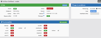

Informations Jeedom
Core : 4.5 (master)
DNS Jeedom : non
Plugin : fail2ban
Version : 2025-08-11 01:13:26 (stable)
