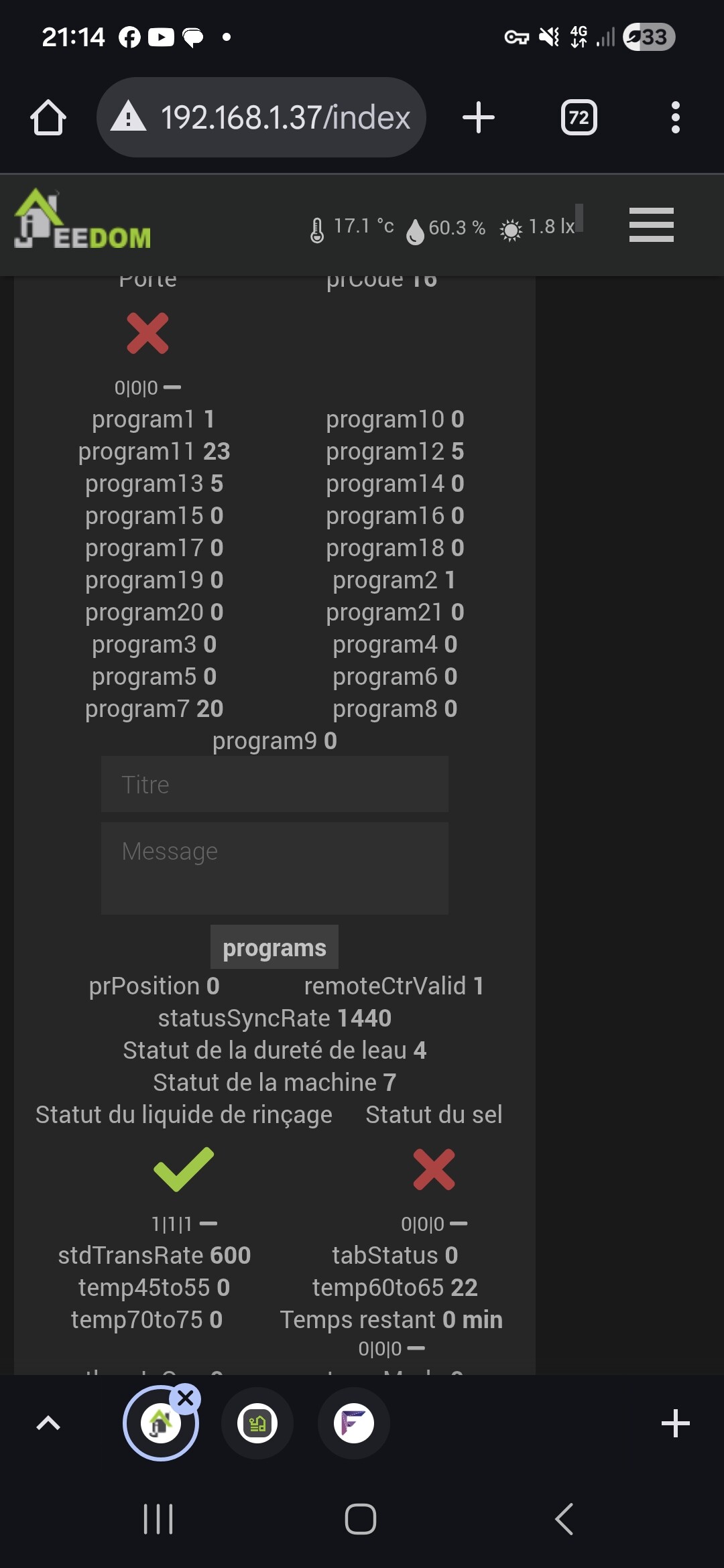

En action je n’ai que ce bloc message
Pour le test j’ai écrit program11 en message

Ok, merci.
je vois un soucis d’authentification à AWS IoT.
Je pousse un correctif.
Mise à jour effectué mais toujours aucune action lancé sur le lave vaisselle. J’ai noté « program7 » (qui semble reconnu si j’ai bien compris le log)
[2025-11-21 22:36:07] DEBUG  : PayloadArr AVANT traitement: {"apikey":"1Qjum4kRJiI7m6AgzDolGzm57Gvrt3KUhq2sukrSiTlWdMmC7WtJwrEetgZ6Q3od","macAddress":"3c-84-27-5b-5a-9c","action":"programs","value":"program7"}
[2025-11-21 22:36:07] DEBUG  : logicalCmd: programs
[2025-11-21 22:36:07] DEBUG  : isSettingsCommand: false
[2025-11-21 22:36:07] DEBUG  : command extrait: programs
[2025-11-21 22:36:07] DEBUG  : Parcours payloadArr: key=apikey, value="1Qjum4kRJiI7m6AgzDolGzm57Gvrt3KUhq2sukrSiTlWdMmC7WtJwrEetgZ6Q3od"
[2025-11-21 22:36:07] DEBUG  : Parcours payloadArr: key=macAddress, value="3c-84-27-5b-5a-9c"
[2025-11-21 22:36:07] DEBUG  : Parcours payloadArr: key=action, value="programs"
[2025-11-21 22:36:07] DEBUG  : Parcours payloadArr: key=value, value="program7"
[2025-11-21 22:36:07] DEBUG  : Normal: ajout de parameters[value] = "program7"
[2025-11-21 22:36:07] DEBUG  : Parameters FINAL: {"value":"program7"}
[2025-11-21 22:36:07] DEBUG  : Restauration de la session existante
[2025-11-21 22:36:07] DEBUG  : Token valide encore 4.9 heures
[2025-11-21 22:36:07] INFO  : Session restaurée (token valide)
[2025-11-21 22:36:07] DEBUG  : sendCommand payload envoyé: {"macAddress":"3c-84-27-5b-5a-9c","timestamp":"2025-11-21T21:36:07.000Z","commandName":"programs","transactionId":"3c-84-27-5b-5a-9c_2025-11-21T21:36:07.000Z","parameters":{"value":"program7"},"device":{"mobileId":"C0C6275A-7C10-1D5B-B579-9C1826426347","mobileOs":"android","osVersion":"13","appVersion":"2.22.6","deviceModel":"Jeedom"},"attributes":{"channel":"mobileApp","origin":"standardProgram"},"ancillaryParameters":{},"applianceOptions":{}}
[2025-11-21 22:36:08] DEBUG  : sendCommand réponse reçue: {"payload":{"resultCode":"0"},"authInfo":[]}
[2025-11-21 22:36:08] INFO  : Commande programs envoyée sur 3c-84-27-5b-5a-9c
[2025-11-21 22:36:08] INFO  : Commande programs envoyée avec succès: {"value":"program7"}
[2025-11-21 22:36:08] DEBUG  : Action executed: programs
J’aurais besoin de voir plus de log : à partir de « Début mise à jour API »
Bonjour, ceci te convient ?

Merci.
Les champs des commandes sont vides :
    "commands": {
        "settings": [],
        "programs": []
C’est par ces champs que les commandes action sont créées.
Donc aucune commande action créées dans jeedom semble normal.
