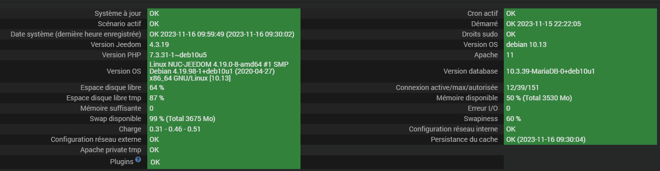

Vous ne donnez pas d’informations sur votre installation,. La.page santé jeedom est un minimum pour ce type de demande.
Désolé, je complète :

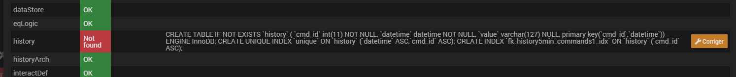

En complément d’information, un check me dit bien que la table n’existe pas, mais le bouton de correction ne fait rien :
Reboot nécessaire après la re-création de la table. Forcément, toutes les données ont été perdues mais je n’ai plus d’erreur.

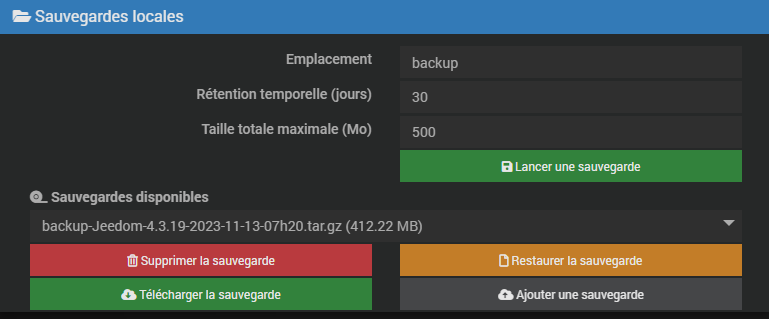

Et en rechargeant une sauvegarde antérieure au problème.

[    2.761235] usb 1-2: new full-speed USB device number 3 using xhci_hcd
[    2.924353] usb 1-2: New USB device found, idVendor=0403, idProduct=6001, bcdDevice= 6.00
[    2.924356] usb 1-2: New USB device strings: Mfr=1, Product=2, SerialNumber=3
[    2.924358] usb 1-2: Product: RFXtrx433
[    2.924359] usb 1-2: Manufacturer: RFXCOM
[    2.924360] usb 1-2: SerialNumber: A11I9GAC
[    2.930039] EXT4-fs (sda2): mounted filesystem with ordered data mode. Opts: (null)
[    3.057035] usb 1-3: new full-speed USB device number 4 using xhci_hcd
[    3.140156] systemd[1]: Inserted module 'autofs4'
[    3.206653] usb 1-3: New USB device found, idVendor=1a86, idProduct=7523, bcdDevice= 2.64
[    3.206656] usb 1-3: New USB device strings: Mfr=0, Product=2, SerialNumber=0
[    3.206658] usb 1-3: Product: USB Serial
[    3.230080] systemd[1]: systemd 241 running in system mode. (+PAM +AUDIT +SELINUX +IMA +APPARMOR +SMACK +SYSVINIT +UTMP +LIBCRYPTSETUP +GCRYPT +GNUTLS +ACL +XZ +LZ4 +SECCOMP +BLKID +ELFUTILS +KMOD -IDN2 +IDN -PCRE2 default-hierarchy=hybrid)
[    3.249442] systemd[1]: Detected architecture x86-64.
[    3.254917] systemd[1]: Set hostname to .
[    3.255586] Lockdown: /dev/mem,kmem,port is restricted; see https://wiki.debian.org/SecureBoot
[    3.260792] Lockdown: BPF is restricted; see https://wiki.debian.org/SecureBoot
[    3.337041] usb 1-4: new full-speed USB device number 5 using xhci_hcd
[    3.358264] systemd[1]: File /lib/systemd/system/systemd-journald.service:12 configures an IP firewall (IPAddressDeny=any), but the local system does not support BPF/cgroup based firewalling.
[    3.358269] systemd[1]: Proceeding WITHOUT firewalling in effect! (This warning is only shown for the first loaded unit using IP firewalling.)
[    3.412648] systemd[1]: /lib/systemd/system/fail2ban.service:12: PIDFile= references path below legacy directory /var/run/, updating /var/run/fail2ban/fail2ban.pid \xe2\x86\x92 /run/fail2ban/fail2ban.pid; please update the unit file accordingly.
[    3.432852] systemd[1]: Listening on Journal Socket (/dev/log).
[    3.433129] systemd[1]: Listening on Journal Socket.
[    3.435314] systemd[1]: Mounting Kernel Debug File System...
[    3.436472] systemd[1]: Mounting Huge Pages File System...
[    3.497543] EXT4-fs (sda2): re-mounted. Opts: errors=remount-ro
[    3.634234] systemd-journald[256]: Received request to flush runtime journal from PID 1
[    3.821529] ite_cir: Auto-detected model: ITE8708 CIR transceiver
[    3.821530] ite_cir: Using model: ITE8708 CIR transceiver
[    3.821531] ite_cir: TX-capable: 1
[    3.821532] ite_cir: Sample period (ns): 8680
[    3.821532] ite_cir: TX carrier frequency (Hz): 38000
[    3.821533] ite_cir: TX duty cycle (%): 33
[    3.821534] ite_cir: RX low carrier frequency (Hz): 0
[    3.821534] ite_cir: RX high carrier frequency (Hz): 0
[    3.869347] Registered IR keymap rc-rc6-mce
[    3.936622] sd 0:0:0:0: Attached scsi generic sg0 type 0
[    3.936934] EFI Variables Facility v0.08 2004-May-17
[    3.937104] input: PC Speaker as /devices/platform/pcspkr/input/input7
[    3.938335] IR RC6 protocol handler initialized
[    3.943644] RAPL PMU: API unit is 2^-32 Joules, 4 fixed counters, 655360 ms ovfl timer
[    3.943645] RAPL PMU: hw unit of domain pp0-core 2^-14 Joules
[    3.943646] RAPL PMU: hw unit of domain package 2^-14 Joules
[    3.943646] RAPL PMU: hw unit of domain dram 2^-14 Joules
[    3.943647] RAPL PMU: hw unit of domain pp1-gpu 2^-14 Joules
[    3.965039] rc rc0: ITE8708 CIR transceiver as /devices/virtual/rc/rc0
[    3.965080] input: ITE8708 CIR transceiver as /devices/virtual/rc/rc0/input6
[    3.965205] rc rc0: lirc_dev: driver ite-cir registered at minor = 0, raw IR receiver, raw IR transmitter
[    3.978473] ite_cir: driver has been successfully loaded
[    4.148819] pstore: Using compression: deflate
[    4.148838] pstore: Registered efi as persistent store backend
[    4.165457] snd_hda_intel 0000:00:0e.0: bound 0000:00:02.0 (ops i915_audio_component_bind_ops [i915])
[    4.239932] Intel(R) Wireless WiFi driver for Linux
[    4.239934] Copyright(c) 2003- 2015 Intel Corporation
[    4.239986] iwlwifi 0000:00:0c.0: enabling device (0000 -> 0002)
[    4.271106] snd_hda_codec_realtek hdaudioC0D0: autoconfig for ALC233: line_outs=1 (0x1b/0x0/0x0/0x0/0x0) type:line
[    4.271109] snd_hda_codec_realtek hdaudioC0D0:    speaker_outs=0 (0x0/0x0/0x0/0x0/0x0)
[    4.271110] snd_hda_codec_realtek hdaudioC0D0:    hp_outs=1 (0x21/0x0/0x0/0x0/0x0)
[    4.271111] snd_hda_codec_realtek hdaudioC0D0:    mono: mono_out=0x0
[    4.271112] snd_hda_codec_realtek hdaudioC0D0:    dig-out=0x1e/0x0
[    4.271113] snd_hda_codec_realtek hdaudioC0D0:    inputs:
[    4.271115] snd_hda_codec_realtek hdaudioC0D0:      Mic=0x19
[    4.271116] snd_hda_codec_realtek hdaudioC0D0:      Internal Mic=0x12
[    4.291422] iwlwifi 0000:00:0c.0: firmware: direct-loading firmware iwlwifi-9000-pu-b0-jf-b0-38.ucode
[    4.292310] iwlwifi 0000:00:0c.0: loaded firmware version 38.755cfdd8.0 op_mode iwlmvm
[    4.330797] input: HDA Digital PCBeep as /devices/pci0000:00/0000:00:0e.0/sound/card0/input8
[    4.332742] input: HDA Intel PCH Mic as /devices/pci0000:00/0000:00:0e.0/sound/card0/input9
[    4.332800] input: HDA Intel PCH Line Out as /devices/pci0000:00/0000:00:0e.0/sound/card0/input10
[    4.332850] input: HDA Intel PCH Front Headphone as /devices/pci0000:00/0000:00:0e.0/sound/card0/input11
[    4.358030] intel_rapl: Found RAPL domain package
[    4.358033] intel_rapl: Found RAPL domain core
[    4.358035] intel_rapl: Found RAPL domain uncore
[    4.358037] intel_rapl: Found RAPL domain dram
[    4.438059] iwlwifi 0000:00:0c.0: Detected Intel(R) Dual Band Wireless AC 9462, REV=0x318
[    4.484363] Adding 3763196k swap on /dev/sda3.  Priority:-2 extents:1 across:3763196k SSFS
[    4.487728] iwlwifi 0000:00:0c.0: base HW address: 98:2c:bc:2f:e9:50
[    4.557323] ieee80211 phy0: Selected rate control algorithm 'iwl-mvm-rs'
[    4.557604] thermal thermal_zone2: failed to read out thermal zone (-61)
[    4.560766] iwlwifi 0000:00:0c.0 wlo2: renamed from wlan0
[    4.630216] audit: type=1400 audit(1700211014.367:2): apparmor="STATUS" operation="profile_load" profile="unconfined" name="libreoffice-xpdfimport" pid=395 comm="apparmor_parser"
[    4.635315] audit: type=1400 audit(1700211014.371:3): apparmor="STATUS" operation="profile_load" profile="unconfined" name="/usr/sbin/ntpd" pid=397 comm="apparmor_parser"
[    4.635905] audit: type=1400 audit(1700211014.371:4): apparmor="STATUS" operation="profile_load" profile="unconfined" name="nvidia_modprobe" pid=396 comm="apparmor_parser"
[    4.635908] audit: type=1400 audit(1700211014.371:5): apparmor="STATUS" operation="profile_load" profile="unconfined" name="nvidia_modprobe//kmod" pid=396 comm="apparmor_parser"
[    4.638552] audit: type=1400 audit(1700211014.375:6): apparmor="STATUS" operation="profile_load" profile="unconfined" name="libreoffice-senddoc" pid=400 comm="apparmor_parser"
[    4.649122] audit: type=1400 audit(1700211014.387:7): apparmor="STATUS" operation="profile_load" profile="unconfined" name="libreoffice-oopslash" pid=401 comm="apparmor_parser"
[    4.656549] audit: type=1400 audit(1700211014.391:8): apparmor="STATUS" operation="profile_load" profile="unconfined" name="/usr/bin/man" pid=403 comm="apparmor_parser"
[    4.656552] audit: type=1400 audit(1700211014.391:9): apparmor="STATUS" operation="profile_load" profile="unconfined" name="man_filter" pid=403 comm="apparmor_parser"
[    4.656554] audit: type=1400 audit(1700211014.391:10): apparmor="STATUS" operation="profile_load" profile="unconfined" name="man_groff" pid=403 comm="apparmor_parser"
[    5.430068] IPv6: ADDRCONF(NETDEV_UP): eno1: link is not ready
[    5.431237] r8169 0000:02:00.0: firmware: direct-loading firmware rtl_nic/rtl8168h-2.fw
[    5.432015] Generic PHY r8169-200:00: attached PHY driver [Generic PHY] (mii_bus:phy_addr=r8169-200:00, irq=IGNORE)
[    5.546523] IPv6: ADDRCONF(NETDEV_UP): eno1: link is not ready
[    5.568749] IPv6: ADDRCONF(NETDEV_UP): wlo2: link is not ready
[    6.719997] fuse init (API version 7.27)
[    8.705022] usb 1-4: unable to read config index 0 descriptor/all
[    8.705029] usb 1-4: can't read configurations, error -110
[    8.833006] usb 1-4: new full-speed USB device number 6 using xhci_hcd
[    8.948466] r8169 0000:02:00.0 eno1: Link is Up - 1Gbps/Full - flow control rx/tx
[    8.948478] IPv6: ADDRCONF(NETDEV_CHANGE): eno1: link becomes ready
[    9.949338] rfkill: input handler disabled
[   14.081005] usb 1-4: unable to read config index 0 descriptor/all
[   14.081012] usb 1-4: can't read configurations, error -110
[   14.081064] usb usb1-port4: attempt power cycle
[   14.733267] usb 1-4: new full-speed USB device number 7 using xhci_hcd
[   14.754584] usb 1-4: New USB device found, idVendor=1cf1, idProduct=0030, bcdDevice= 1.00
[   14.754587] usb 1-4: New USB device strings: Mfr=1, Product=2, SerialNumber=3
[   14.754588] usb 1-4: Product: ConBee II
[   14.754589] usb 1-4: Manufacturer: dresden elektronik ingenieurtechnik GmbH
[   14.754591] usb 1-4: SerialNumber: DE2141202
[   14.881296] usb 1-9: new full-speed USB device number 8 using xhci_hcd
[   15.029914] usb 1-9: New USB device found, idVendor=8087, idProduct=0aaa, bcdDevice= 0.02
[   15.029917] usb 1-9: New USB device strings: Mfr=0, Product=0, SerialNumber=0
[   15.071808] cdc_acm 1-4:1.0: ttyACM0: USB ACM device
[   15.082254] usbcore: registered new interface driver cdc_acm
[   15.082257] cdc_acm: USB Abstract Control Model driver for USB modems and ISDN adapters
[   15.158722] usbcore: registered new interface driver usbserial_generic
[   15.159422] usbserial: USB Serial support registered for generic
[   15.170492] usbcore: registered new interface driver ftdi_sio
[   15.170574] usbserial: USB Serial support registered for FTDI USB Serial Device
[   15.170693] ftdi_sio 1-2:1.0: FTDI USB Serial Device converter detected
[   15.170780] usb 1-2: Detected FT232RL
[   15.172288] usbcore: registered new interface driver ch341
[   15.172298] usbserial: USB Serial support registered for ch341-uart
[   15.172308] ch341 1-3:1.0: ch341-uart converter detected
[   15.187010] usb 1-2: FTDI USB Serial Device converter now attached to ttyUSB0
[   15.198267] alg: No test for fips(ansi_cprng) (fips_ansi_cprng)
[   15.198306] usb 1-3: ch341-uart converter now attached to ttyUSB1
[   15.514111] Bluetooth: Core ver 2.22
[   15.514134] NET: Registered protocol family 31
[   15.514135] Bluetooth: HCI device and connection manager initialized
[   15.514140] Bluetooth: HCI socket layer initialized
[   15.514143] Bluetooth: L2CAP socket layer initialized
[   15.514157] Bluetooth: SCO socket layer initialized
[   15.580032] usbcore: registered new interface driver btusb
[   15.627213] Bluetooth: hci1: Bootloader revision 0.1 build 42 week 52 2015
[   15.628222] Bluetooth: hci1: Device revision is 2
[   15.628223] Bluetooth: hci1: Secure boot is enabled
[   15.628224] Bluetooth: hci1: OTP lock is enabled
[   15.628224] Bluetooth: hci1: API lock is enabled
[   15.628225] Bluetooth: hci1: Debug lock is disabled
[   15.628227] Bluetooth: hci1: Minimum firmware build 1 week 10 2014
[   15.632411] bluetooth hci1: firmware: direct-loading firmware intel/ibt-17-16-1.sfi
[   15.632424] Bluetooth: hci1: Found device firmware: intel/ibt-17-16-1.sfi
[   15.934022] Bluetooth: BNEP (Ethernet Emulation) ver 1.3
[   15.934024] Bluetooth: BNEP filters: protocol multicast
[   15.934031] Bluetooth: BNEP socket layer initialized
[   16.038415] Bluetooth: RFCOMM TTY layer initialized
[   16.038424] Bluetooth: RFCOMM socket layer initialized
[   16.038431] Bluetooth: RFCOMM ver 1.11
[   17.022968] Bluetooth: hci1: Waiting for firmware download to complete
[   17.023194] Bluetooth: hci1: Firmware loaded in 1369852 usecs
[   17.023234] Bluetooth: hci1: Waiting for device to boot
[   17.037196] Bluetooth: hci1: Device booted in 13649 usecs
[   17.037704] bluetooth hci1: firmware: direct-loading firmware intel/ibt-17-16-1.ddc
[   17.037708] Bluetooth: hci1: Found Intel DDC parameters: intel/ibt-17-16-1.ddc
[   17.039203] Bluetooth: hci1: Applying Intel DDC parameters completed
[ 3623.479049] perf: interrupt took too long (2508 > 2500), lowering kernel.perf_event_max_sample_rate to 79500

Encore en complément d’information, je viens de constater que les sauvegardes locales ne tournent plus depuis le 13 novembre 2023.
Si carte mémoire, faire une sauvegarde externe du backup et tester une nouvelle sd ou support…
C’est ce que le log laisse entendre, des soucis de disque ? Pour ma culture personnelle, pouvez vous m’indiquer ce qui vous a mis la puce à l’oreille, SVP ?
Mon Jeedom est installé sur un NUC, le disque étant un SSD
Pour la sauvegarde, c’est certainement du à votre limitation à 500MO alors qu’elle fait déjà 412MO
Passez cette limitation à 1024 pour voir ?
