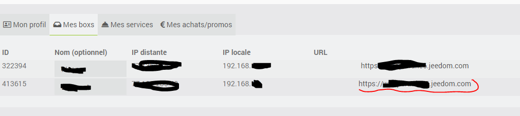

Am in Jeedom v4 with power pack service.
Mobile app does not want to work « externally » → 4g / working in wifi.
Here is a screenshot of what I have in my networks

Hi
Seems there is an issue with the vpn.
Yo should see an url here
Or you only have http
Can you show us the network config of your jeedom ?
Check the openvpn plugin and try to restart it.
Check on the market as well you should see your box like this
